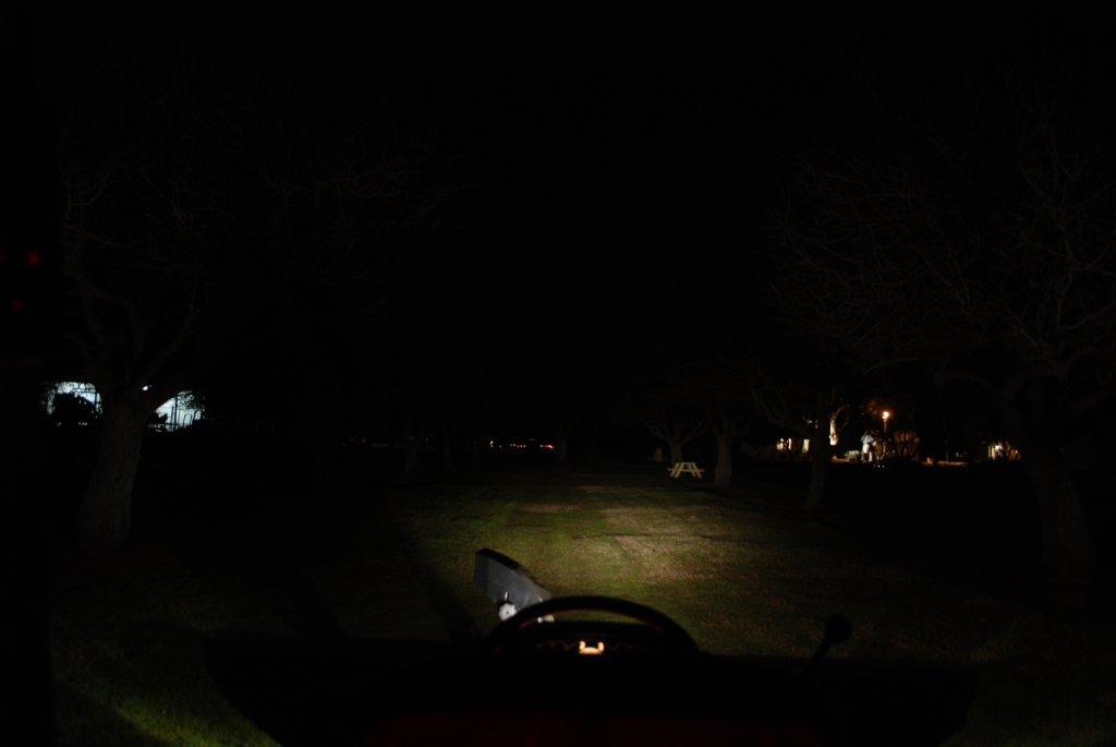

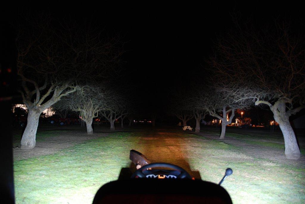

Max 22_25 headlight from drivers seat.jpgMax 22_25 headlight dally flood from drivers seat.jpg

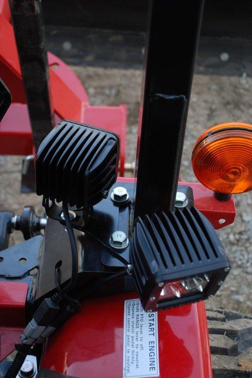

LED lights are very cool. Check out these shots. Left side headlights only. Right side headlights are still on with a pair of Dually LEDs. Same camera settings and exposure.

Very nice Dave!
