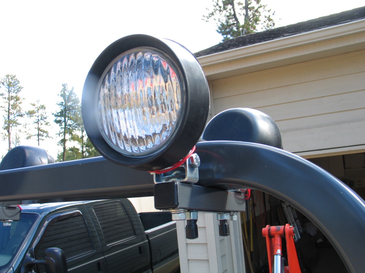

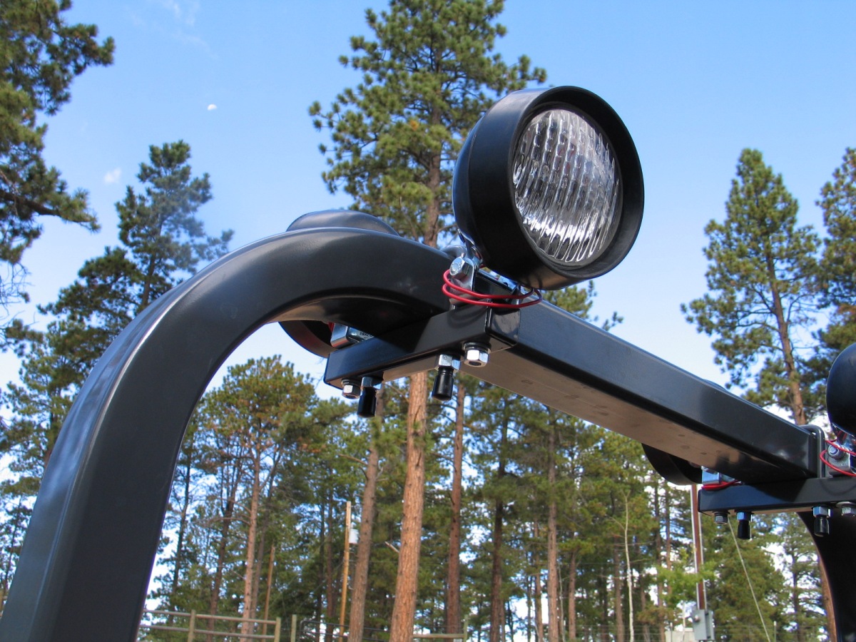

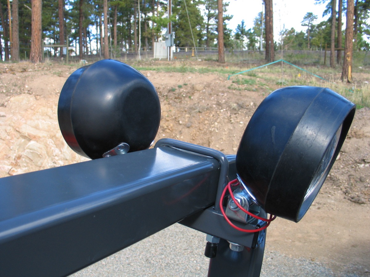

Nice work on mounting the lights Bandit. I like how you put Caplugs in the ends of the tubing, and covers on the threads of your bolts to protect your head from cuts.
Are you going to put the wires in plastic loom? That would finish it off very nicely.
Here are a couple of older pics of the lights wire-loomed (before the FEL plow).

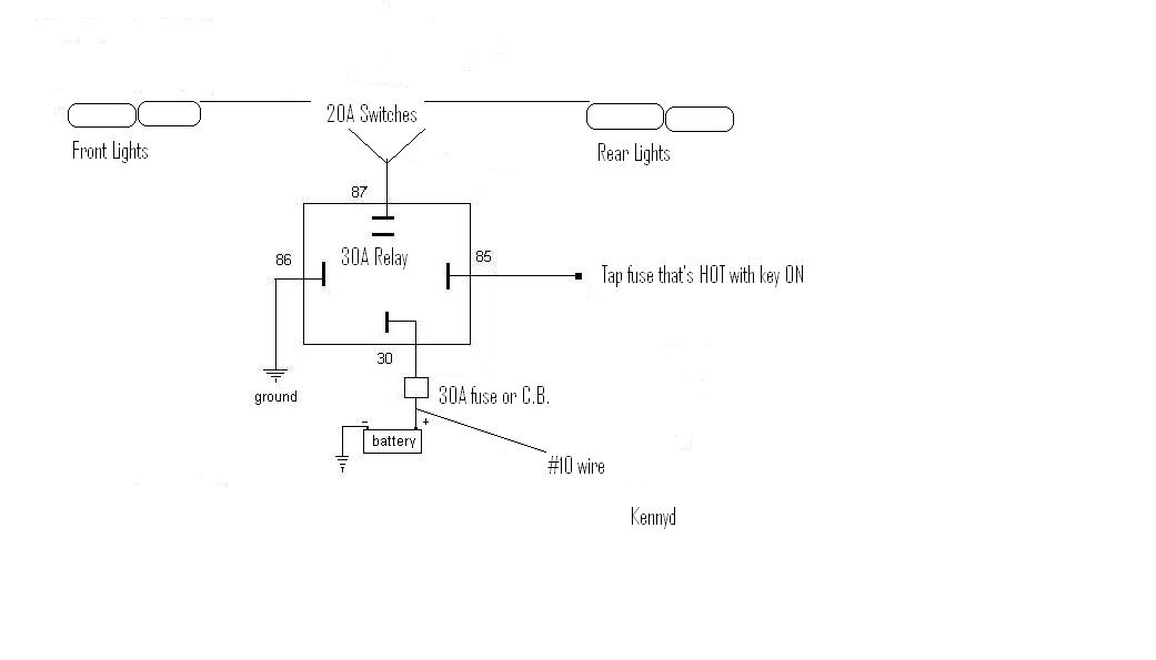

I didn't read every single post, so what I say may have already been covered.
1. A tractor is not a truck and I see no need to complicate a simple light wiring system by using relays.
A relay is no more than a remote switch that is subject to all the arcing and failures of a plain old toggle-switch.
I would run the power, fused of course, straight through a big toggle-switch, and on to the lights.
You want a switch that sounds like Matt Dillon cocking his .45 when you turn it ON/OFF.
A big toggle-switch will far outlast any relay.
2. I have gotten in the habit of putting those simple generic available everywhere two-wire pigtails on every 12-volt accessory I install, especially every light (not including markers).
Having a pigtail, instead of being hard-wired, it is a simple matter to un-plug the light and remove it for any servicing it may require.
3. Don't trust the tractor/vehicle frame as your only GROUNDing point.
Go ahead and GROUND to the frame via any mounting bolts/screws; but, also, run a seperate GROUND wire, from the bulb itself, directly back to a dedicated terminal bar that is directly connected to battery-negative; this one policy will eliminate 99% of all light troubles.:cool:

I've some maintenance background on my resume and I agree a hundred percent about the relays. They tend to get overused. They do have their application. I'm so over the hill now that the LED stuff is after my time, so I'm tryin to learn 'bout this new stuff. Is there a special flasher for the LED stop turn signals for low amp draw? I was thinking of mounting a set of LED stop turn on my Jinma JM354, but propbably would need the whole nine yards, you know turn signal switch and flasher unit to get the brake switch to work with turn signals. I do go down the road once in while and it would be nice to have the legal contraptions. bjr
Yeah, but some of us wanted the sweet looking, expensive factory switches. The less expensive relays can protect the more expensive switches, and are easy enough to replace if/when they fail. :cool:
I agree that this is very good advice for ease of future maintenance. :cool:
OK, but that can be fairly complicated - running the power wire was enough of a bear (pardon the pun :D ) to run. A long run of ground wire the entire length of the machine presents that many more chances of shorting out due to chaffing, cutting, tearing, corrosion, etc. Checking the mounting/ground bolts to be sure they're tight is fairly quick and easy, and is narrowed down to an easy to find location.
