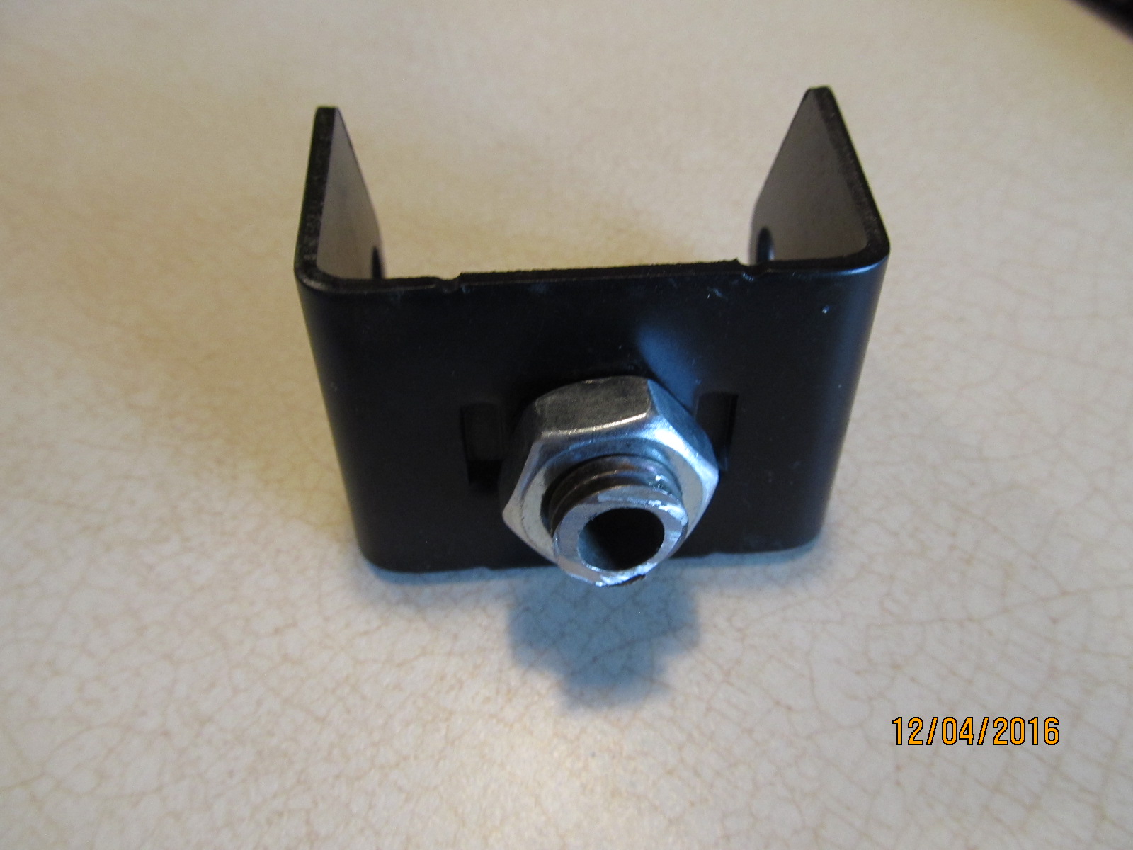

Here's how I did a clean and simple worklight installation on my Kubota M7040 using holes that were already there. It looks like it belongs. I'm not a big worklight fan and think one is enough but preferably not on the ROPS where it creates shadows. Anyway, I had these two worklights on the shelf so what the heck.
Here's the rear taillight before I started. It has a neat hole in it that's awkwardly positioned but lends itself to something more. My new worklight had a bolt arrangement with a hole in the bolt to feed the wires through. It was too long so I shortened it.
Here is the shortened bolt with the hole in it plus the bracket.

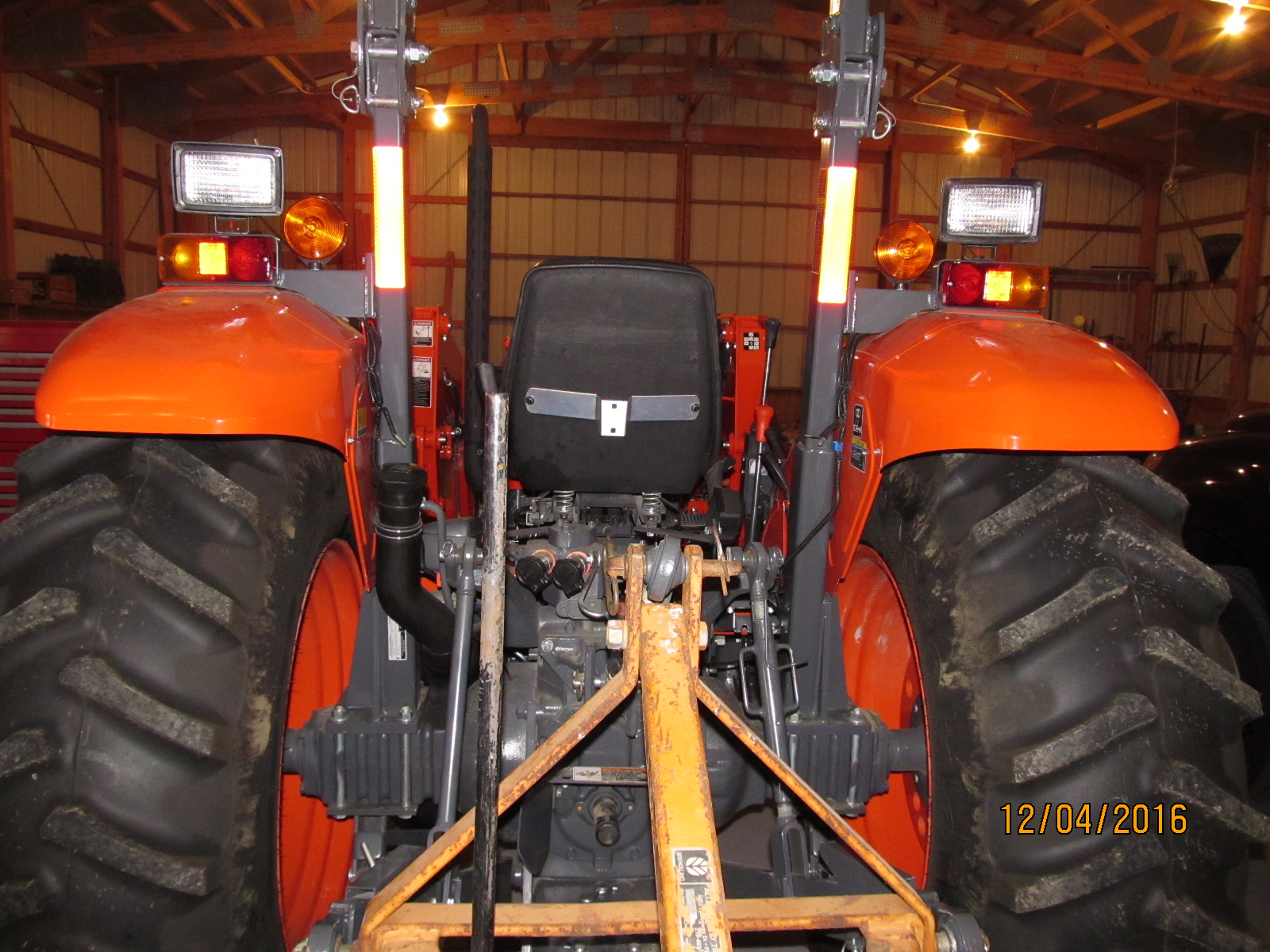

Here's a mounted light. The wires are not routed yet.
Final install. Of note is that I installed switches in the top of the light and put a rubber waterproof switch cover on.
I'm not a big fan of too many worklights but you never know. Probably better to have and not need than the other way around.This works for me because it looks like it belongs and I had the lights just sitting there. :dog:

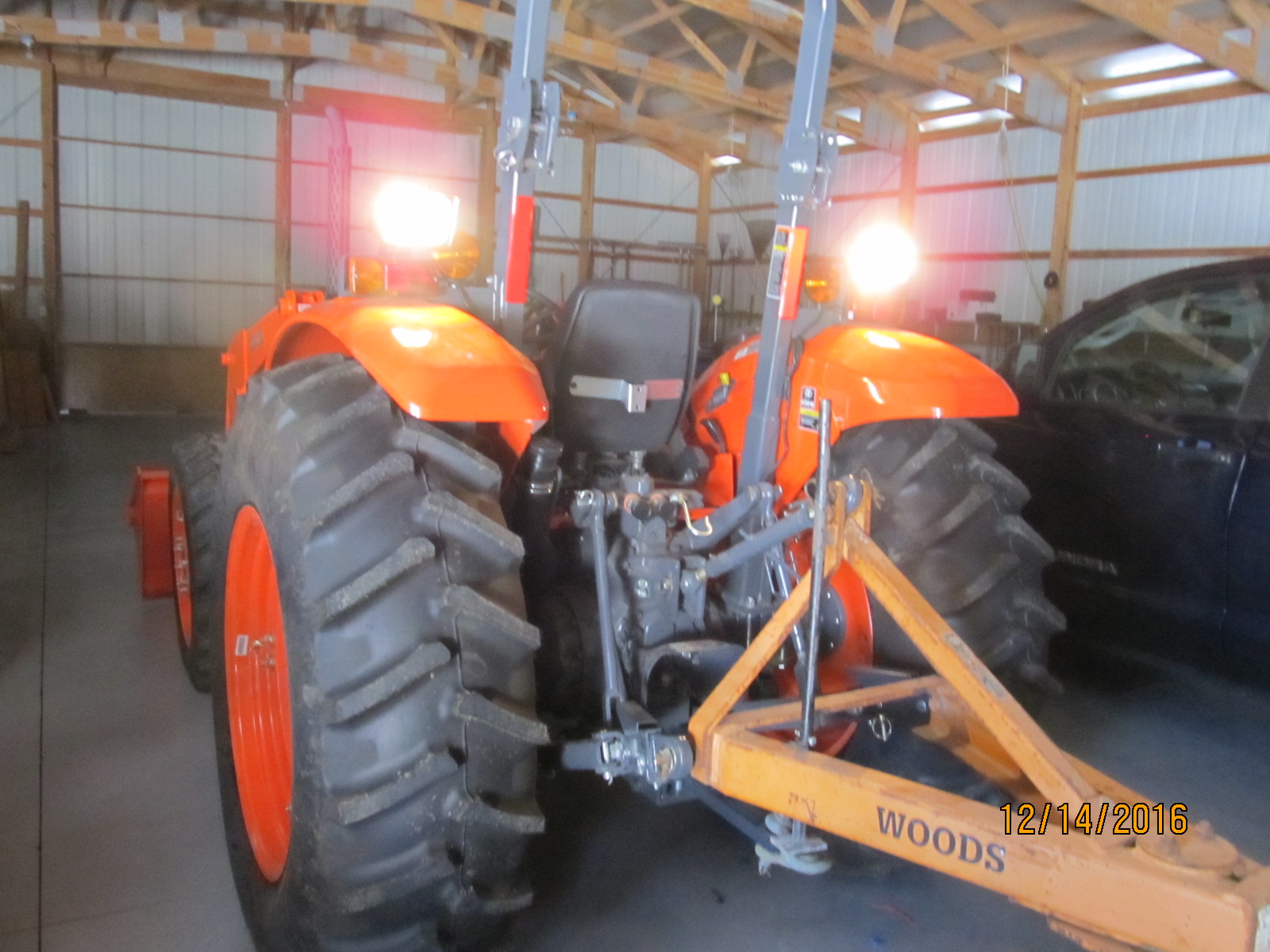

Here we go with the lights on.
Turned out to be a pain in the keyster because I had a bad switch that I wired into the light. I kept presuming the wire connection was bad and after the third time of taking everything apart in the cold I figured it had to be the switch. It was.
Anyway, new switch and it's off to the races. Now, I'll probably never need a work light but if I do, I'm golden.
