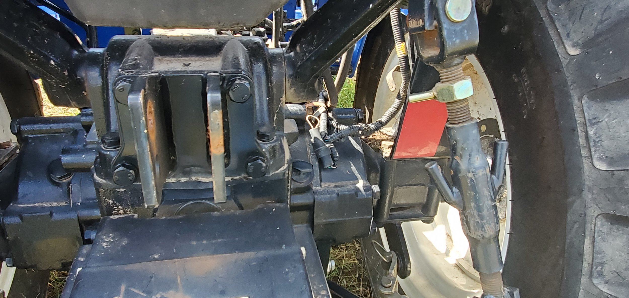

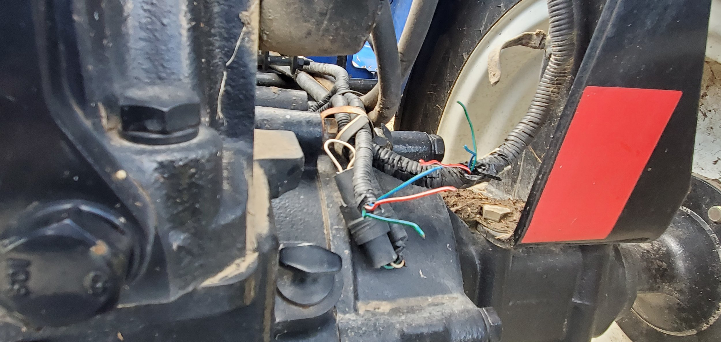

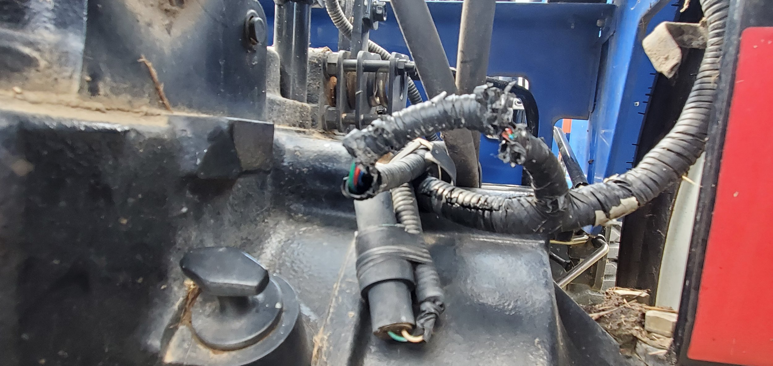

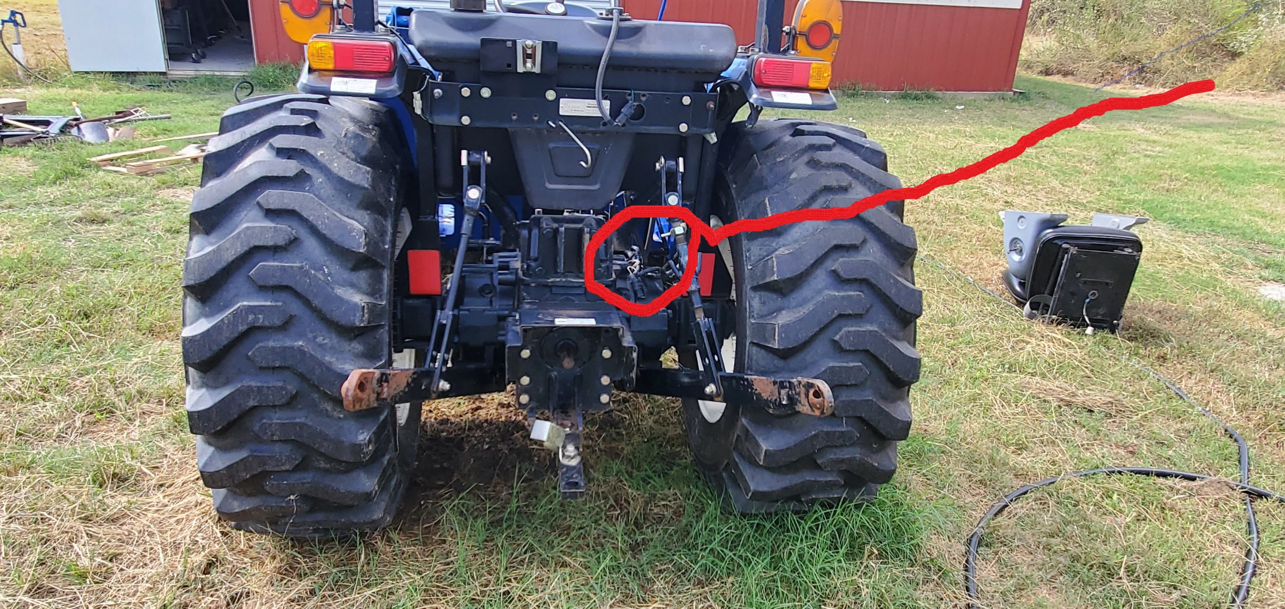

******************UPDATE FOUND IT**************
I found it, and it wasn't anything I had looked for or frankly had even been suggested, by that I mean it wasn't a connector pulled loose. It was a torn wiring harness, above the rear axel passenger side:
This is what it looked like, the black protective sheath around the wires was just kind of crumpled, it didn't even look bad until I touched it and could see the wires were completely torn apart:
So, 3 wires, blue, green and red/white. Got them back together and that solved it. Looks like the straps holding the harness are pulled too. I'm guessing something got wraped around the harness and pulled hard enough to tear the wires.

So frustrated he ripped his seat out.. :ROFLMAO:
Also, I am tripping looking at what appears to be 2 different sized rear tire... :unsure:

Well, as a general rule I mow and plow in circles. so there's that....
