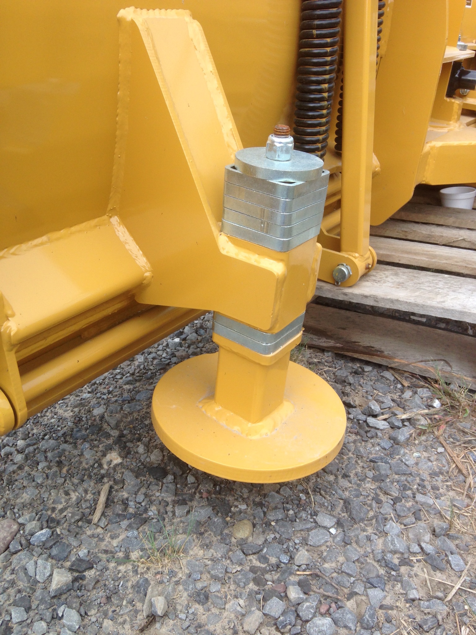

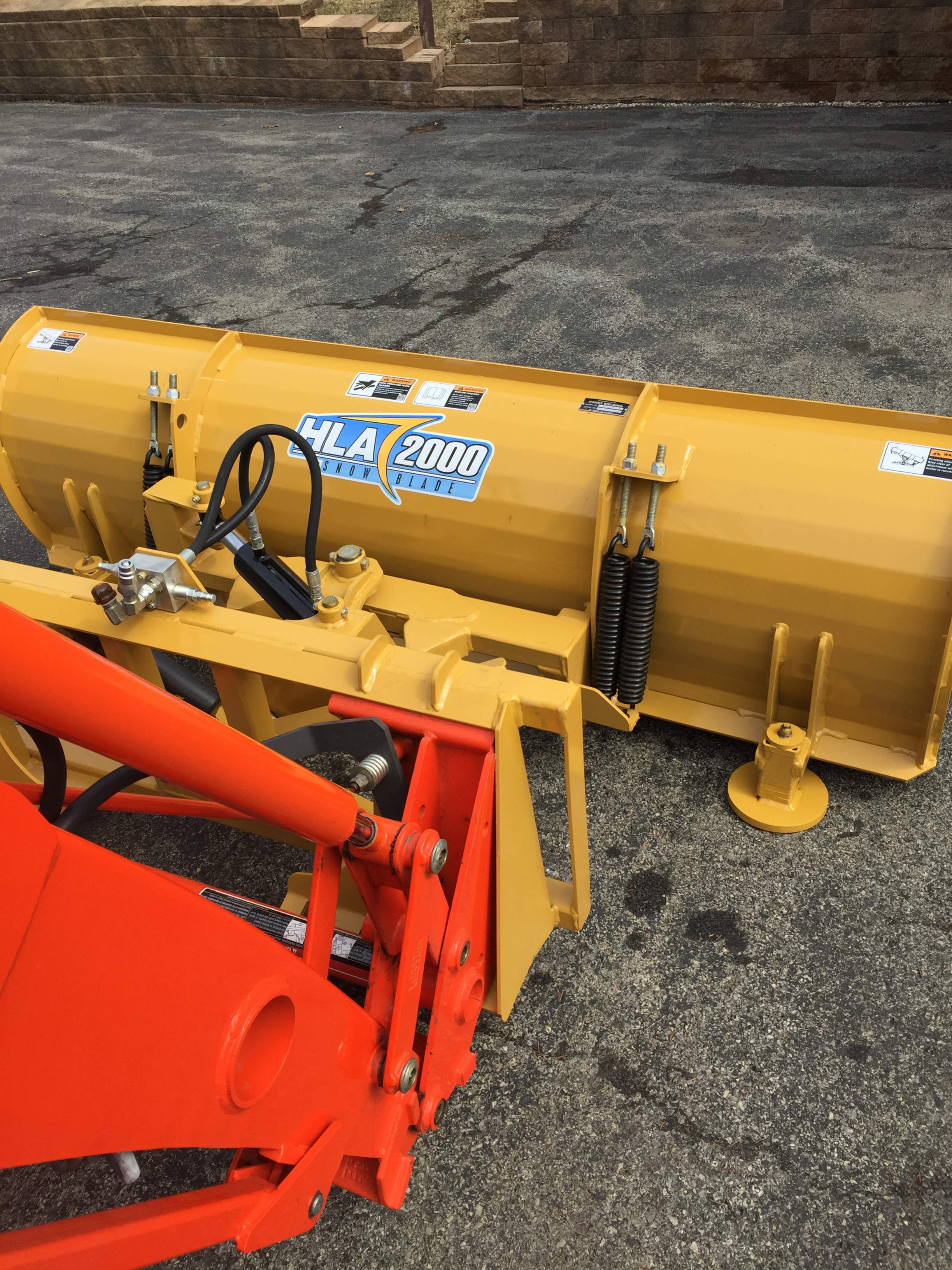

Once again -- thanks. Got the plow today. Went with the HLA. As you have all said it sure is a rugged piece of gear. I will spend some time tomorrow going over it and looking for any issues I missed. Very well built, great shape - my only concern is that it has fixed shoes. I would much rather have adjustable but it looks like if i fire up the torch and the welder I could change these out. But as soon as we get some new snow I will try it out and see if there are problems with the fixed shoes. They appear to set the blade about 3/8" above the bottom of the shoe. So I am not too concerned.

Interesting! I didn't realize that they had made plows with fixed skid shoes! Like to see a photo... All the HLA plows I have seen (catalog + in person) have stacked spacer shoes.
   / WORKSAVER VS HLA Snow plows #16
Here is link for HLA Snow Blades, they do not make one without adjustable shoes/skids. Maybe you bought an older model or clone? Just saying, my 2000 has adjustable skids/shoes and my friends 1000 also has them. Picture please? HLA Snow | 2000 SnowBlade

I purchased a HLA 2000 new 4 years ago that had set on the dealers lot and the paint job was bad. I had it painted to match my Kioti and it worked great. I then purchased a new HLA 3000 and have had it for two years and the paint job on this one is holding up much better, it still looks good. Both have similar type adjustable skid shoes.

Hello Again - I see some questions here on the shoes for the blade. Tomorrow I will grab a few pics. The Snowblade has all the characteristics of an HLA and was sold to me as a Horst Welding snow blade. My assumption was that Horst and HLA were one and the same, but I am only making an assumption on that. I will check this out tomorrow and post photos. Anybody know if and where there would be a model / serial number tag?
