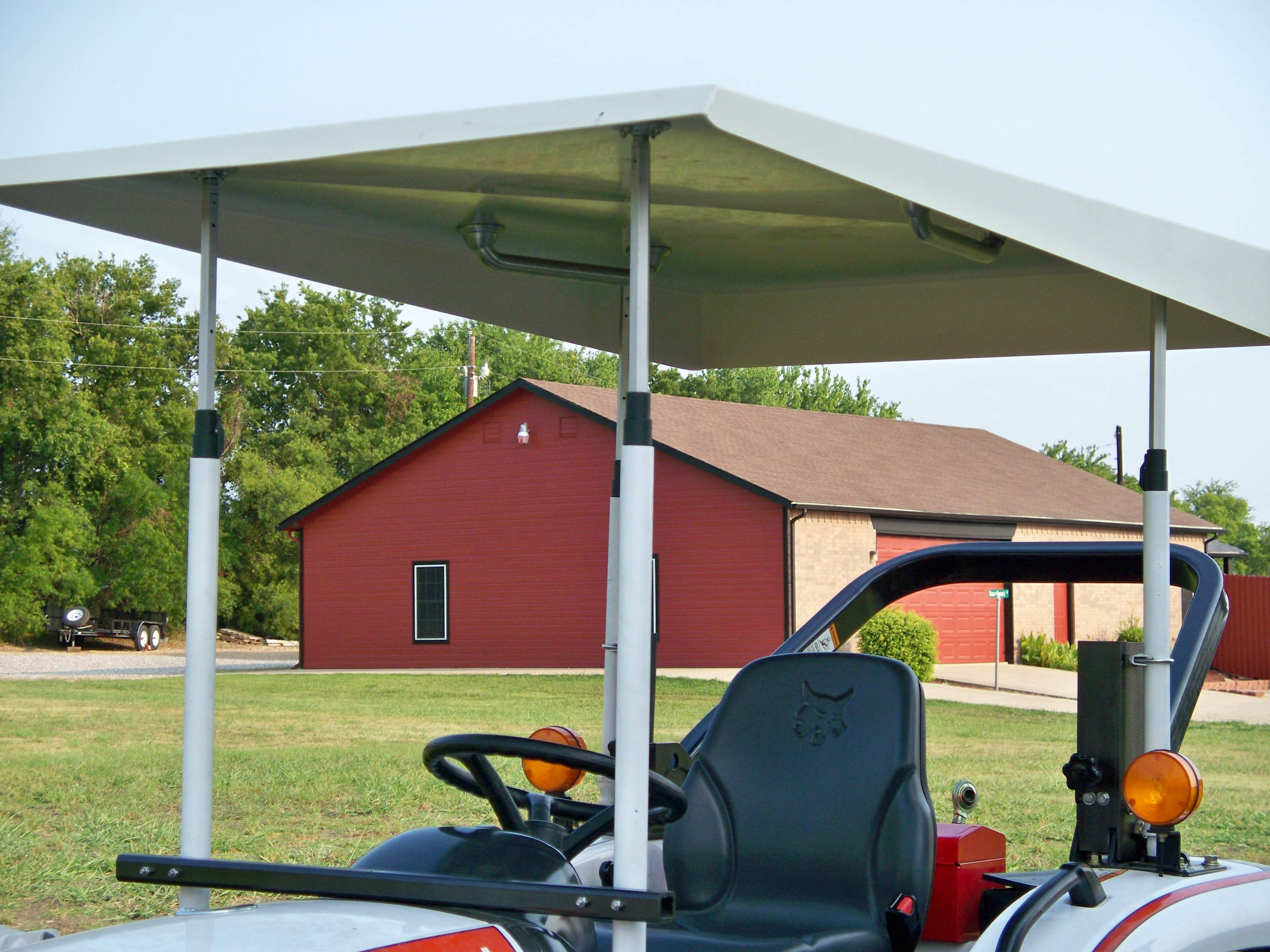

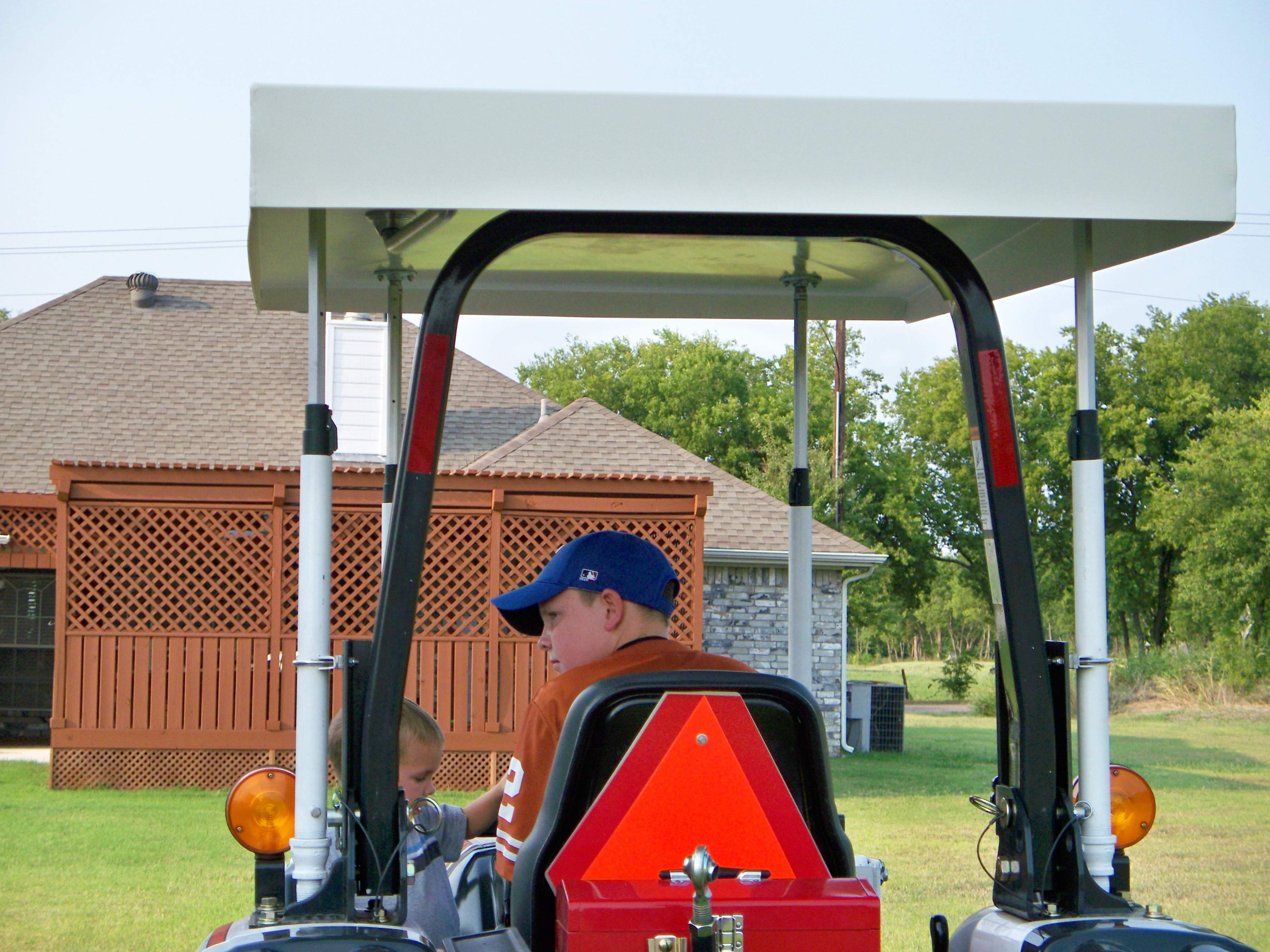

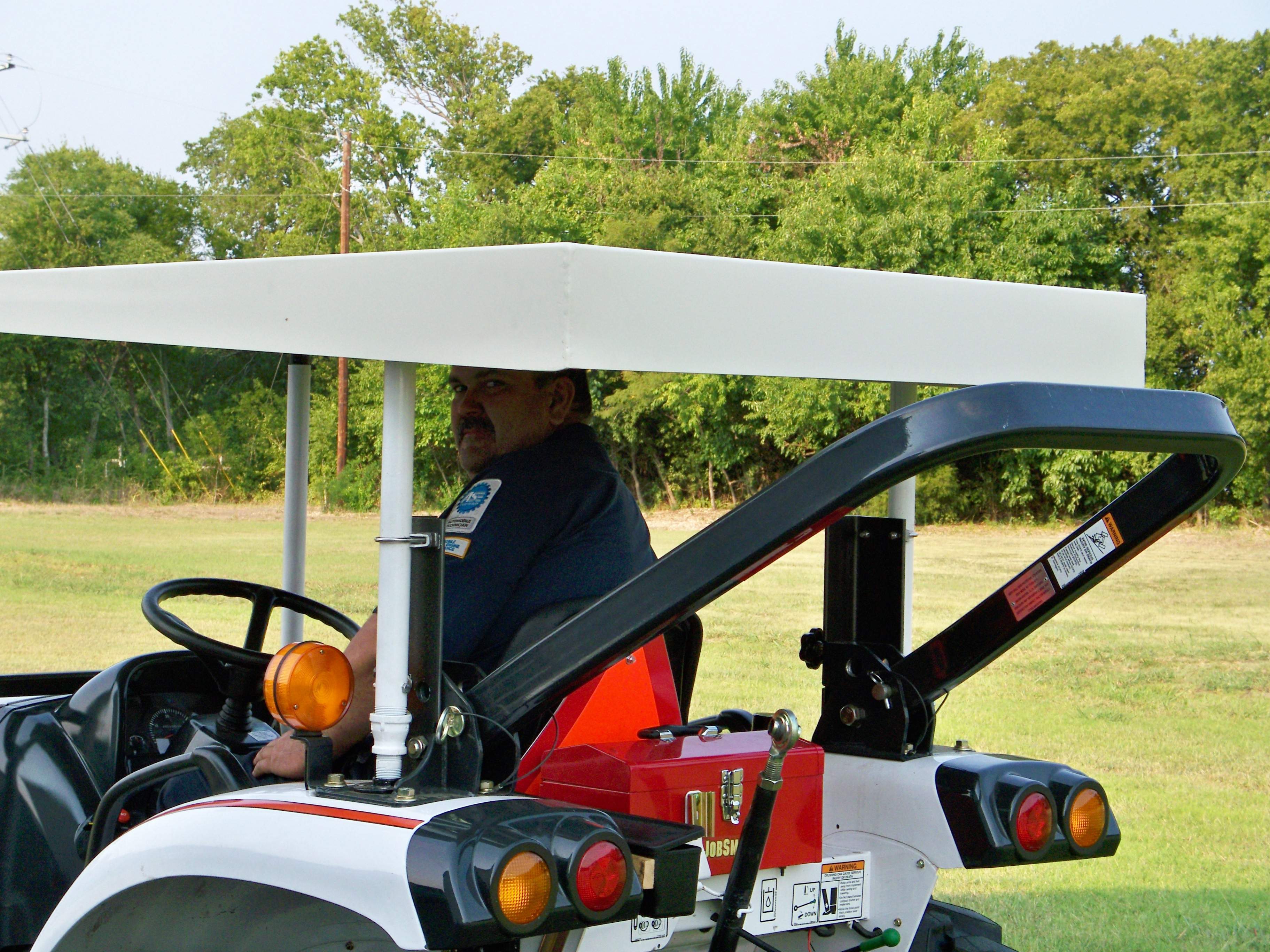

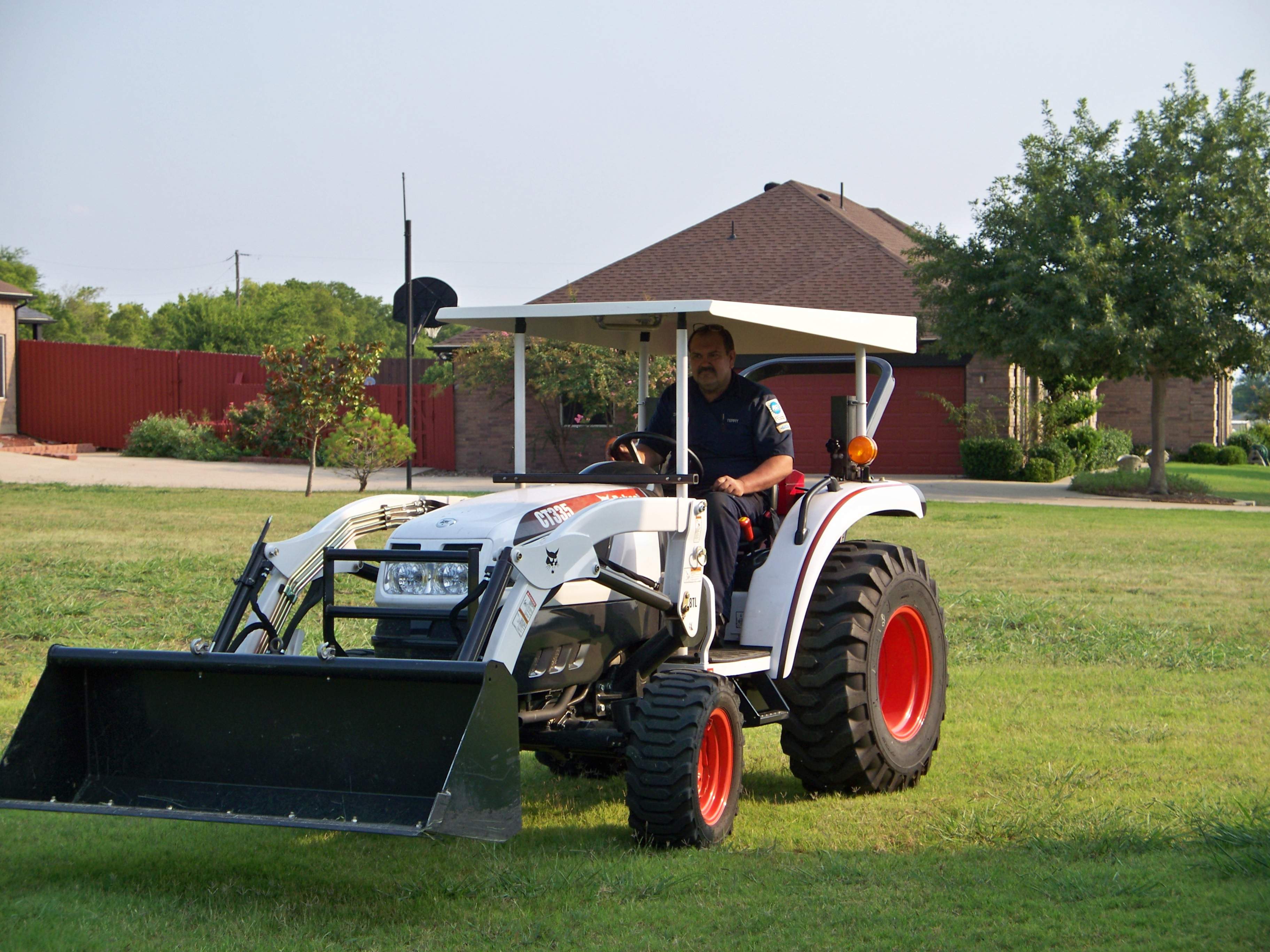

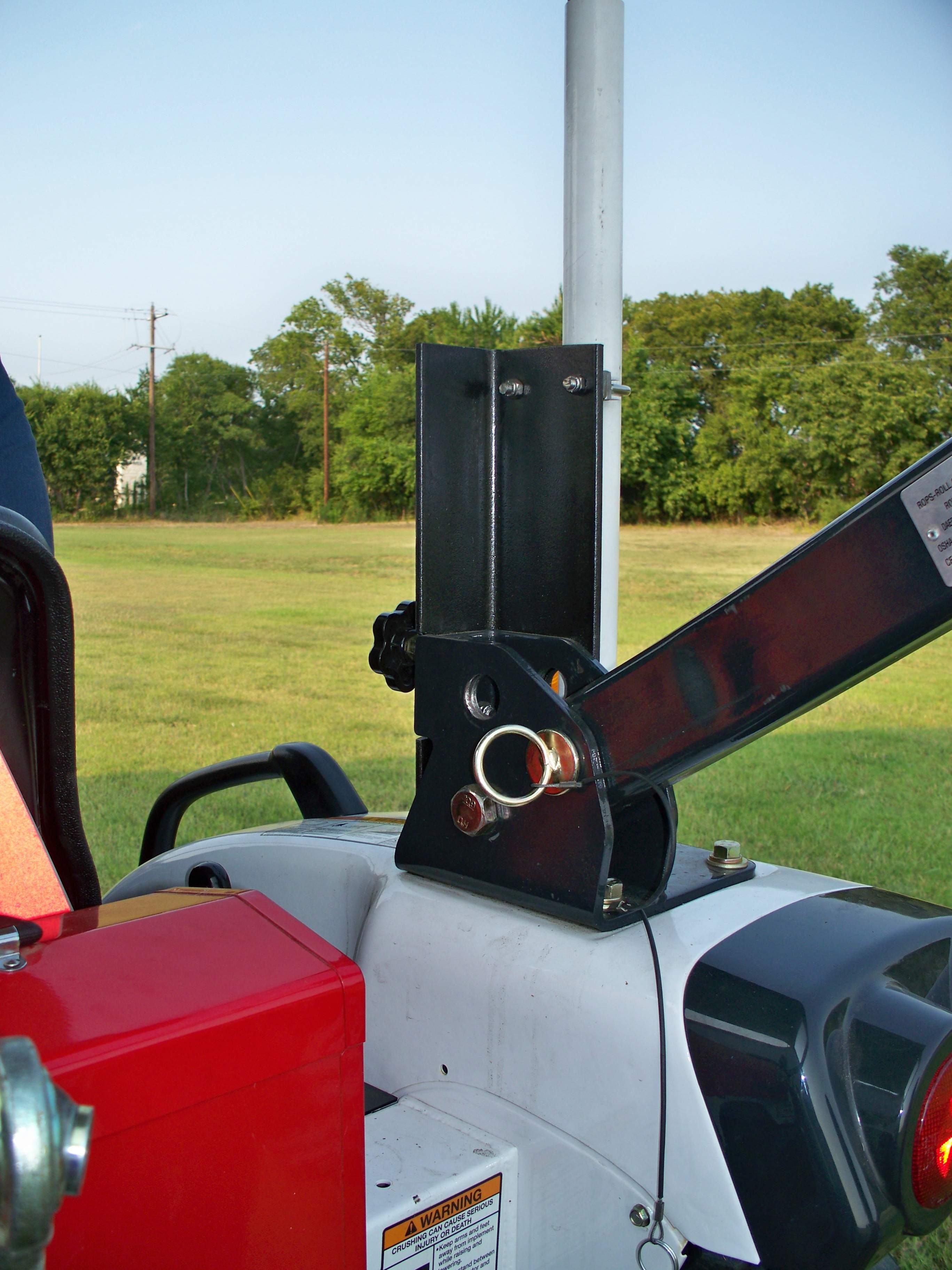

Just built a telescopic canopy for my CT335 to still allow use of rollbar and to be able to squeeze in my7 foot tall garage. Just wondering if I'm alone...Pics soon to follow. :D
/ World's 1st Telescoping Canopy?
Problems uploading pictures tonight.:mad: Give it another try tomorrow. Waxman, no it is not just a folding canopy, its a telescoping straight up and down. The pics will speak a thousand words!:cool:

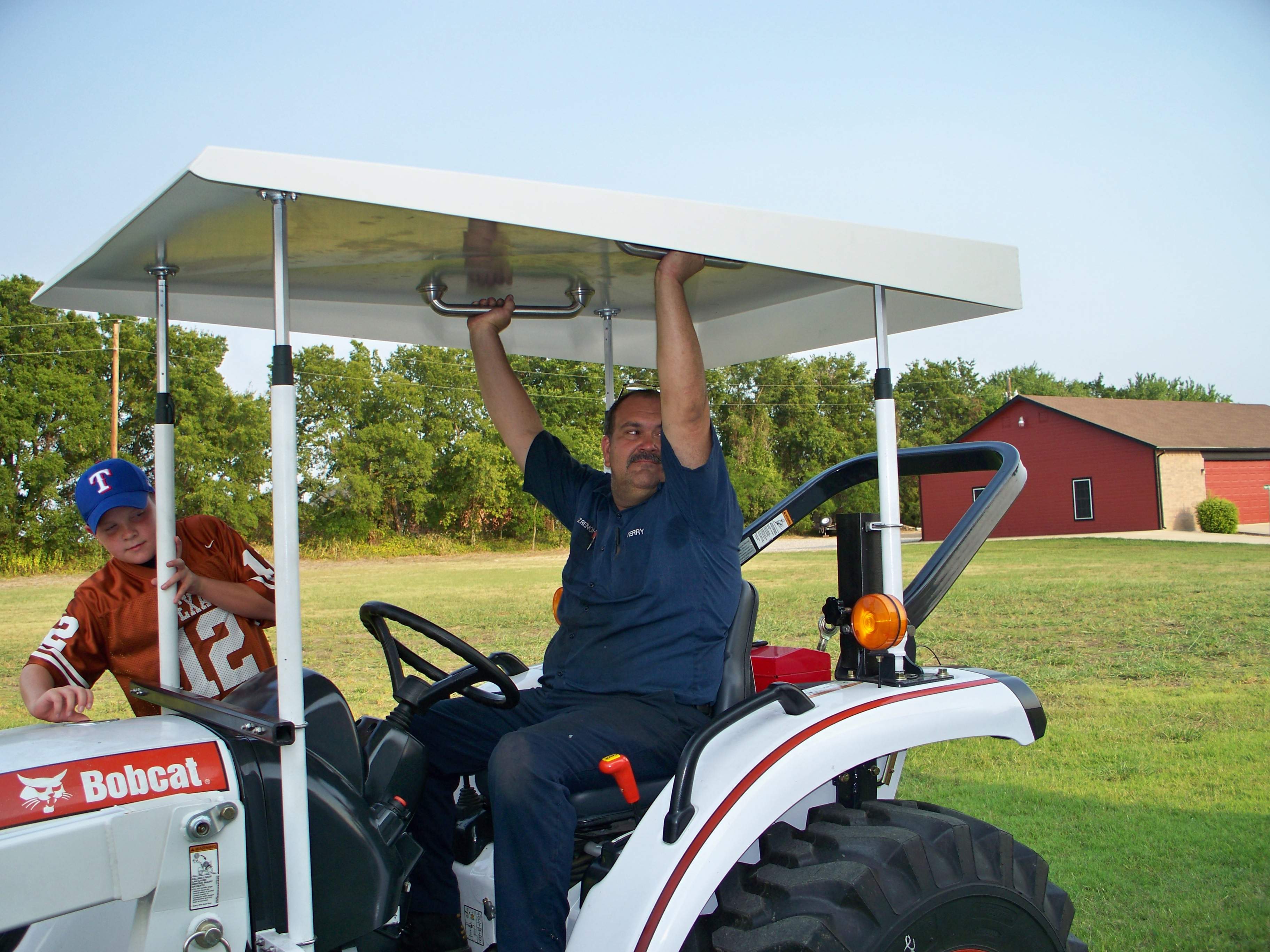

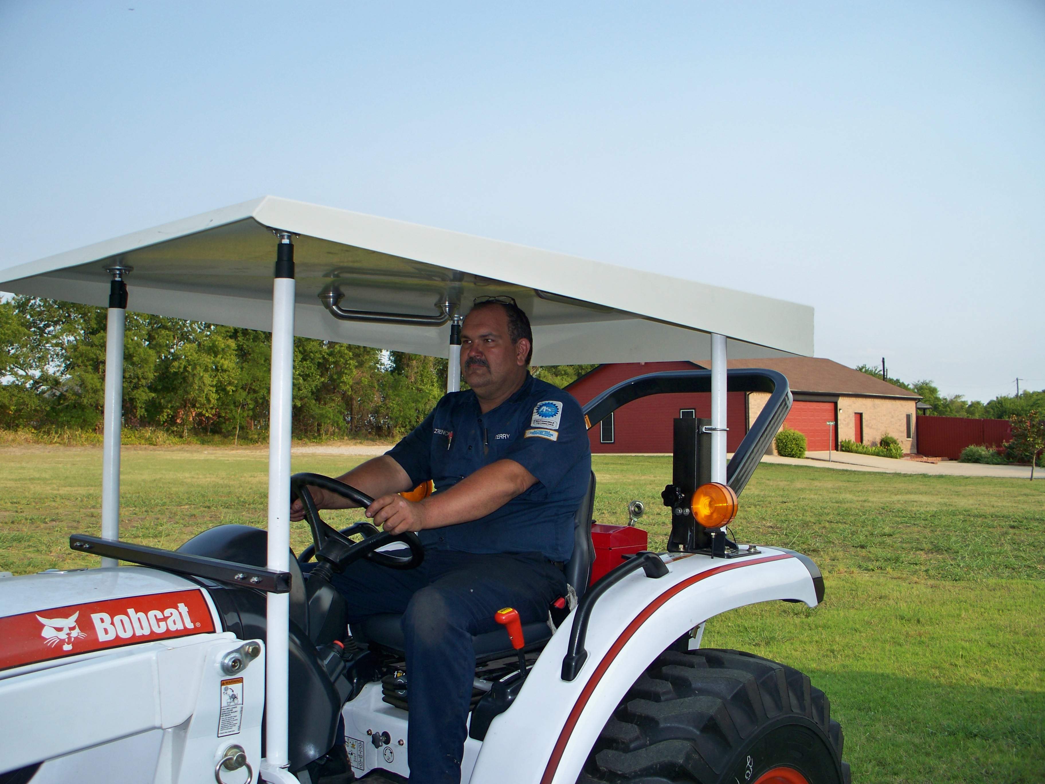

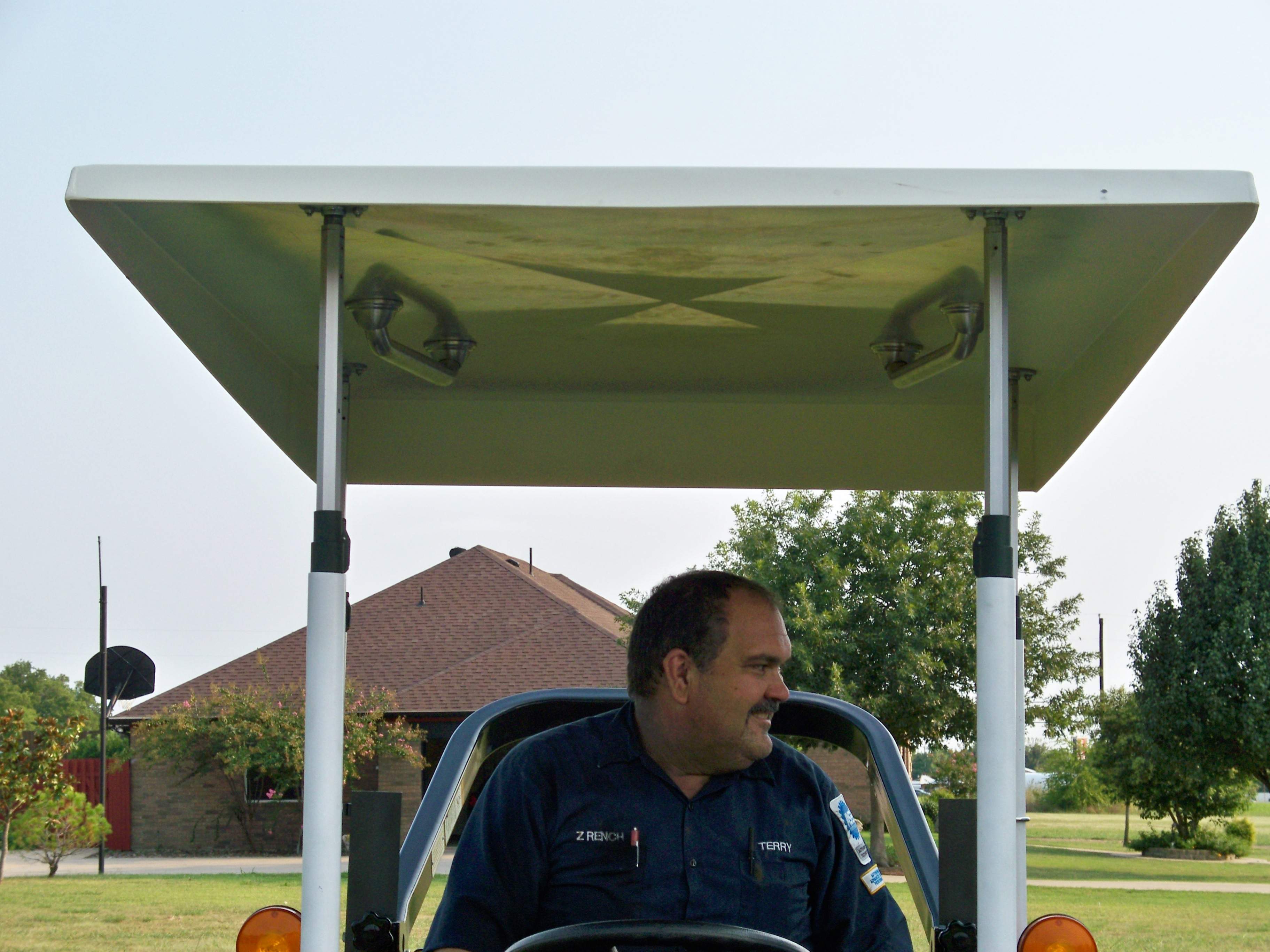

As promised after long hours kickin' the computer, here they are! :D

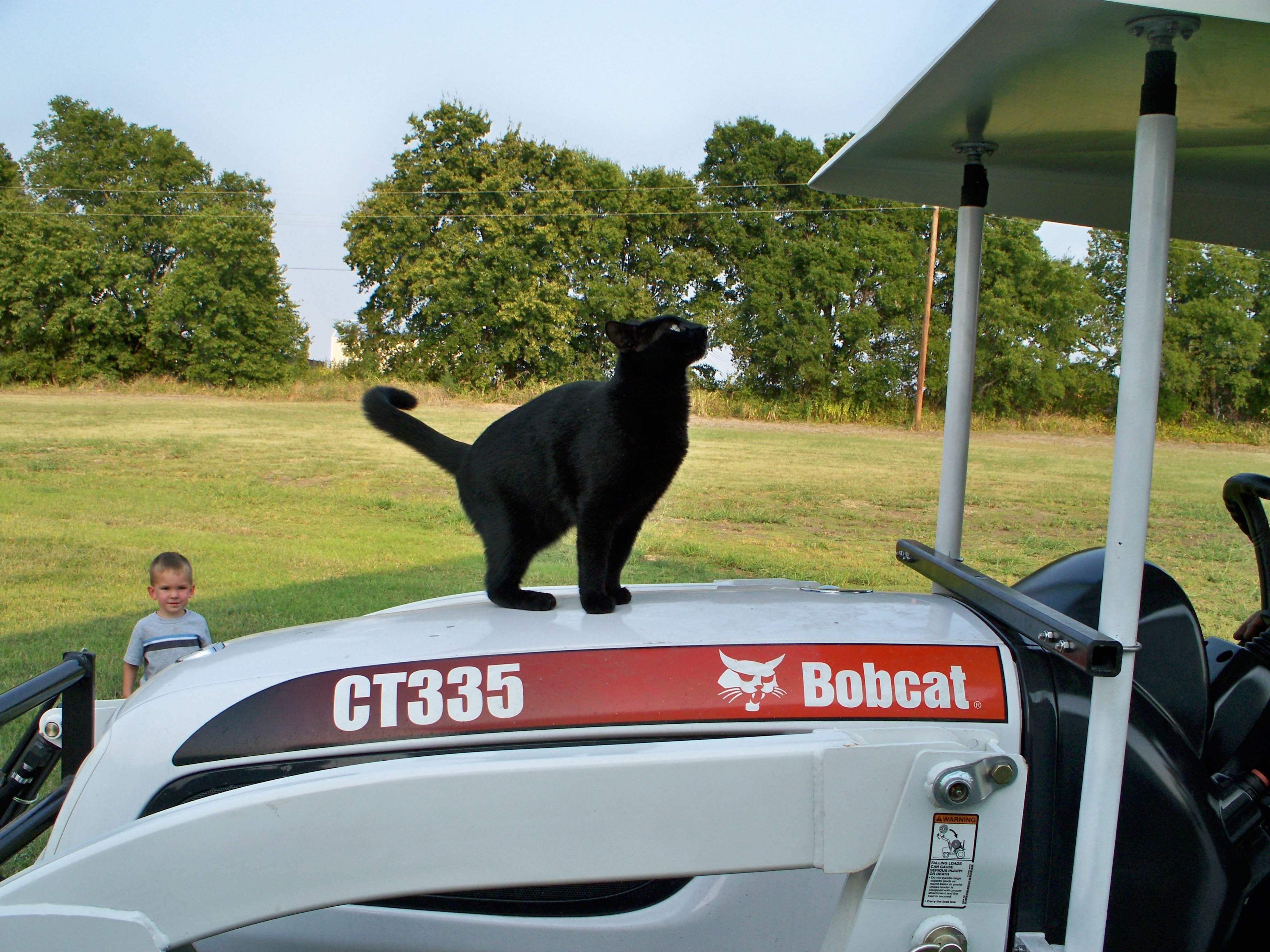

What's your cat's name................................. Bob ? :D
#9
Actually it's "COTN" which stands for Cat Of a Thousand Names. We could not decide what to name her and kept renaming her, so we just decided on COTN which is pronounced "Cotton". I know--- a black cat named Cotton! :rolleyes:

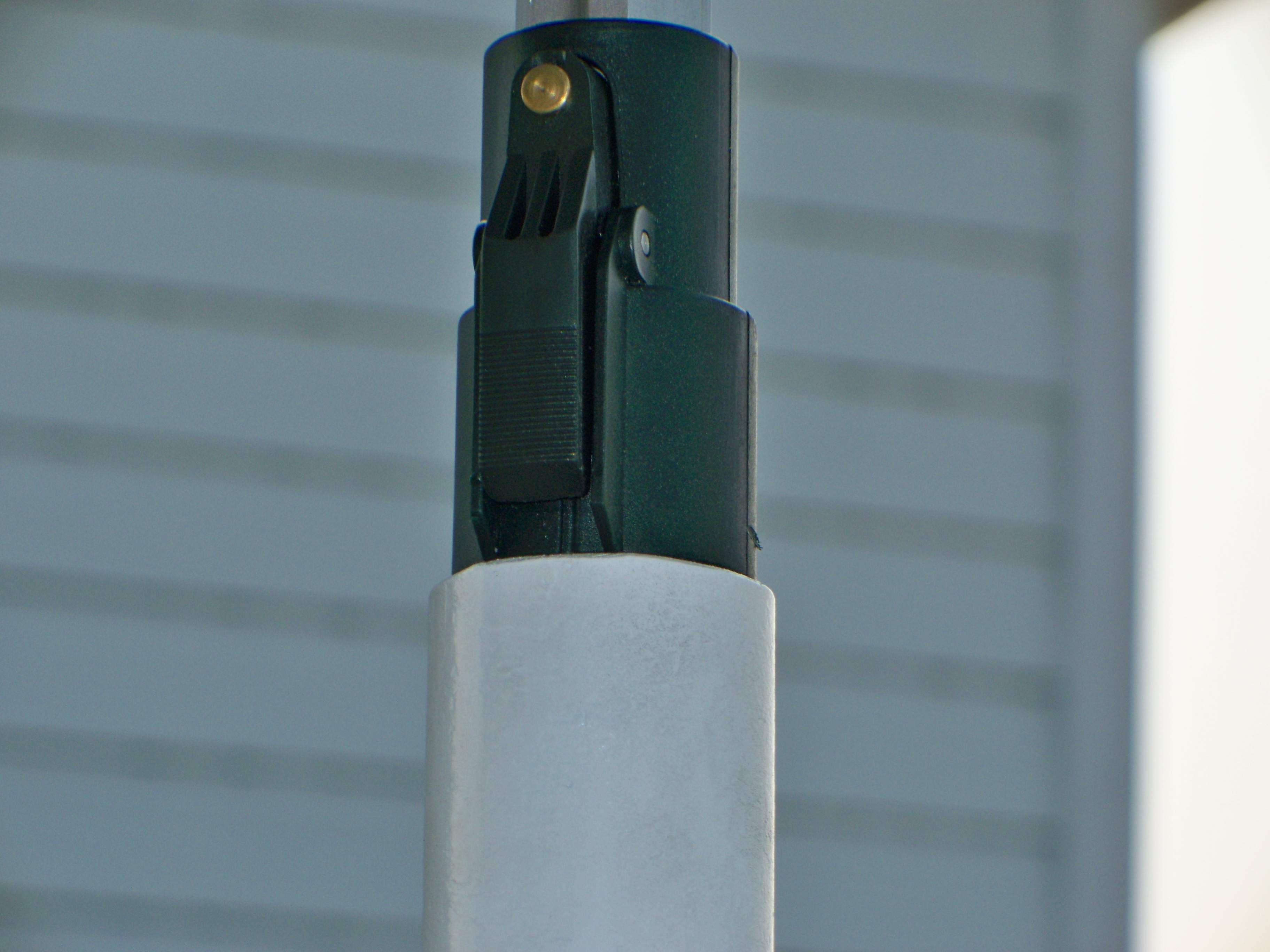

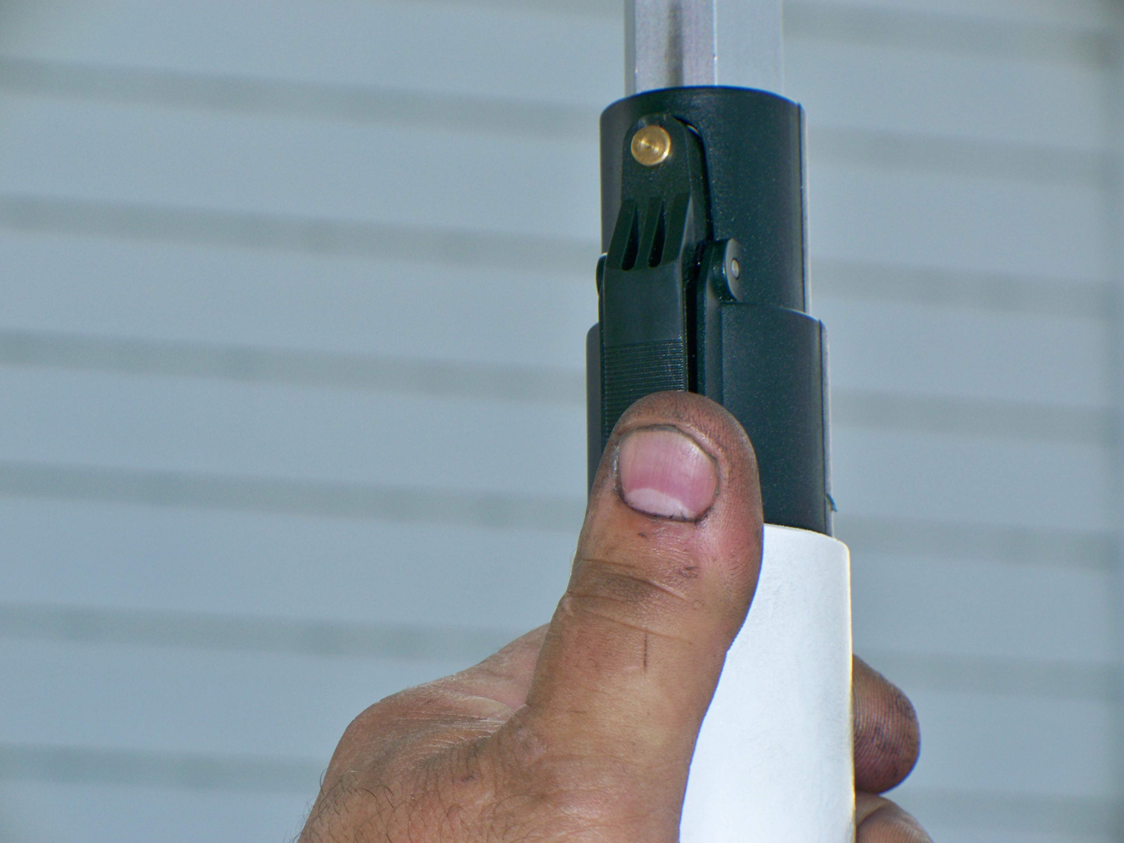

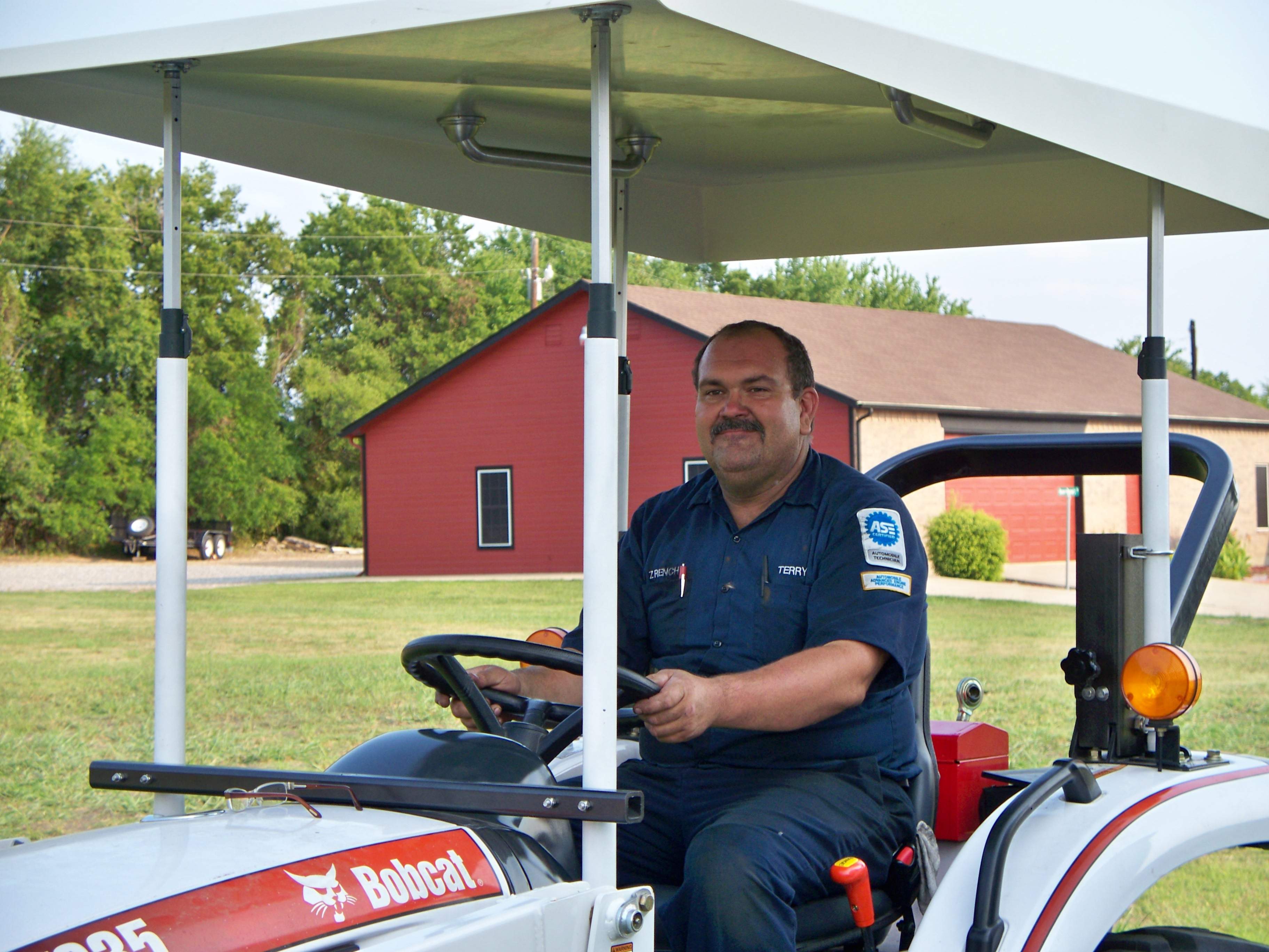

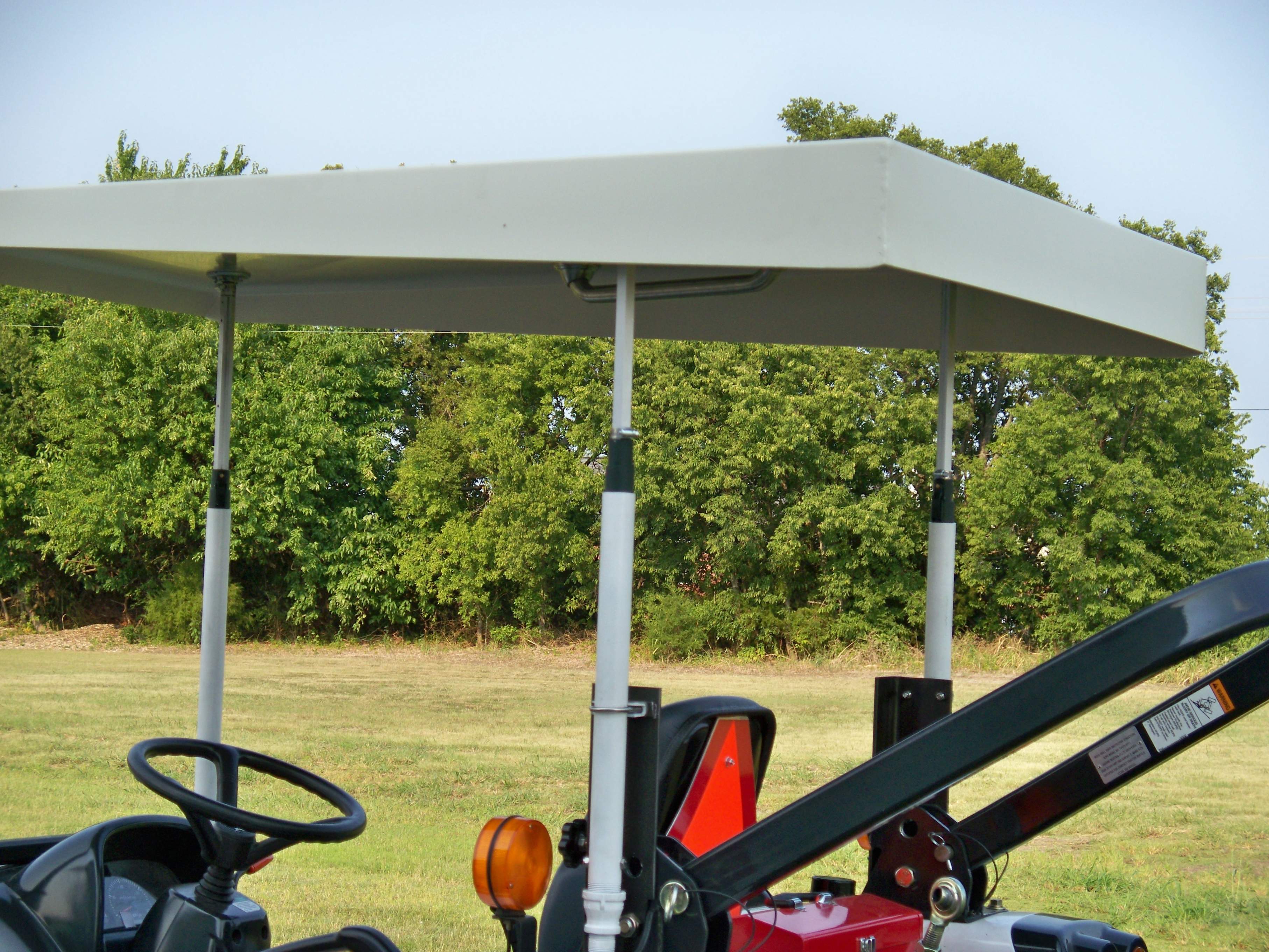

As far as what this canopy is made of, except for the top which is an 1/8" thick 5X8 sheet of aluminum sliced & diced to order from a local metal fabrication shop, all the other materials were purchased from your local home improvement store. The outer poles are 1 1/4" black iron pipe with 1 1/4" schedule M copper pipe inside of them. The actual telescoping parts, which are inside the copper pipes, are Wooster brand paint roller extendable handles. The iron pipes are anchored to the tractor via pipe floor flanges and U-bolts with a couple of custom made brackets. The canopy itself is also anchored to the top of the poles via floor flanges. The telescoping poles lock into place in custom drilled holes. When the top is down, all I have to do is push up aprox. 1 foot, and BINGO--instant hi top canopy. To lower it I have to release the 4 tabs, 1 on each pole and hang on 'cause here it comes! Headliner, mirrors, fans, & lights still to come---Stay tuned. :)

Very clever use of "available" mass produced materials.

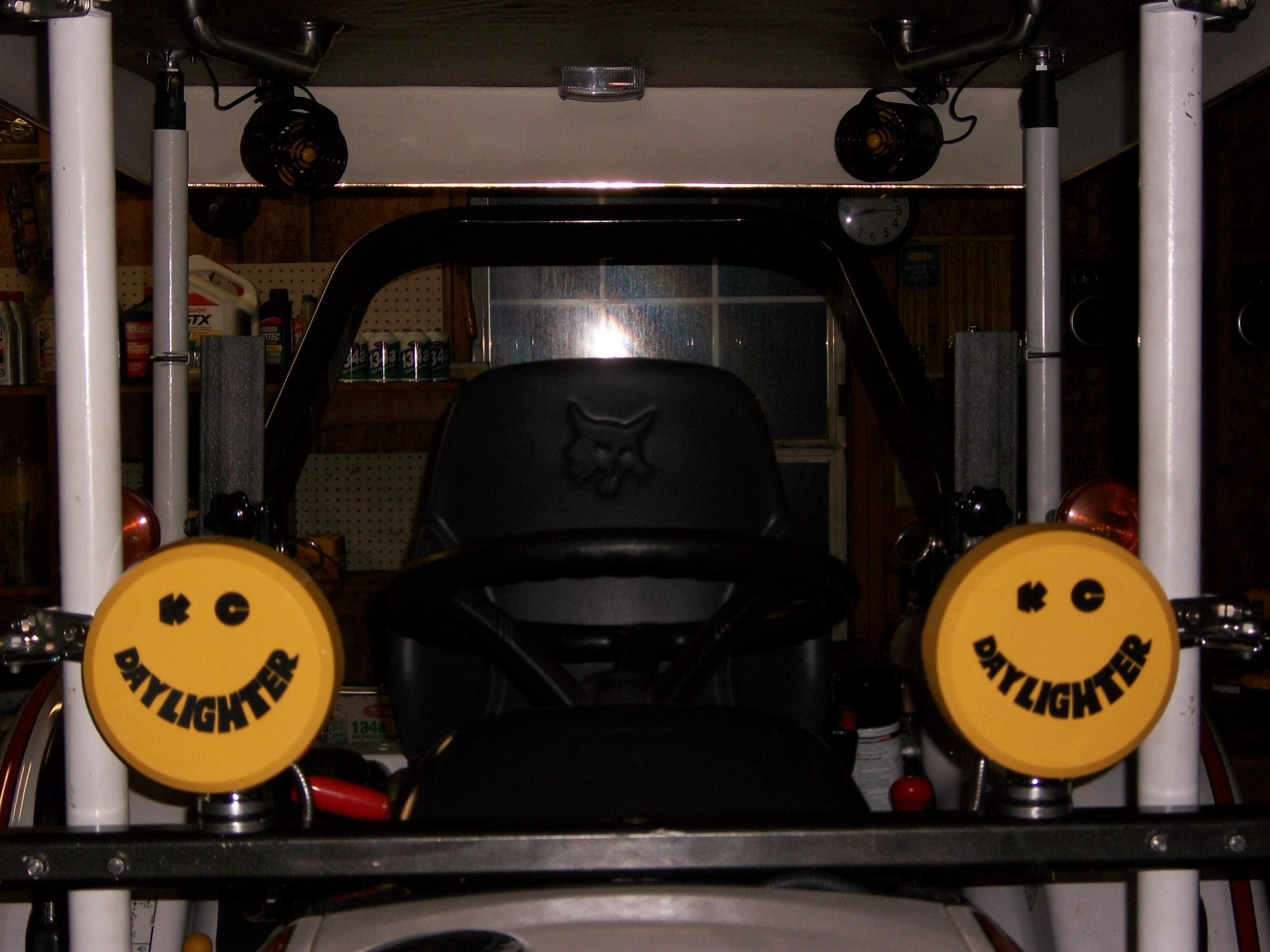

Hello again fellow tractor buffs. Been busy at work, but finally got back around to working on the tractor canopy. Had to make some money to support my tractor habit. Anyhow, here are some more pics of the canopy in progress. Pics are of the radiant heat barrier insulation, marine grade vinyl leopard skin headliner material, 4 tornado fans, & 2 dome lights. Mirrors, driving lights, & camera system coming----I hope!Picture leopard liner 004.jpg

Well, been hard at it again this weekend. Got the mirrors and front long range 100 watt KC driving lights put on. Here's the pics to prove it!:cool:
