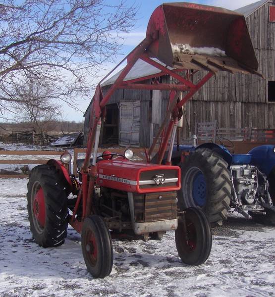

Got a little more information from the seller on the phone, story is that this was an estate sale purchase, tractor was bought new and was only used for snow plowing the driveway which was an explanation for the low hours. Appearently all of the documentation and the original service manuals are on hand, tires are filled with calcium, has rear remotes, a live PTO so that must mean that it has the deluxe enginge? He has a MF 165 and said that its the same engine as that, that is in the 135 for sale. The only thing that the seller mentioned by way of issue was a leak at the fuel shut-off brass fitting which he was willing to fix.
Purchased it from an estate sale but his reason for selling is down-sizing. Haven't seen it but from the sellers description everything works. That really means nothing until you have a look at it yourself but at the price with a FEL and a 5ft LandPride Bushhog, don't really need that but could sell, along with free delivery to the door seems like its worth a look at least and warrants the drive there and back, if its not sold by the weekend.
Know that one thing to look for is leaking at the clutch housing, hydraullics, PTO, bearings on the front wheels, can get it into all of the gears, engine smoking and general condition, will look and see if it looks like new spark plugs or not. Any advice on other common things to look for on 135's?

Make sure the tach and hour meter are working, if they are not, there is no way to validate those low hours. All 4 tires should the original ones that came on it. Ken Sweet
