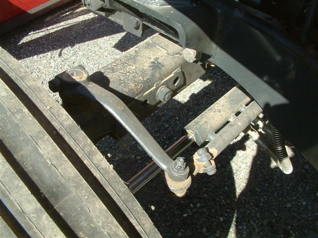

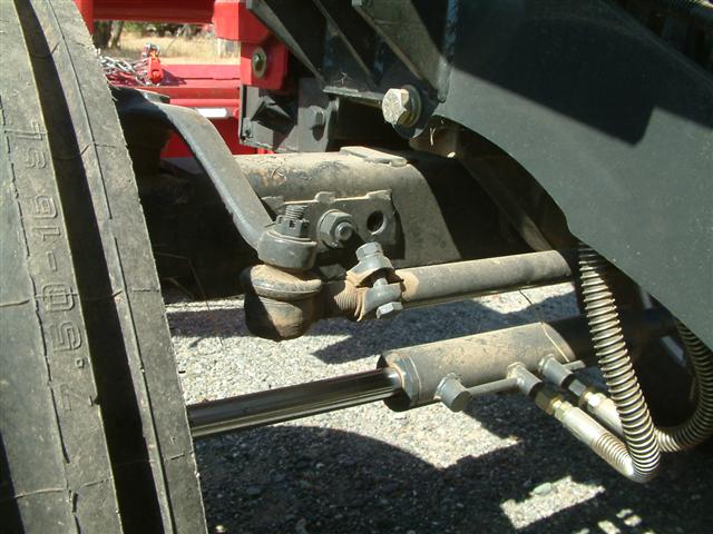

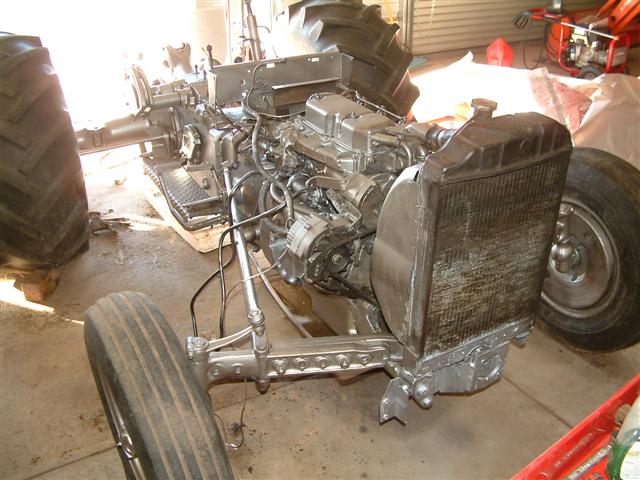

One other thing to keep in mind--the MF135 is not a particularly good choice for FEL work since the front axle is not as strong as some of the other MF tractors of that era, such as the MF150.
Here's the front axle on my 1964 MF135 diesel (45 hp engine, 37 hp pto)
Compare to the front axle on my 2008 Mahindra 5525 (54 hp engine, 45 hp pto) which is considerably beefier than the 135 axle.
Also note the hydraulic cylinder on the 5525 front axle. It's the power steering cylinder--the 5525 has true power steering. The MF135 has "power assisted" steering, which means that there's a small hydraulically driven power steering gizmo built into the steering column. If you intend to move heavy loads in your FEL bucket, decent power steering is a must and the MF135 is lacking in this regard.
