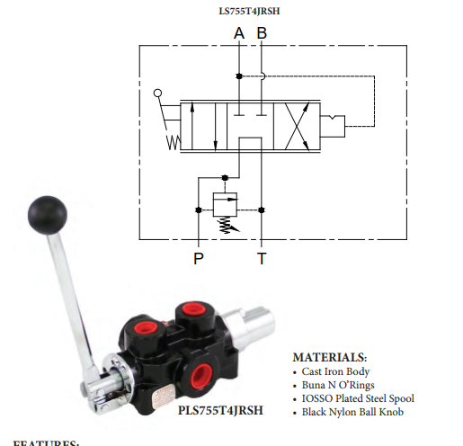

It is a log splitter valve and yes, it's an open circuit. When not actuated, it returns to tank.

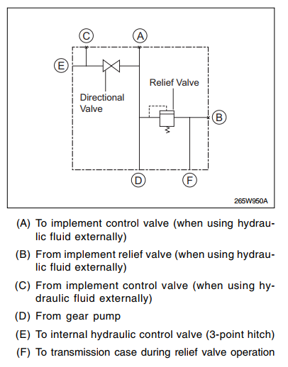

This the hydraulic diagram of the valve. When I was using the box grader, A and B weren't connected, just P and T. Looking at how it was connected to the tractor, the valve Tank port is connected to the Carry-Over port of the tractor's auxiliary relief valve (where the loader and then backhoe is connected to).
This is the auxiliary relief valve diagram. Carry-Over is labeled C here and E is going to the 3PH. So, it looks like the Carry-Over port is seeing pressure when I move the 3PH and depending on how the relief valve of the log splitter valve is connected internally, may be it 'draws' the lever in when there is pressure there.
So to answer my question, I think a check valve on the Tank port of the log splitter valve would prevent it from seeing pressure. Another option would be to bring the log splitter valve Tank port to the back of the tractor where the backhoe Tank port connects to so it never sees pressure to start with.

So I've decided to replace the log splitter valve by a real DCV with PB.
Might get this one which would give me an extra remote.
Both valves are 9 gpm flow rate while my tractor is spec'ed at 7.9 gpm.
The 'Carry-Over' port I mentioned before is called in my user manual "R PORT (Carry-Over Port Of The Exterior Implement)" so I'm assuming it's a return to tank port? This seems to contradict that diagram in the service manual I posted earlier. If it is a return port, can I plug my valve Tank port to it or will it this do the same problem my log splitter valve is experiencing? My idea is to connect the loader PB port to the valve P port, the valve PB port to the backhoe P port and the valve T port to that 'R Port'.
