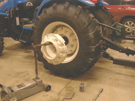

Are they easy to take off and put back on?
Here's one way to put weights on and take them off without busting your knuckles.
