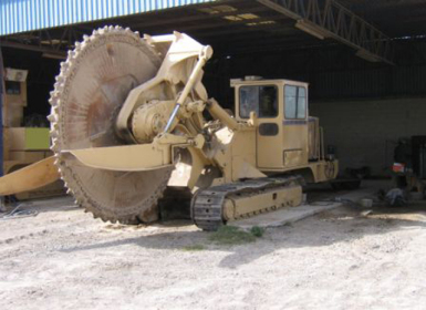

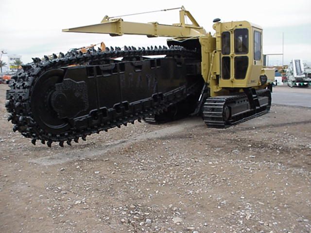

/ Would this be a good idea? #13
Hey Jarbill I found a couple of things no guy should be without. Either of these would do the trick for you. No worries!:D
Jim
