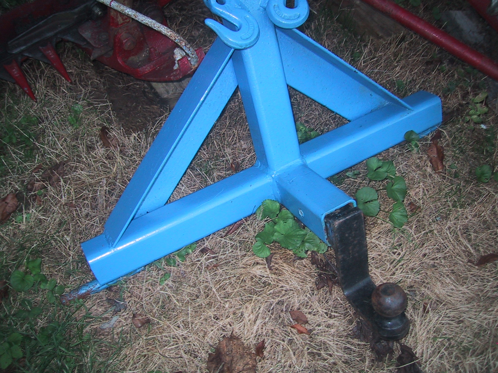

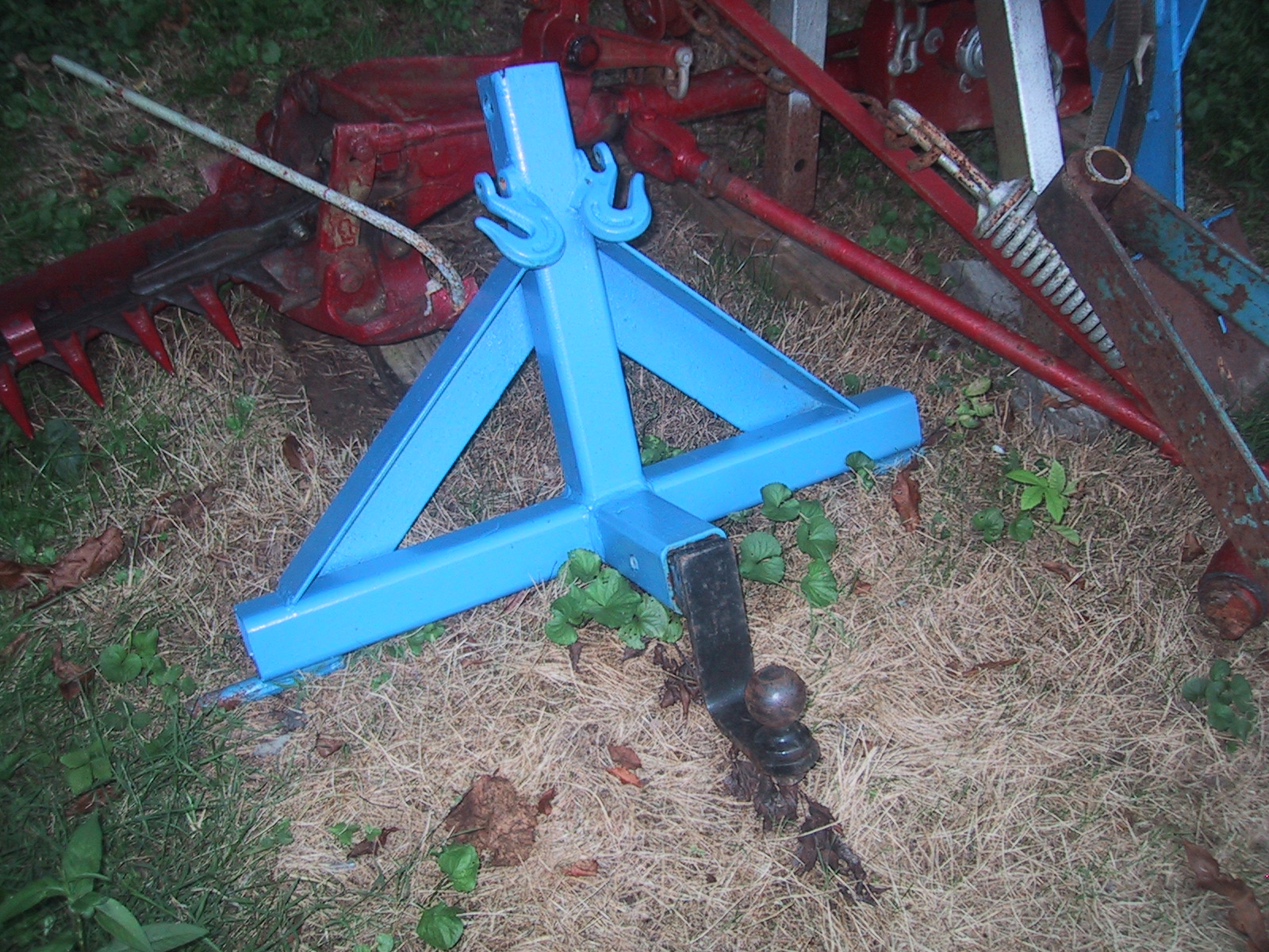

I use a Small homebrew adpator for a few things , like moving trailers around in yard, Moving small pallets, pulling logs out of woods, "but some times I cheat and use 350-B/ JD" .

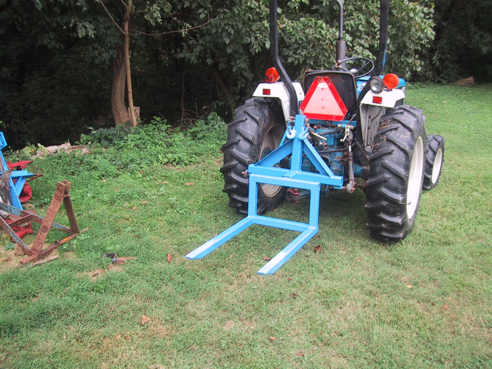

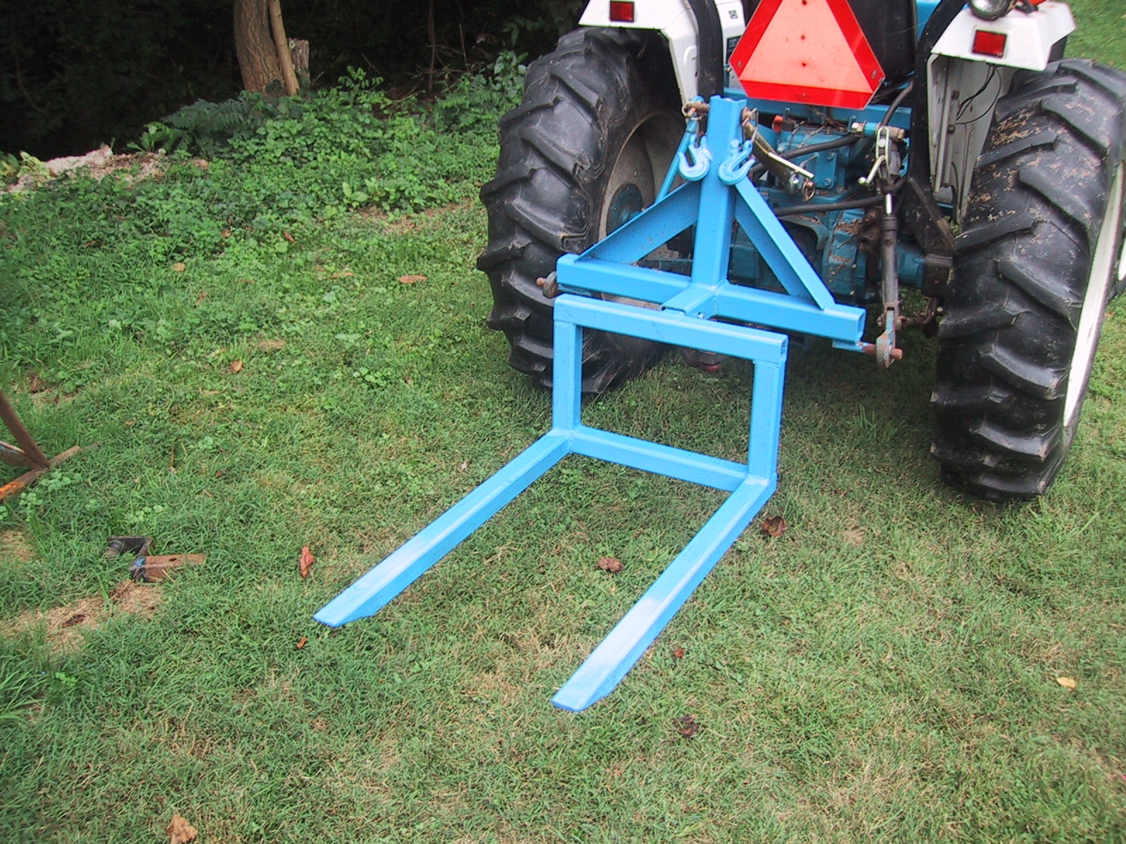

I really like the receiver pallet-forks.:)

Thanks! They are used for light loads since my tractor will only lift 1635 LBS I use half skids and sure are handy when moving something that I might have to move again. Made from 1 1/2" sqare tubing "note that you have to make long enough to reach ground & can't lift very high but is god for carring things".
