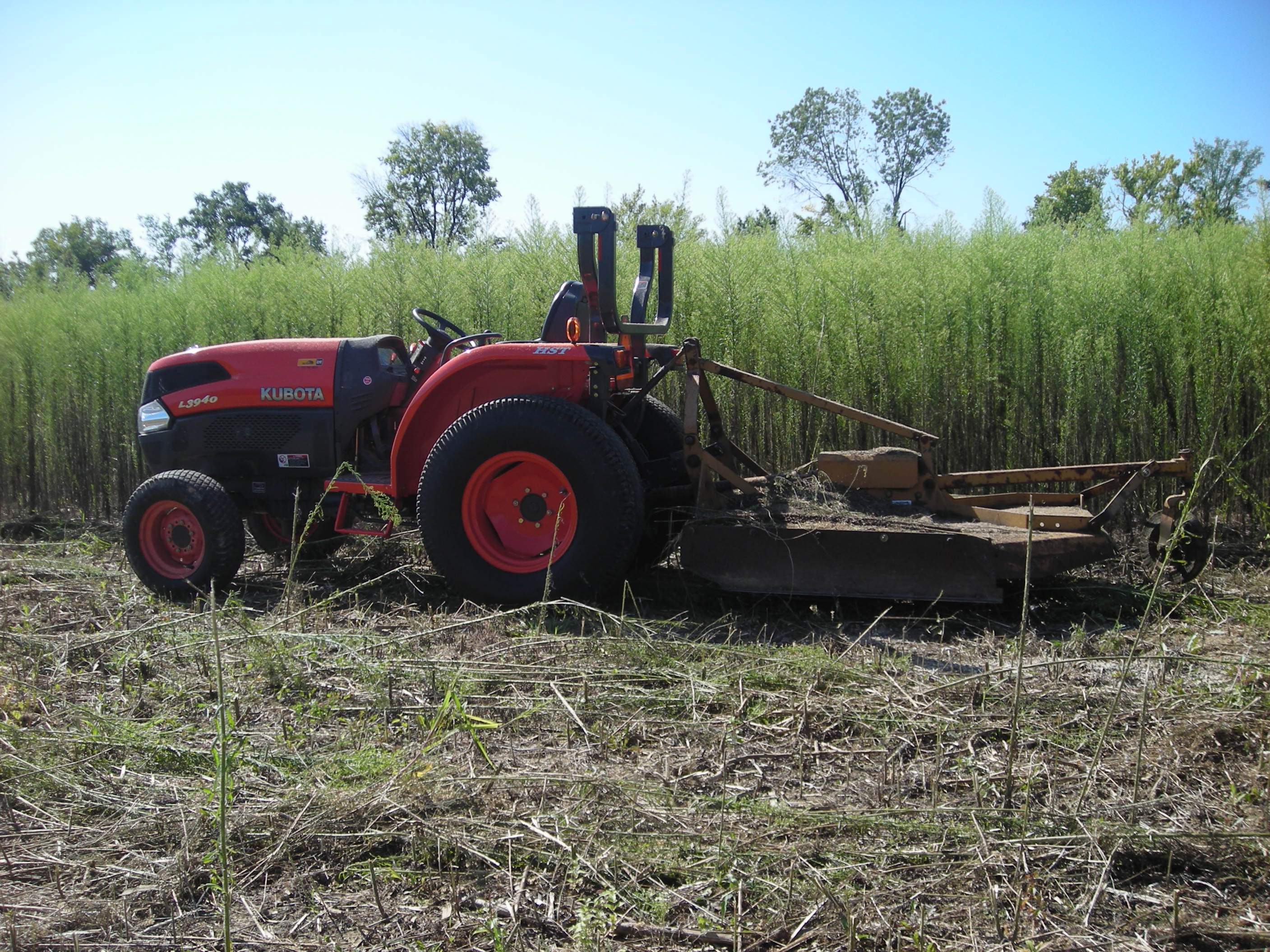

View attachment 305253Sounds like a good plan. I did not break my tractor in like I would have hoped to. I drove it from dealer to farm, about 5 miles, at full engine rpm, stopping every once in a while to vary rpm's. I let it idle while hooking up bush hog, then did this for 2 straight days in 80-90F ambient a 2650 engine rpm, only stopping to clear radiator screen and refuel. When finished, I had 18 hours and dumped oil. Philip.
