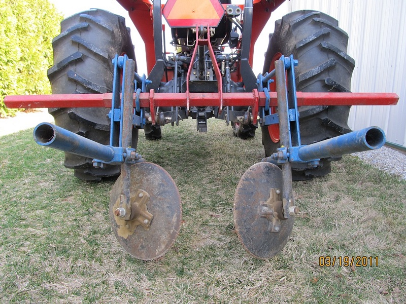

The one in the photo you show is a Ford model and I paid--get ready--$15 for one maybe six years ago. It is a solid toolbar so it now has a greater scrap value but I cut the bar down to --I think-- six feet and use it to clamp my one row corn planter to. It could be a good cultivator frame but those shanks float a lot with the ground so are only "good" and not "great" . It works good with a planter because there is room in the hitch arrangement to clamp the planter in. Here's a photo of it---at the bottom of this post--- set up with discs to use as a hiller.
