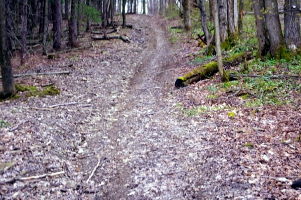

johnk said:
I have some pretty steep hills on my property and I was just wondering what kind of tractors you have and if you would attempt to go up this incline? Would you do it in forward or Reverse? I had my other tractor up here and I went in reverse with box blade and loader. It took quite a few tries and when I lost traction I would drop the box blade and head on down the hill. That would give me about 4 more feet of level ground and traction and I would proceed up once agin till I got to the top. Here's a few pics and I am Dying to try to go straight up it with my new tractor. Sure would save a lot of time but what if I lose traction and it veers sideways?? Would you or wouldn't you??
What we need to see the steepness of the hill is a picture taken across ( not up and down) the trail at the steepest point.
I mow hill that look that steep by driving backwards. I leased the same pasture one year and the tenant actually ran a baler sideways on that hill, yikes:eek:
To prevent rear rollovers you should drive backwards up and forwards down steep hills. If you do drive up the hill make sure that you have a good strong box blade or another implement that won't fold up if you start to roll backwards. Another way to cause a rear rollover is to brake hard while backing down a hill.
I like the idea of cutting a few switchbacks or just stick to the ATV.
Here is a link to a Rollover thread.
Good Luck, Marshall

Hey,,I started a thread over,[down] on pt,[power trac] section talking about them and hills,,guy on there gave me simple directions to figure out degree of slope,,about in middle of that thread, or you could probably do a search,,,,alls you need is a 4 ft straight stick/board or something thats ridgid and 4 ft long,,a yard stick and a level,,,,you can than tell degree of slope,,,20 degrees according to this way is pretty steep,,,but I drive tractor up it and drive 4wd truck up it,,,,
thats about the only way for showing others real slope,found that out.
To me that slope in picture just don't look that steep,,you can kinda tell by trees,,if it was real steep,those trees would show more of an angle looks to me like.
So if you wanta know if you can go up it as far as steepness,,,do that,,,,20 degrees and under you should have no problems,,,,now if its wet or got a layer of leaves you might spin,,but the steepness shouldn't be what gets you.
Also of course ag tires go better than turf or others,,,and if you got ag tires,they don't get real good traction backwards,,course we all knowed that,,just thought I'd through it in,,,,,
Check that thread out if you wanta know how to figure degree of slope,,it was a learning thing for me,,,,thingy

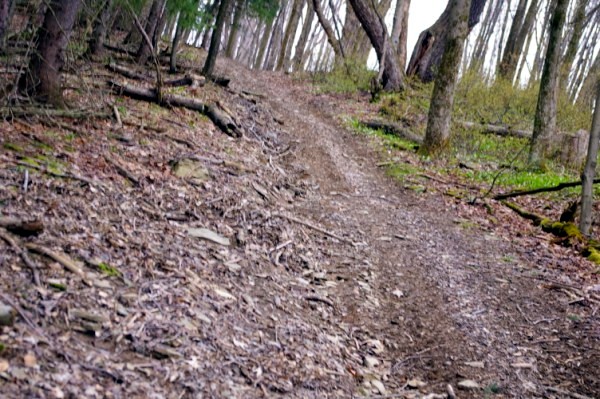

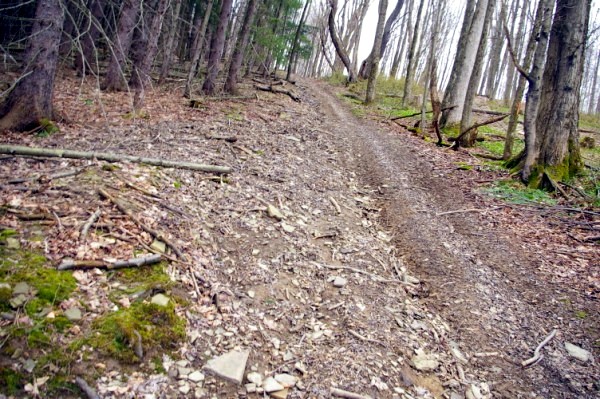

I was up there the last 2 days but didn't take my tractor up. I took some pics that show the grade and washed out sides a little better. I'll be backing the tractor up that sucker in a couple more weeks..The good news is the snow is gone. Planted 100 Black Walnut, 80 Austrian pine and 25 wild apple trees on the property admist the other trees. Lots of work but the grandkids will be happy..

Add rocks and boulders and you have my place, I drive all over it. Course rock crawling Jeeps is my hobby.

Yep. My biggest concern would be spinning due to lack of weight and consequently traction. If you can get traction so you don't side sideways, climbing it should be no problem. Keep the loader bucket down low, go slow, and go on up it without thinking twice about it... but only when the ground is dry enough that the tractor won't slide around. Loaded tires would really help here -- extra weight, and all of it on the ground, not up the air (like a ballast box) to change the center of gravity...
