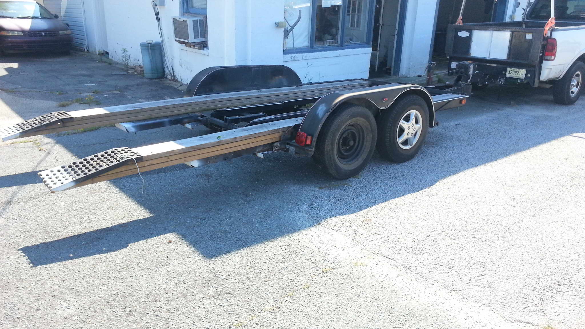

Would you haul anything on this trailer?
   / Would you haul anything on this trailer? #32
You use the bucket to shove down the hind end of the 2x10ramps then drive up until they flip back up. Stick on some red flags, chains, binders and off you go...
   / Would you haul anything on this trailer? #33
plenty of red flags come to mind hauling with that. ;)
   / Would you haul anything on this trailer? #34
Only huge oversized loads, unsecured of course, and with little or no weight over the tongue with the tires mixmatched and under inflated!:shocked:
BTW, the recxeiver hitch is for adding various other trailers behind the main trailer- DUH!:confused3:
Oh yeah, how much?
This is hilarious that only someone on here or like us would get !!
   / Would you haul anything on this trailer? #35
What? You mean this is not a normal trailer?:shocked::eek:
   / Would you haul anything on this trailer? #36
If you would, then it's for sale on CL!! How much weight can three 2x10's stacked onto each other hold at the end of the leverage point? I wouldn't want to try and find out. :confused2:
How much weight could 3 stacked 2x10's hold at the end of the leverage point? The entire weight of an automobile could be placed at the very end, however when loaded there will be zero weight at the end of the triple stacked 16 foot pressure treated SYP planks.
I pondered what is the purpose of the triple stacked lumber since a loading ramp extension could be easily accomplished with a single plank.
I think the triple stack is so the doors of the cars can open above the fenders.
Cripes, today's cars only weigh 3000-4000 pounds,
this trailer (although it is certainly a bastardlashup) is a perfectly safe and of adequate strength to accomplish the task. I wouldn't be afraid to haul a full sized pickup truck on it.
The only thing it needs is a light bar (w/ side markers) hung on the furthermost back end of the planks to make it street legal..
By comparison, look at the trailers that Lowes, TSC, etc. offer for sale, this ugly trailer is far and away stronger than the chintzy built crap trailers from Lowes.

The steel tread in the trailer at the beginning of the topic will also give one some strength near the ends of the planks. I agree that it looks funky, but I'm sure it does its job as long as the load is tied down well. It just needs lights closer the the back of the trailer, and perhaps flags on the ramps.

Would I use the trailer as it sits now? NO. But it does have a lot of potential to be converted into a nice trailer of some sort.
Look at the length of the trailer and then look at the balance point. There is a lot more wood sticking out behind the axles than in front of them. I think instead of having fold down ramps he had "stick straight out the back ramps". My FIL bought a trailer years ago that was built like this, although it was welded steel, not wood) to haul his riding mower on. He had 4 different properties to mow and his was a tilt back. When connected to the truck, tilt unlatched, nothing on the trailer, it stayed in a tilted position, slightly heavier in the rear. When you drove up on the trailer, the weight of the mower tilted it forward/down. You could tilt it down with two fingers, well balanced, but designed to stay tilted so you could drive up on it. It looked weird but worked great. I think this guy did a makeshift job of copying that design. Although his doesn't look like a tilt but by raising the front it would tilt. Makeshift job for sure but it worked for him.
