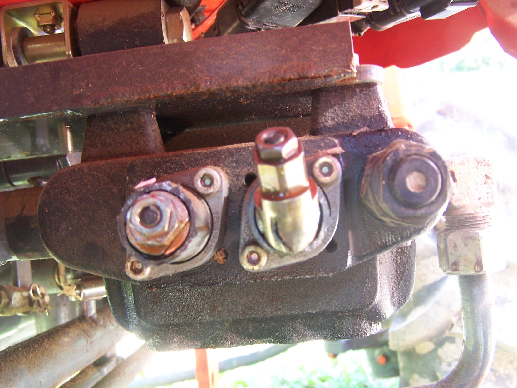

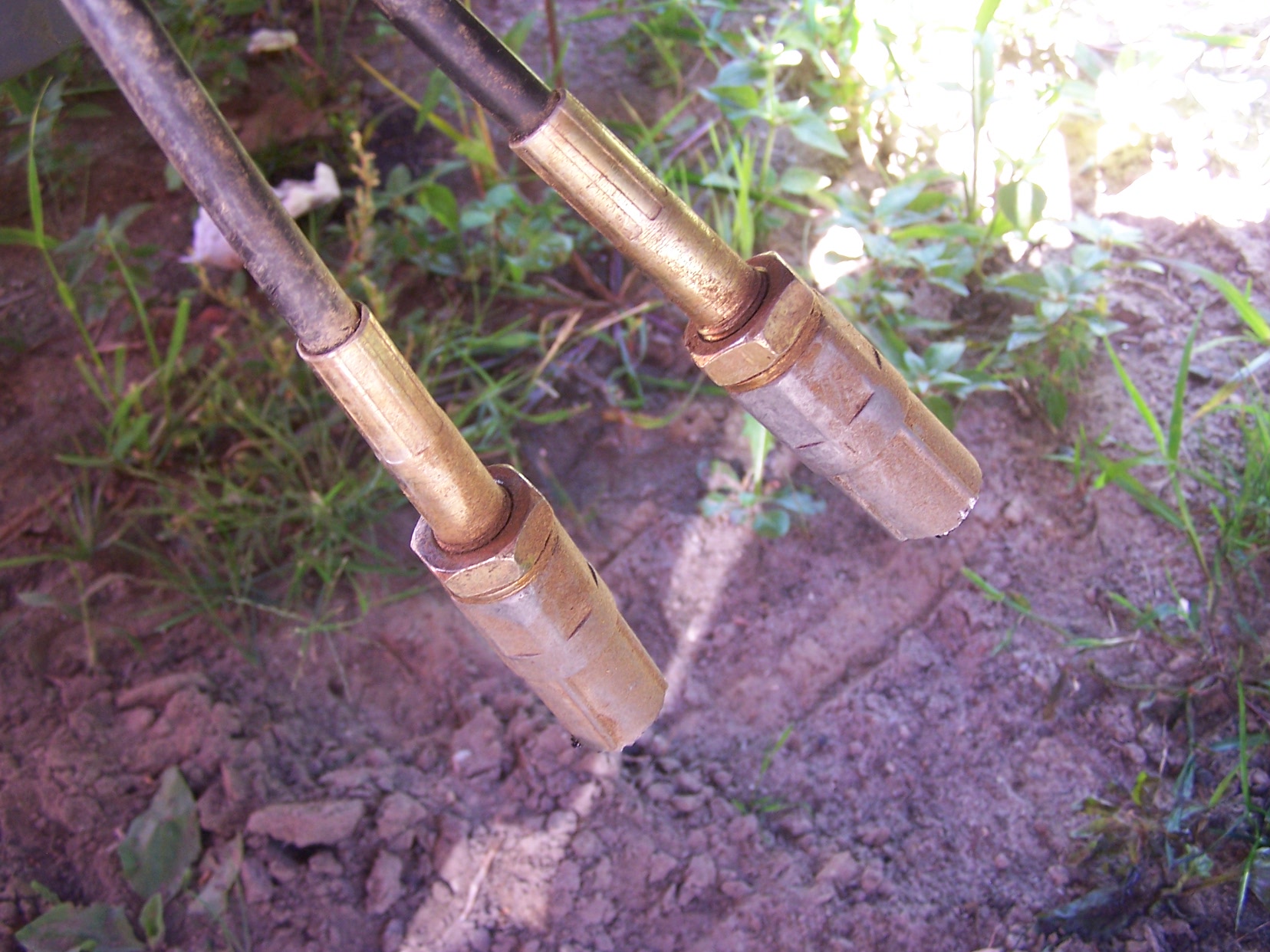

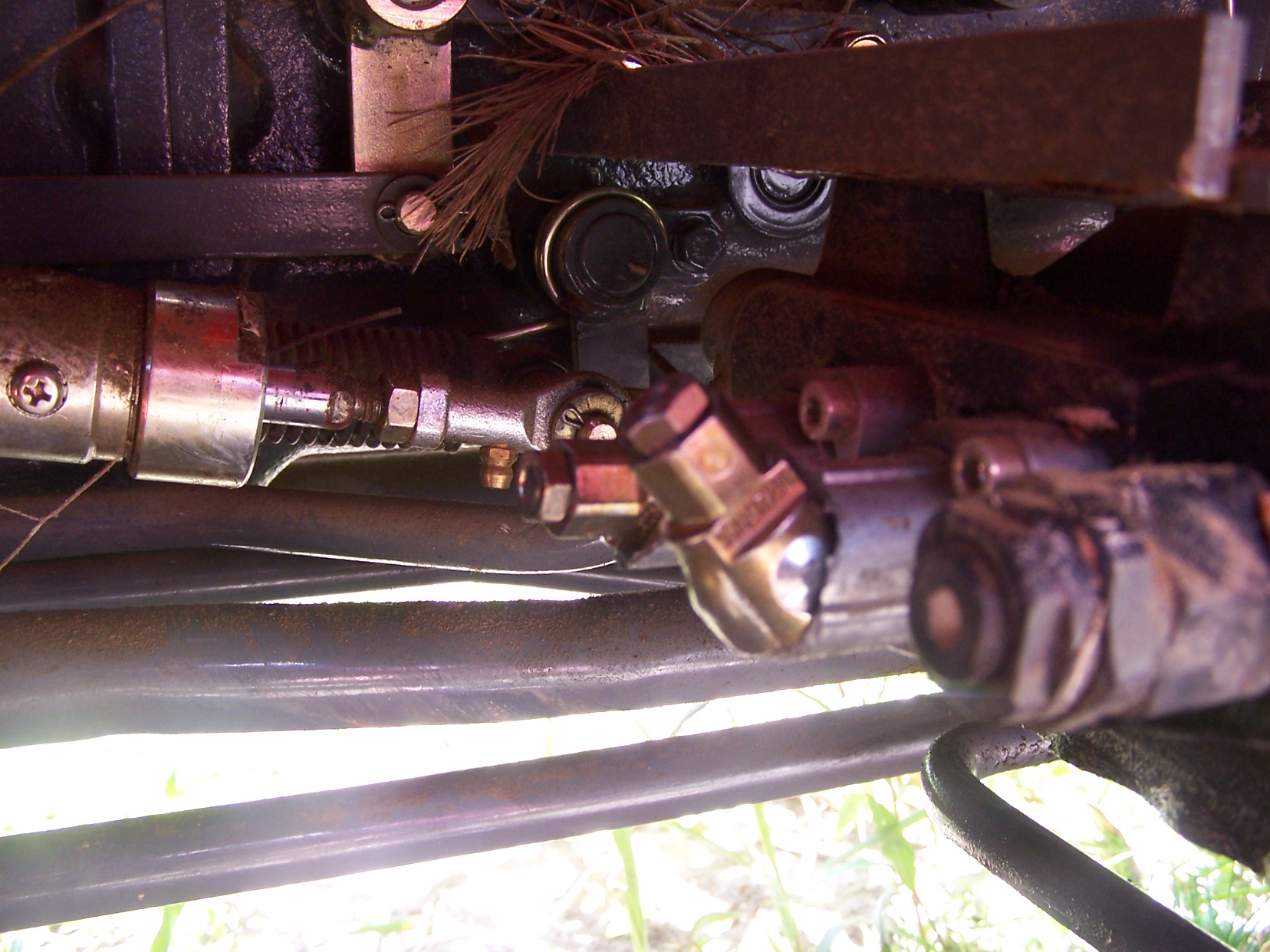

Long story, but I need to fix my hoses and valve for my loader for my CK25HST. Not sure exactly what I need, so I'm looking for help/parts.
I have attached some pics, hopefully they tell the story well. Do I need new hoses, and can I replace the couplings?
Please bear with me, it's my first tractor repair.
Thanks in advance/Kevin

I'm gonna say check with your dealer as those parts are probably sourced from Korea when the tractor was designed. You might get lucky and find someone here who recognizes them though. It looks as though you need the cable assemblies and part of the valve that looks replaceable.

I got some bad news for you.....
That is not a hose, that is the cable in which you control you valve with.
I will be in the office tomorrow and I will look up the parts and let you know how bad it will hurt, if you plan on making the repair yourself we can asist you with a parts break down.

Rick, thanks for speaking with me on this yesterday.
The parts diagram you faxed me was perfect, and you were correct, I need both cables and both housings.
I will call you to place the order.
Thanks again for the help/Kevin

I had the bucket fully raised, pushing against a tree, trying to knock it down for my food plot. It was leaning but would'nt go over. Back uo to get a little momentum, and when I hit the tree it went over, tractor rode up on the base of the tree, and of course the base kicked up, breaking the 2 housings and cables.
No problem getting it home, the bucket was just stuck in the full up position.
