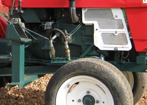

I took possession of my father's 336D when he downsized off their farm. I have been maintaining it myself, but ran into a problem when I wanted to run it without the Great Plains loader that he had put on. He had to install a hydraulic diverter (I guess) because the tractor did not have any auxiliary hydraulic sites. Rather than cap them off and back out a bolt blocking the flow, I put on quick attach valves and a short hydraulic line connecting the "in" to the "out".

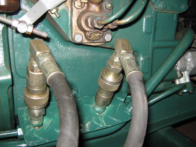

You reconnection of the hyraulic flow line is exactly how I setup mine, so I can also run my tractor without its FEL.
a short loop line with Quick disconnects sure makes it easy to do,

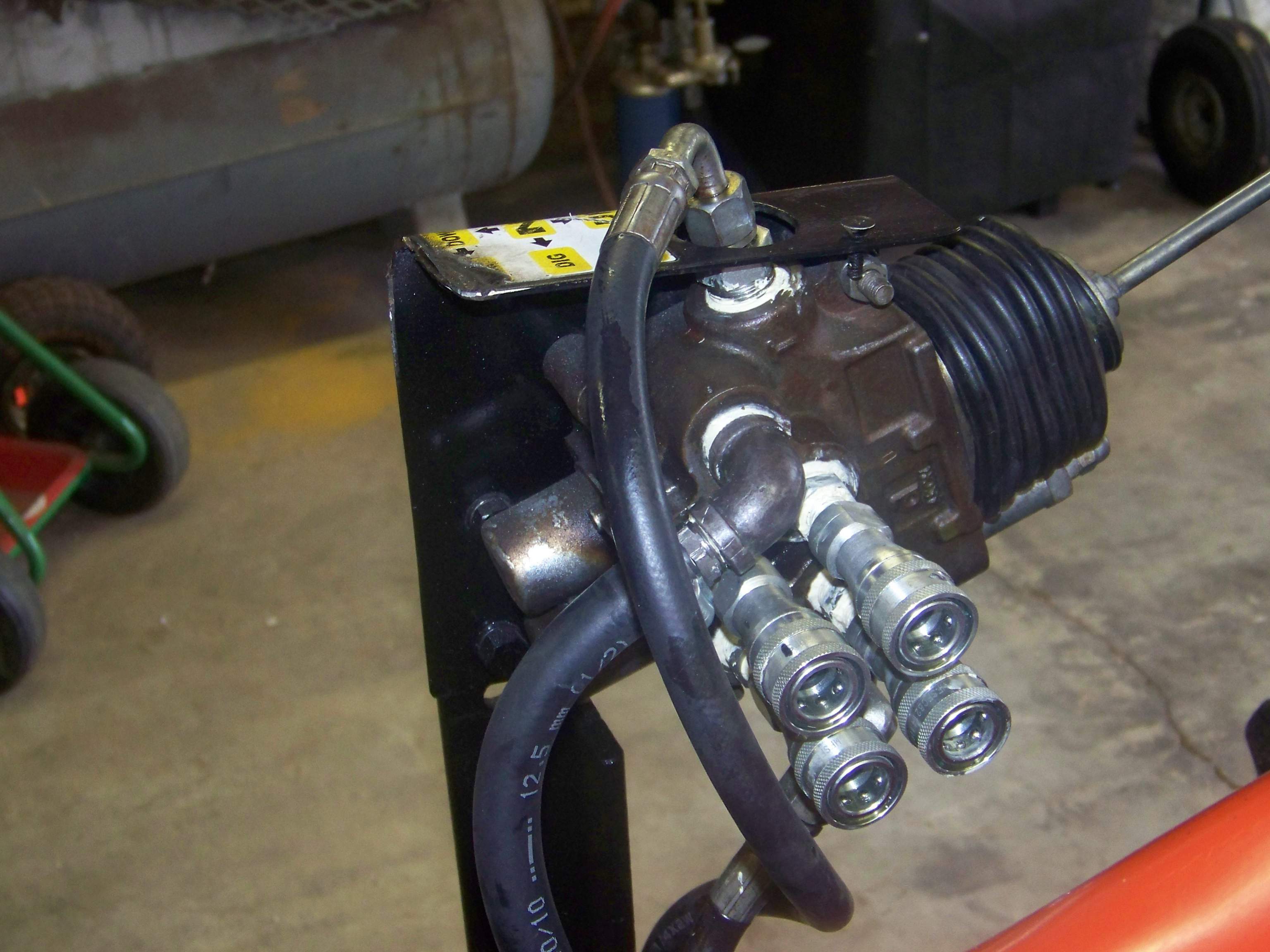

I had mine like yours deepNdirt and JJ mentioned if one of your quick connects is not plugged in good or comes undone for whatever reason you could stand a chance of dead heading your pump. Therefore I mounted the loader control valve on the tractor and put the quick disconnects on the loader lines.
Also allows you to use the loader valve for another hydraulic implement if needed.
