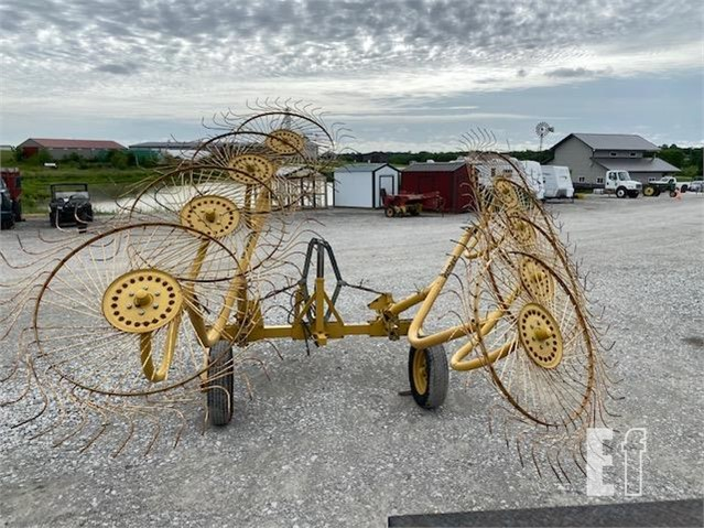

The Vermeer wr 20 is a smaller frame wheel rake is why I asked. Most of the newer ones I have seen have a much larger frame. It also uses a single cylinder to raise and lower both sides.
No way to raise or lower each side individually.
this isn't it but similar

note the single cylinder . It appears you can let one side down manually with a turn buckle

I have a different brand that's set up a little different, but it also uses a single cylinder. I can pull a pin and disconnect either side from the cylinder. I've only needed to do this once when a friend wrapped one arm around a tree, but it's simple to operate only one side.
I suspect that one is the same as far as being able to disengage either arm.
