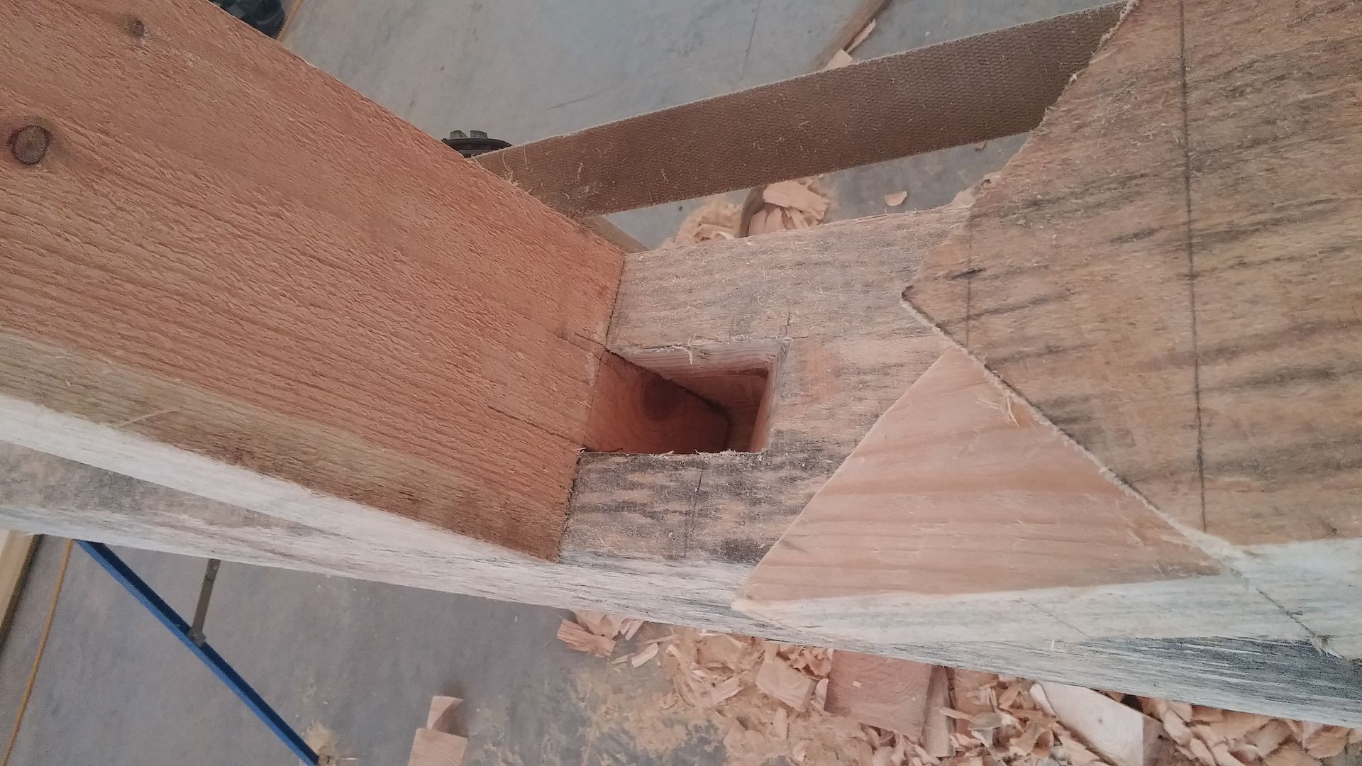

Well still trying to wrap this up. The lady is pregnant with twins and due in Dec. Her husbands business is balls to the walls and I'm trying to help them get the interior finished. A few pictures of the front porch mortise and tenon work.
   / Wrapping up another pole building
#19
The posts on the front porch are 8x8 western cedar and I trimed the bottom and top with 2x8 cedar. Need to get some newer pictures. Hopefully we'll have temporary power this week. UGH!

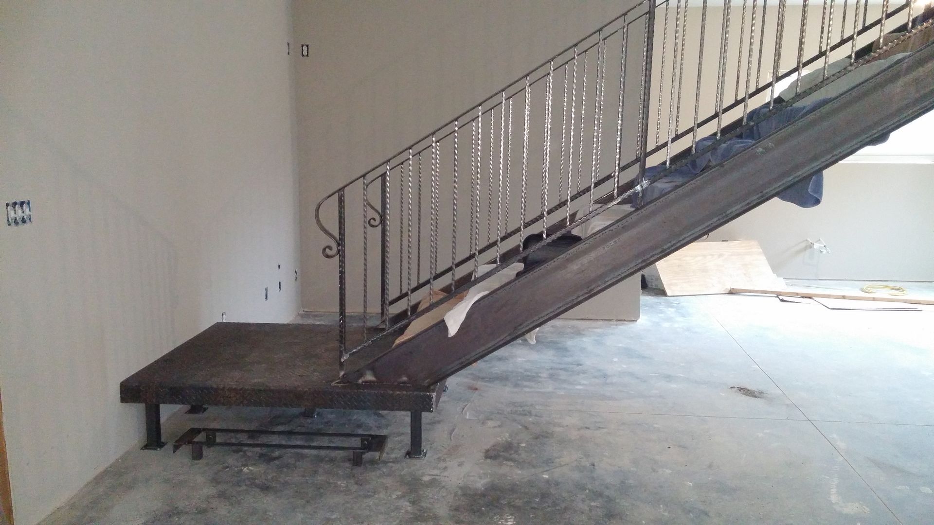

Some pictures of the stairs. I used 4"x12" red oak for the treads.
   / Wrapping up another pole building #20
Where do you buy 4x12 oak? I can get 8x8 cedar easily enough, but I've never seen oak in that size available anywhere!!!!
