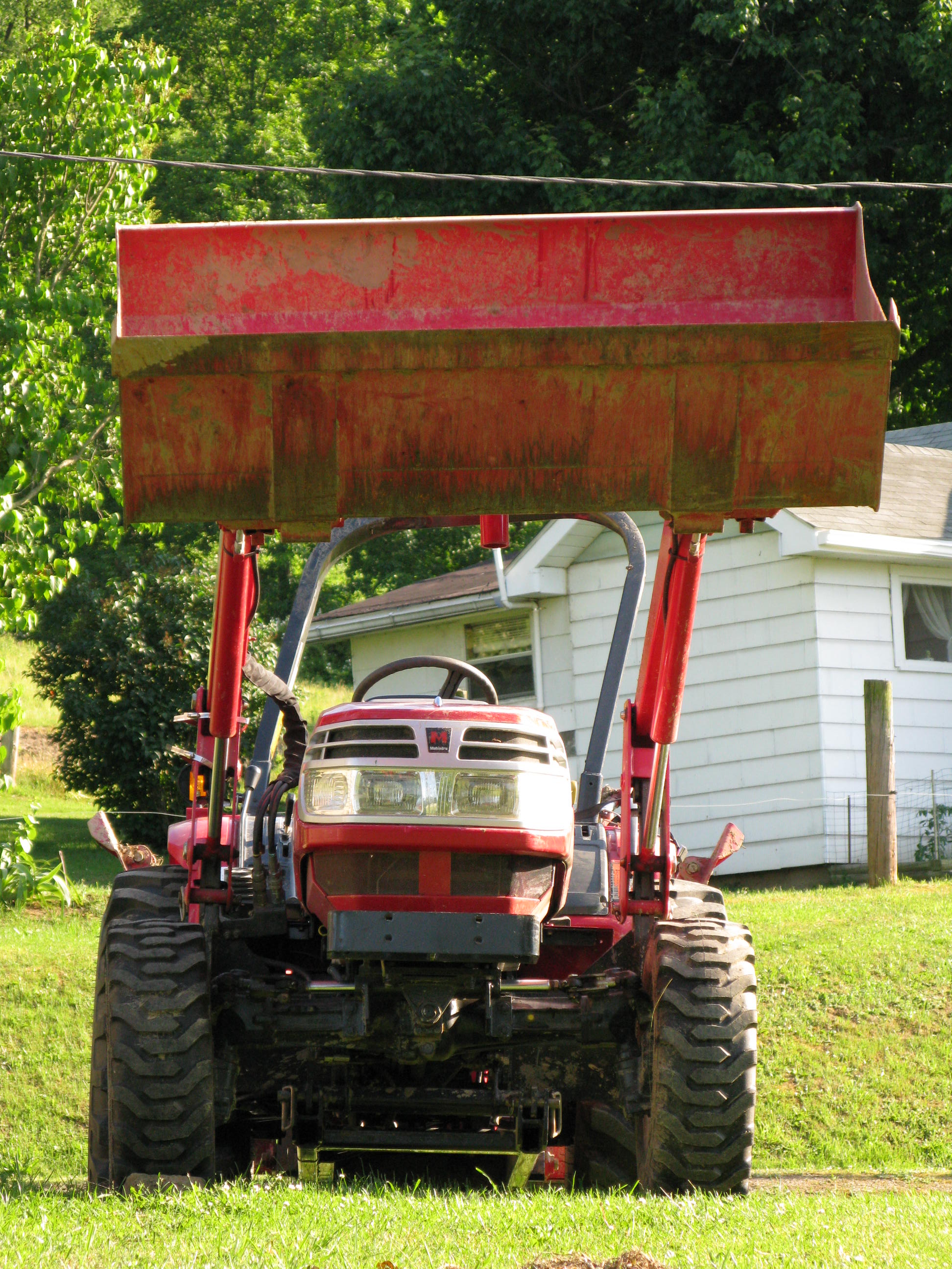

Last Sunday I had the misfortune of riding my 3215 (that I purchased on Easter weekend and which only had 80 hours) over a ten-foot high embankment into a field stream. I was using the bucket of my unit to haul fence posts around the property as I put them in with a sledge. I was running parallel to the drop off, about 8-feet back from the edge, when I decided to turn around and head back. The area above the embankment had approximately a 10-degee down slope leading up to the drop off.
I began to reverse my direction and back up the slope until I was almost exactly perpendicular to the edge. At almost the exact instant I got perpendicular, the wheels broke loose. The ground was covered with pine needles which acted like marbles. My R4 tires couldn't get traction. So, although I was in reverse, and the wheels were turning in reverse, the tractor began lurching forward. Oh, and I was in High range....and the 4-wheel-drive was off.
As stated before, I was about 8-feet back from the edge. Well, when I went to slam on the brake, my foot caught both the brake AND the gas! On many HST models (regardless of the make) the gas is right in front of the brake. As I found out, this isn't the best location when one is panicked and looking for the brake.
By now, I was only a couple feet from the edge. With foot on the brake and not on the gas, I tried to turn the wheel hard to the left. However, due to the weight of the machine and the terrain, the tractor wasn't turning. Rather, the unit just kept lurching forward.
Lastly, I tried to drop the loader. However, there just wasn't enough time for the hydraulics to respond.
With the front tires already going over the edge, I thought, "Well...this is it."
The tractor and I rolled and flipped our way to the bottom. At some point I came free (wasn't wearing a seat belt). I remembered looking over my shoulder and seeing the tractor stand up. I was able to throw myself forward before it came back down. However, when the unit did come back down, the left rear tire rolled over my right leg, pushing it down into the mud of the stream, and effectively trapping me under it.
My wife, who saw the whole situation unfold, was able to get her grandfather to come down with another tractor and lift my 3215 off me.
Although I was able to walk away, I did end up spending two days in the hospital with a severely fractured wrist.
Reality set in when I contacted my insurance company a few days later to report the loss. Some other guy the week before rolled over the exact same unit, except he didn't walk away.
I wanted to share this experience with the forum just to remind folks how dangerous these machines can be. Don't ever forget to respect these machines.
Going forward, my bones will heal, my dealer will help me fix my machine, and I'll certainly count my blessings more than I count my problems.

Glad to hear you're okay. As you note, could've been much worse.
Looking at the picture you included it is pretty impressive that the ROPS bent but didn't collapse. I expect the ROPS to work when one rolls over but your description sounds like a hard fall quite a ways down.
After reading this and other stories, this new tractor owner is thinking 4WD should be engaged near any hill and the FEL should be as low as practical at all times. I know that's what the safety brochure says - time to start making it a habit.

Whew, close one Farmer. I have a hard time with the obligatory seat belt recommendation. I certainly suppose in many instances, the seat belt can be helpful in saving one's skin. Just not all instances. If I had one on the day I side flipped my JD., I would of cracked my skull open from the force of the side impact as the tractor hit the ground. Instead I was tossed off the tractor as it was going over and actually landed on my feet. We had a guy drown around here in a shallow stream gully about 10 years ago. He had his seat belt on while mowing near the 5' embankment over the gully. It gave way and tossed and rolled his machine into the gully. They surmise he was knocked unconscious at impact. Had he not been tied to his machine, he may have survived. I guess it is for us to judge our particular circumstance as to whether or not a seat belt is warranted instead of always obliging to a blanket statement no matter what or how we are using our machines. The way you describe your accident, do you feel you would have benefited more with the belt on?. Thank you much for bringing this to light and glad you were not severely injured.

It won't help you any for what has already happened, but for others and for you in the future, if 4wd is engaged, the brakes will stop the front tires as well as the rears. It is a huge help in such situations.

How scary. Your tractor looks identical, well, less the slight lean to the left, as mine. It's like this happened to mine.
