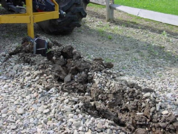

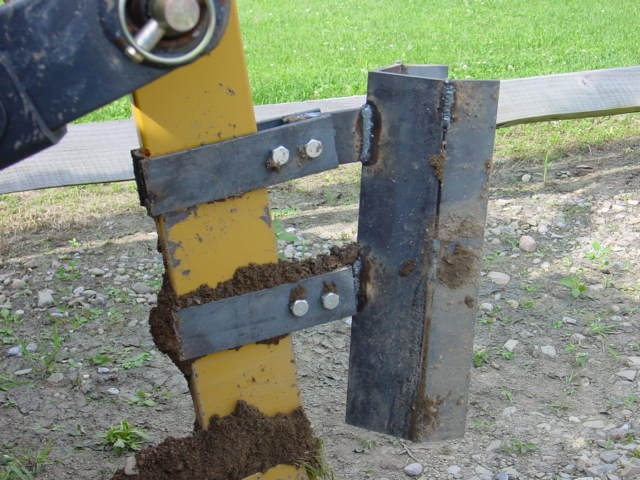

I just got my angle iron and flat bar anyway, so this evening I hope to find out if my jig works or not.

Here's a few pics of my doohicky.
It works a lot better than just the subsoiler alone, but the trench still needs cleaned out. I guess that's why plow blades and middle busters have to rolls to their blades, to get the dirt up and out of the trench. I angled my homemade device thinking that it would lift the dirt out of the trench, but it doesn't noticeably. I also attached the legs to the angle iron so they would press flat against the walls of the trench, thinking that it would sompact the dirt and hold it from falling back in, but again, not noticeably. It WOULD give me a nice leading edge should I decide to attach the pipe to it and drag it under as suggested. It also works better on my gravel drive as opposed to grass because the sod still folds back in.
But like I said, it makes the subsoiler work better than it did yesterday.

another.
I made the brackets so they can stay on and be used to clamp conduit onto if I'm just burying wire or cable
