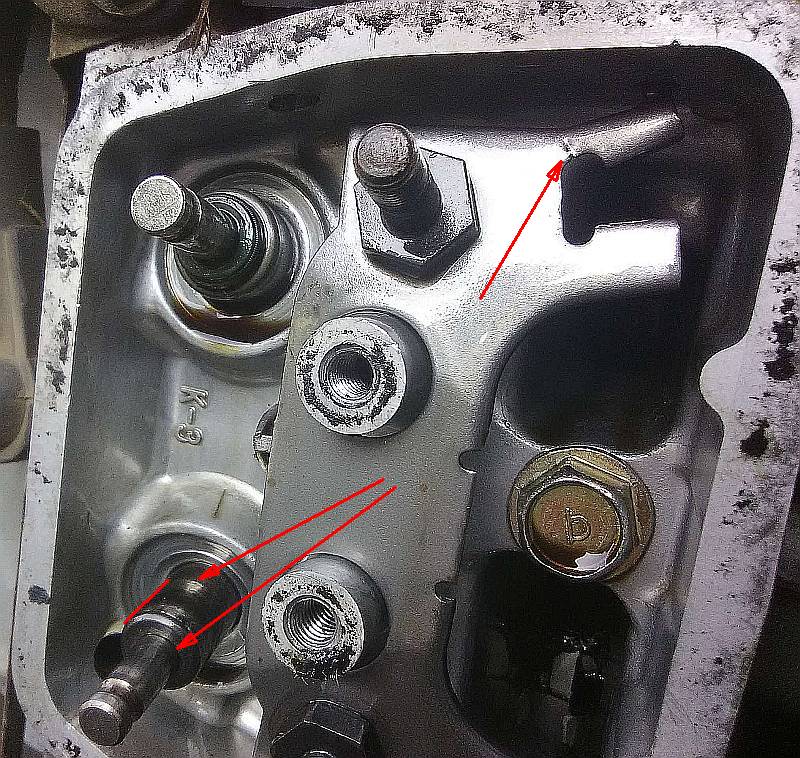

   / X-300 keeps bending Push Rods.
#11
Upper Push Rod was not bent, but it was laying loose. Note the bend/crack in the Guide Plate. This is a new Guide Plate by a few months, replaced because the same tab was broken off, but at the bottom of the plate (the other Push Rod), not the top.
Lower valve guide is out quite a bit further than on the right side valves and it looks like the upper is out a bit too. I'm using upper and lower because I don't know any other terms for them. Exhaust? Compression?
Question is, what do I do about them? Can they just be driven back in using a small diameter socket as a means of keeping even pressure? Then, how far in? Is there a stop they hit against? Sure don't want to seat them too far.
   / X-300 keeps bending Push Rods. #12
Bear in mind that the intake valve has the seal which makes the guide appear longer. The correct thing to do here is replace the head. It would be tough to knurl a hardened guide whilst it is in the head. You could try with something small, hard and sharp to mar the guide. Drive it back and stake it like you would a valve seat. The precise distance isn't really necessary. Look at a pic of a new head. Or look at the other head. You would want to anyways. As a general rule, the guides protrude closely to one another- but it isn't always the case. I don't THINK the manual gives specs on the positioning. I could be wrong. I've heard of guys drive the guide back into place and put a tack weld to keep it from pulling through. Certainly not worth it if you have to pull the head. On a side note I had a head last year that the guide did drift in towards the head of the valve - keeping it open. Only one I recall.
