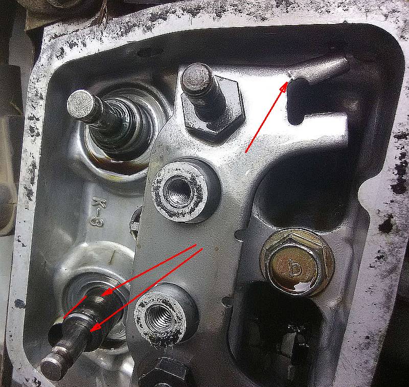

I drove it back down without much force. A socket and a few gentle hammer taps. With not many other economical (OK cheap) options, I decided to goop around it with JB Weld metal mender and let it set up for a couple of days. Went back at it this morning and put it together. The spring, retainer and keepers weren't as bad as I was expecting. Set the gap/clearance on all four valves. Closed it all up and turned the key.
Surprising it started fairly easily considering it had been setting open to the air for a week or more. Idles better and runs smoother. Ran it around the yard a bit, but didn't tackle the hills. It shut off without spitting and coughing like it had been, then started back up again without trouble and shut off smooth again.
Jury is still out. I'm not sure if I expect the JB Weld to hold or not, but if it doesn't, I may be slightly more inclined to try a head if I can find one for less than a small fortune.

It's not clear to me where you put the JB. I would be concerned about some of the JB coming loose and getting in the cylinder.
I can't really find a picture detailed enough to mark up, but basically formed a collar around the valve guide at the point it passes through the head.
I thought about that. But with the age and hours of the engine and my state of mind, about ready to give up on a lot of things, I'm not sure I really care. If it runs, it runs. If it doesn't, well, we'll see how I feel then. Right now, I feel like crap and don't really care about too much of this kind of thing.

I'm assuming it's on the oil side of the head and not the piston side? Most likely the worst thing that will happen is it starts to come back out again. At least you know what the problem is and can decide what it's worth. It could be worth more as parts if the rear transaxle is working well.

Just inside the OHV cover, accessible by two 10MM bolts from the outside of the engine, so I'll guess that's what you mean by 'oil side'. Ran it another hour or so today, total of about five hours since the 'repair'. Still running smooth and strong.

I n the automotive world, there were heads that dropped the valve seats. We would put the seats back in and use a center punch in the AL head to force the press fit again. Might be an option for you if you have to re-fix it. There are some GM heads out there that the valve stem guides go thru the water jacket so the corrode and come loose. Those can be fixed with hi temp Loctite type products. Next time, I would pull it all the way out, then use green Loctite and press in. Should never move again.

If it happens again, nick the overexposed part of the guide a little with a knife file in many places. Then apply a HT green Loctite to it and drive it back proper. Get the head warm with a heater for about a day to ensure it has cured before use. Hopefully the cam hasnt been worn too much fighting that valve guide.

I tried the punch/detent bit. Due to the shape of it all and my angle of attack, I couldn't get a good shot at it. I'm not mech-i-nickle enough to pull it all apart to do it any other way.

Four and a half years later, still starts easy and runs smooth.
