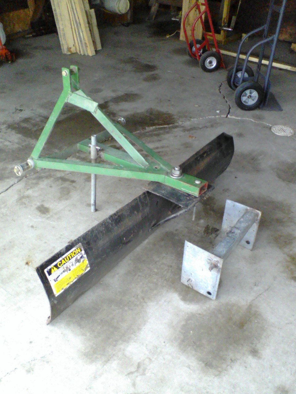

Hey fellas, been plowing with my x475 with the 54" quick hitch front blade for quite some time now and the smaller snows i always wished for a wider blade, but on the heavy snow the 2wd tractor didnt push it well. But now, Im recently a new owner of a brand new John deere X738 with 4wd!!!!!! so I was wondering if there is a larger blade they make for these now? 62" would be nice, a 70" may be too big but just trying to cut down on my time. thanks for your help!
I wished that for a long time and finally made my own. I had a 5' blade for the 3 point hitch. I can take off the hitch and bolt on this metal thing in the pic that I made. It then fits right on the front quick hitch. I have to use care with it because there are no springs to trip with, so it could do some damage if I got to ramming around with it.
I don't use it any more, to bad you aren't closer, it needs a new home.
