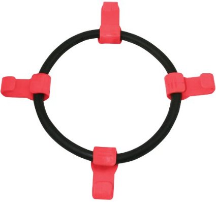

Hey Gearz, the O-ring chain tensioners I found on Amazon I believe. They are made from ~1/4" round neoprene and about 8" in diameter. Mine came with four hooks to secure them to the chains. Some people use bungee cords to do the same thing. but these O-rings I think work better and provide a lot more tension.
Search Amazon for
Security Chain Company QG20030 Quik Grip Small Tire Traction Chain Rubber Tightener
Less than $10 for a pair of them IIRC.
Yes, I had to do the same on my x534 with the steering travel limit stops. I never moved them back as I said as I didn't notice much lose in turning radius.

Hi Sparc thank you for taking the time to post this message/picture and useful information. I found the security chain tighteners on Amazon and will definitely order them. I really like my new tractor and hope it's my last one.

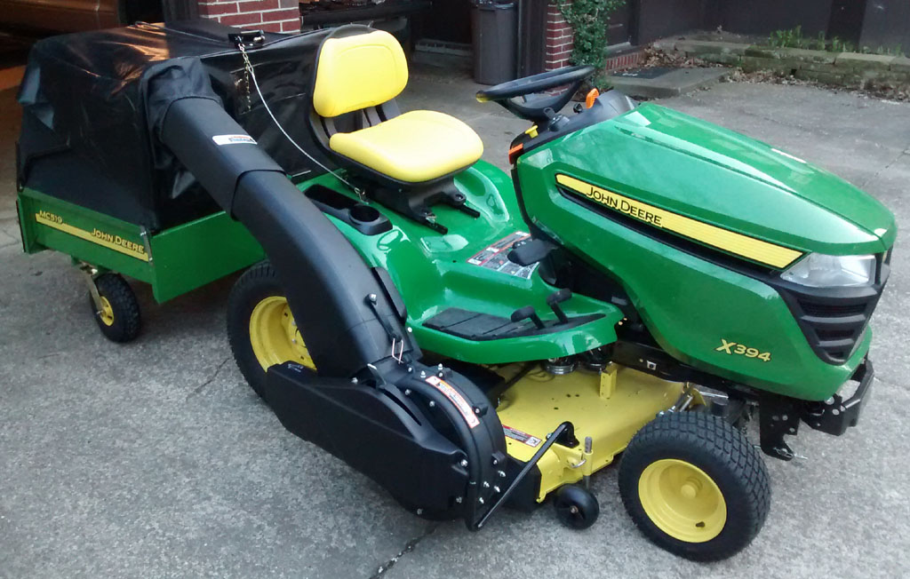

Took delivery of my X394 back in April. What a great machine! I have about 30 hours on it so far and very few complaints. I still have a slight nagging feeling that I should have gone with the x500, but honestly the 394 has done everything I've asked it to do without breaking a sweat. One of my worries was that I would have slippage on the hill but this has not been a problem whatsoever, even when the ground was wet. I purchased the MC519 cart along with it, mainly for leaf pickup in the Fall. I ended up buying the 7 bushel bagger later on, as I found that the cart reduced maneuverability a bit with the all wheel steering. Speaking of AWS, I'm so glad I got this feature and I don't think I'd buy another tractor without it. Swinging around trees and sharp corners is a breeze. The power steering is great too, but I find the hydraulic deck lift to be unnecessary and even cumbersome at times (like when you're trying to level the deck--you have to have the engine running to raise it). I agree with deathtoblackberries comment about the hydrostatic in reverse--it's like hitting a brick wall when you let off the pedal. (I'm wondering--do the x500 models have this issue also?) I recently purchased a pull-behind dethatcher and aerator so I'll be doing my first non-mowing work this week in preparation for overseeding. Thanks to everyone for your comments on my thread.
