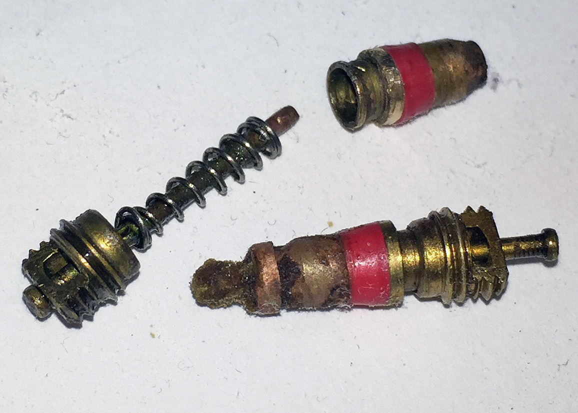

Maybe none sell it by the gallon, and only pump it into the customers tires.
So far, I've used WW fluid.. which is a little less weight than the beet juice.
Be careful. Rim Guard (beet juice) can corrode your valve stem cores. Below is a photo of the valve stem cores from my 2720 front tires which had Rim Gaurd in them. The one stem was so corroded that it broke in half while trying to remove it. Meanwhile, my rear tires are filled with washer fluid and I've no issues with them.
