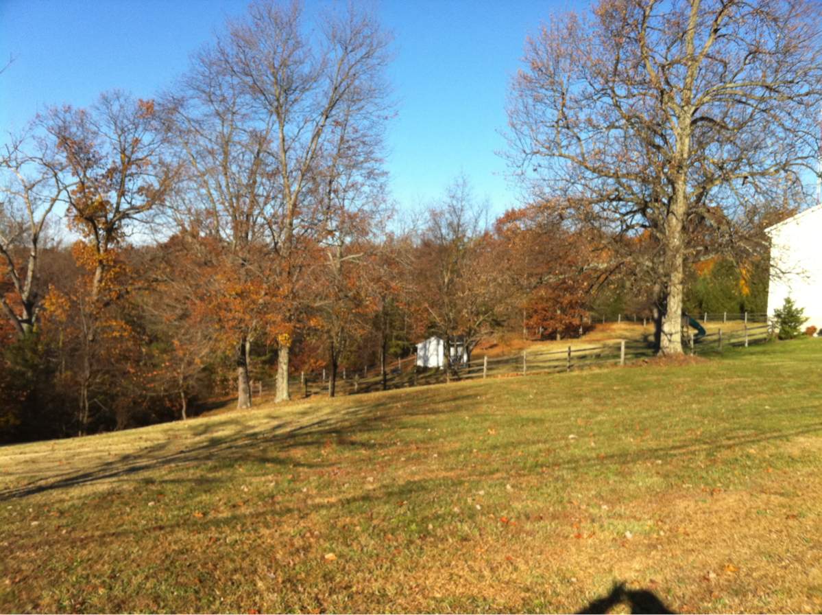

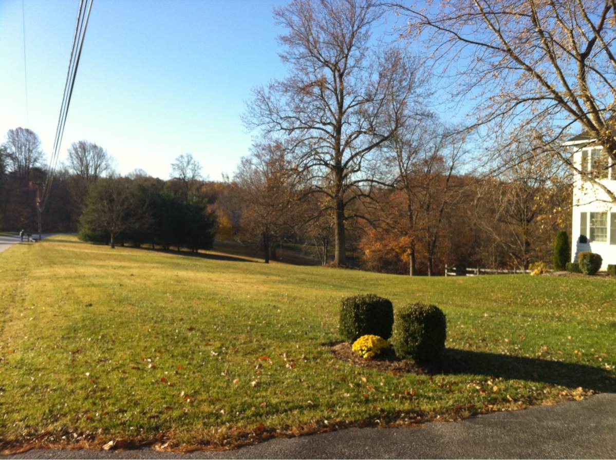

Is the 340 really made to push snow and haul mulch and wood etc? I clearly found out my 120 was not. I really need to take some pictures of my property and let you all tell me if you think I really "need" the 500.
   / X340 or X500 #19
That would be helpful. The 300 series, especially the top numbered ones, can do snow removal and pull carts fine, probably not as well as a 500 but acceptably well. I do not think you would have much problem, but again I speak of my favorite 300 series the X 360.
John M
   / X340 or X500
#20
Pics of my yard. I'm trying this from my iPhone so let's see if it works. I have 2+ acres of cuttable grass.
