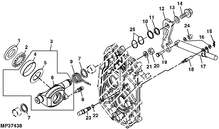

Do you know how to make adjustments to the pedals?
First make sure the pedals are free, no binding of the linkage.
Then I would adjust the neutral (only if tractor creeps without a pedal being pushed). There is a nut on the right side of the transaxle (key 20). Loosen it to turn the key 23, which is an eccentric.
To do the above adjustment, you have to have the rear wheels off the ground, free to turn, on jack stands. Jumper the seat switch, and have the engine idling. If the wheels are turning, loosen nut 20 and turn 23 until wheels stop rotating, then tighten nut 20

Yep, still have it. Pages 345 thru 348 address hydrostatic pedal control linkage adjustment. PM sent. Thks
