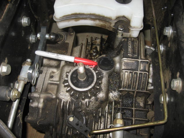

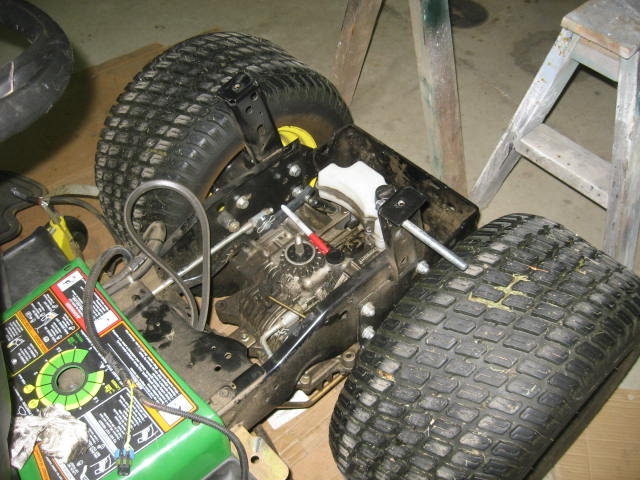

Finally getting to this; good winter project.

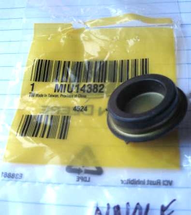

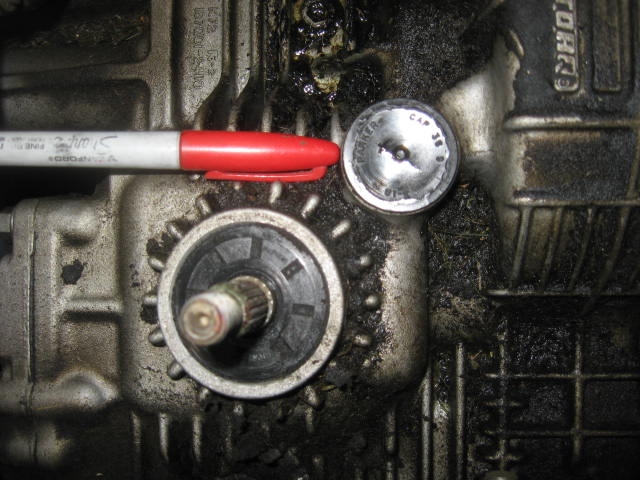

Turns out it isn’t the shaft end seal, rather the small (1 3/8 dia or so) rubber plug located on the cases’ top side. (see red pen tip) Rubber is cracked, fluid had the appearance of oozing from the cracks, but at 20 degrees not a lot of oozing to be done, at least quickly. Seems like an odd design for a plug.....
Looked at both JD and Tuff Torque site. From pictures of the replacement parts I’m assuming its a press in? Anyone replace and use either the Deere or TT part and care to evaluate?
Access was indeed pretty straightforward. Bolts/seat switch harness removed as suggested above. For anyone else doing this, you’ll need to unload the drive belt tension by removing its spring. Impact wrench on fan nut will release it and the pulley. Also need to remove two fuel hoses from tank fittings.

That's the official fill plug. It will just pop out with a sharp chisel. Underneath may be a magnet that when lifted out could point to the overall health of your T/A. This would be a great time to change the fluid. Tuff Torq has an updated fluid recommendation. I use 15W50 synthetic, dunno if you you do snow work with this if they still recommend low vis. or not.

One important step in the re-assembly is greasing the input shaft splines! (prolly too late for OP being Sept) The input sheave/shaft joint will 'fret' (micro-motions that create the characteristic red oxides that erode the joint). The factory applies grease to the splines to slow their growth. If not serviced, the input sheave will fret and eventually strip out at about 400 hrs (it is softer than the transaxle shaft). I re-grease this input shaft every 200hrs at the transaxle oil service.... some fretting is present then.

I’m equal distance (35miles) from two Deere dealers, both had item in stock and picked up yesterday. Need to clean outer cases before removing the old plug.
When disassembling noticed the input pulley had provision to attach a puller (two 180 degree spaced threaded holes) but none was needed. Will take a close look at condition of input shaft teeth, thanks. Unit has about 170 hour.
Interesting design with the expansion tank located above the transmission. Would seem to guarantee a leak/seep if the plug cracks like this one did, at least if the expansion tank is filled above the minimum line. When previously changing the transmission fluid I re filled thru the expansion tank; thus the original plug aged to the point of plastic failure. Looks like that was a bad plan......
