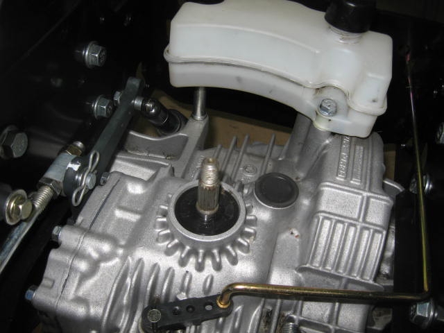

New plug is in, filled. Plug I removed was the early style, all rubber top. With any luck the replacement will hold up longer.
I have a range of grease/lube available to coat the input shaft with; High pressure, low pressure, high and low temp, brake lube, moly assembly lube, anti seize. What would you recommend?
Here's an after shot, nice and clean, non leaking plug (hopefully) installed

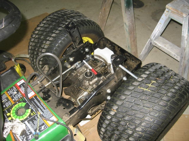

Finally getting to this; good winter project.

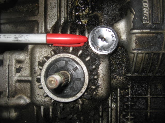

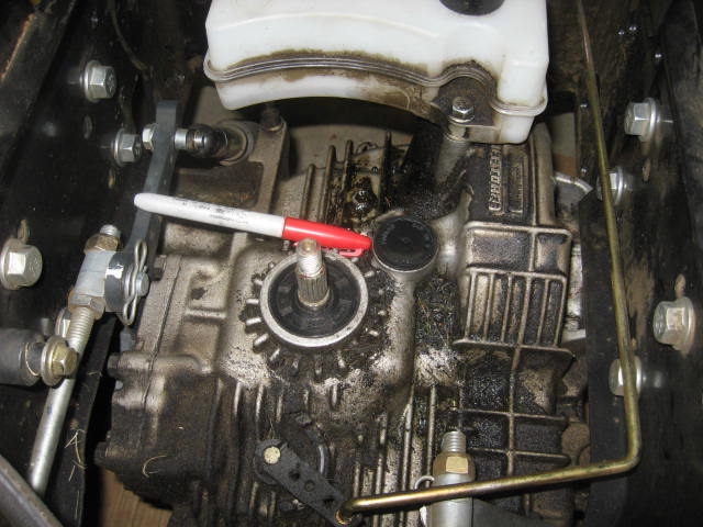

Turns out it isn’t the shaft end seal, rather the small (1 3/8 dia or so) rubber plug located on the cases’ top side. (see red pen tip) Rubber is cracked, fluid had the appearance of oozing from the cracks, but at 20 degrees not a lot of oozing to be done, at least quickly. Seems like an odd design for a plug.....View attachment 2376126View attachment 2376127View attachment 2376128
Looked at both JD and Tuff Torque site. From pictures of the replacement parts I’m assuming its a press in? Anyone replace and use either the Deere or TT part and care to evaluate?
Access was indeed pretty straightforward. Bolts/seat switch harness removed as suggested above. For anyone else doing this, you’ll need to unload the drive belt tension by removing its spring. Impact wrench on fan nut will release it and the pulley. Also need to remove two fuel hoses from tank fittings.

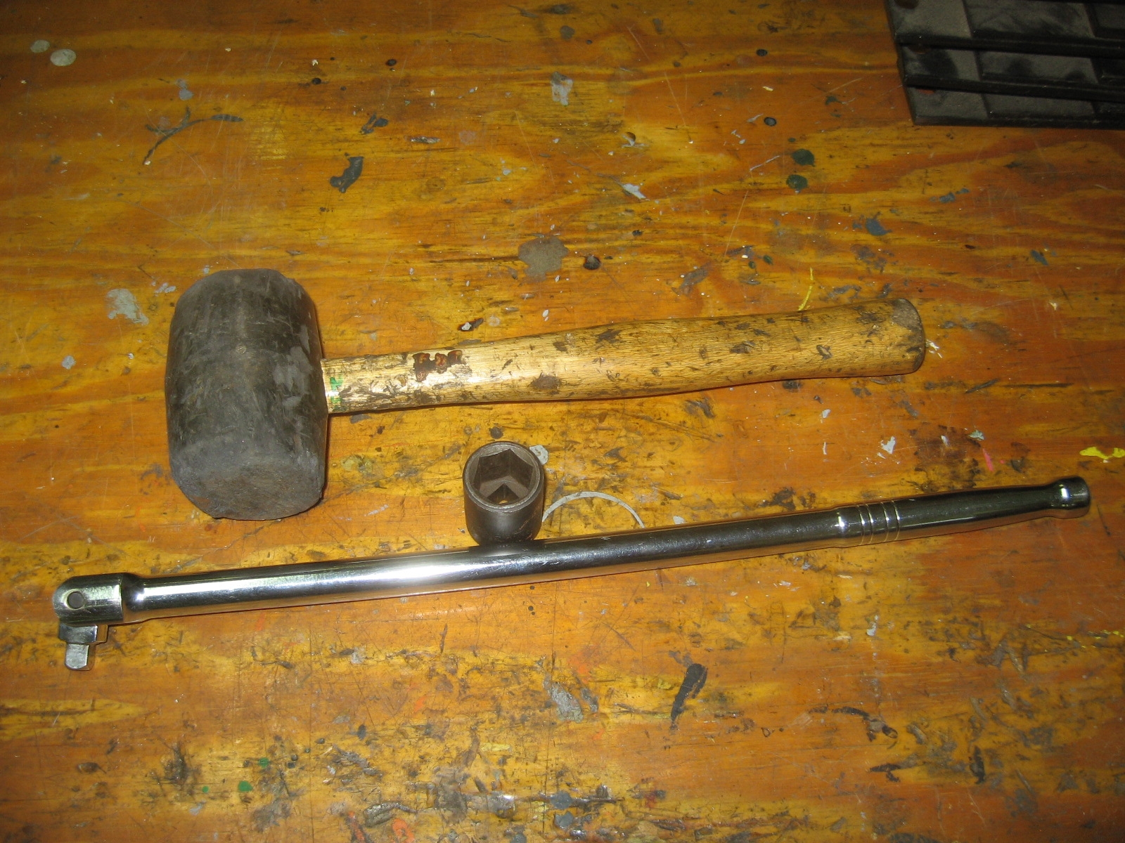

Way back in college days when I couldn’t afford much of anything and my 1975 RD-350 needed maintenance, I’d use a long handled socket wrench (aka breaker bar) and a rubber hammer as an impact wrench substitute. Trick was to give very firm, hard, raps to the end of the bar to induce the momentary torque on the subject fitting.
Given your X500 output shaft is free to rotate, the rap(s) would have to be quick and forceful. Maybe add a strap wrench to hold the outside of the pulley….. Before going this route review the posts discusses output shaft splines stripping.
