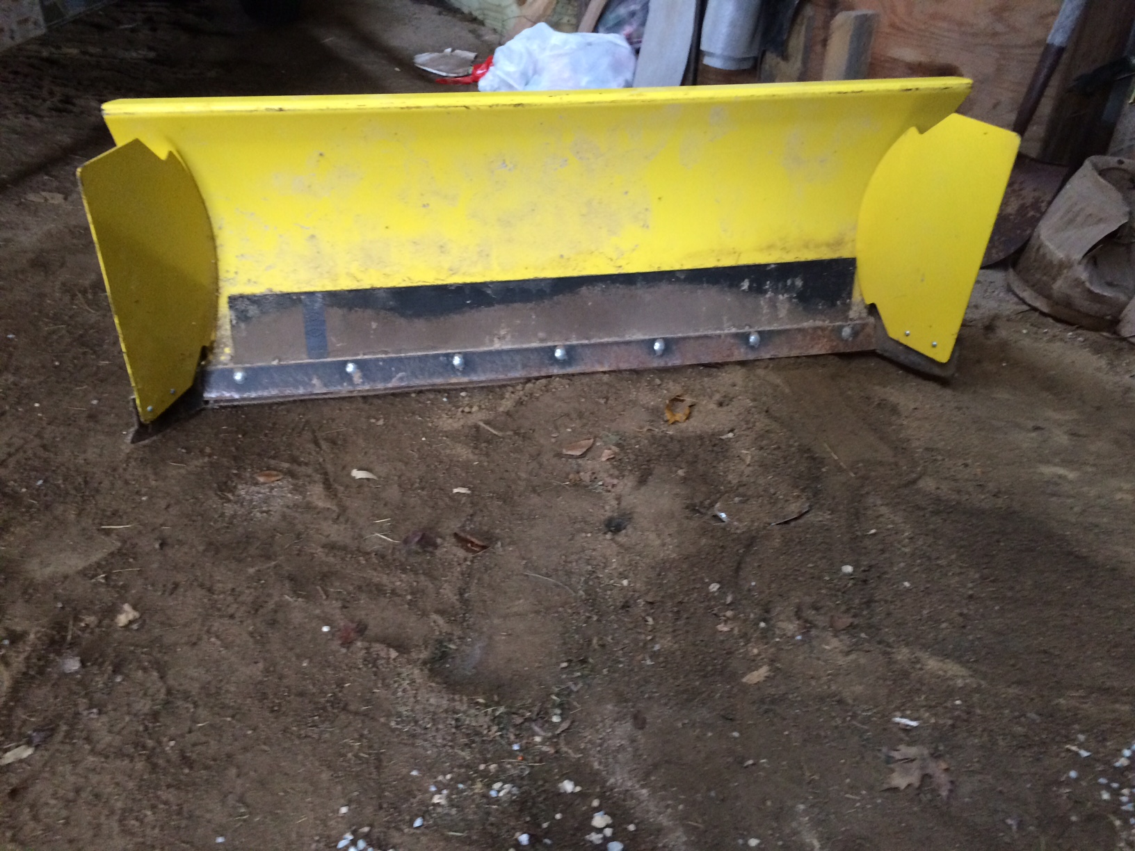

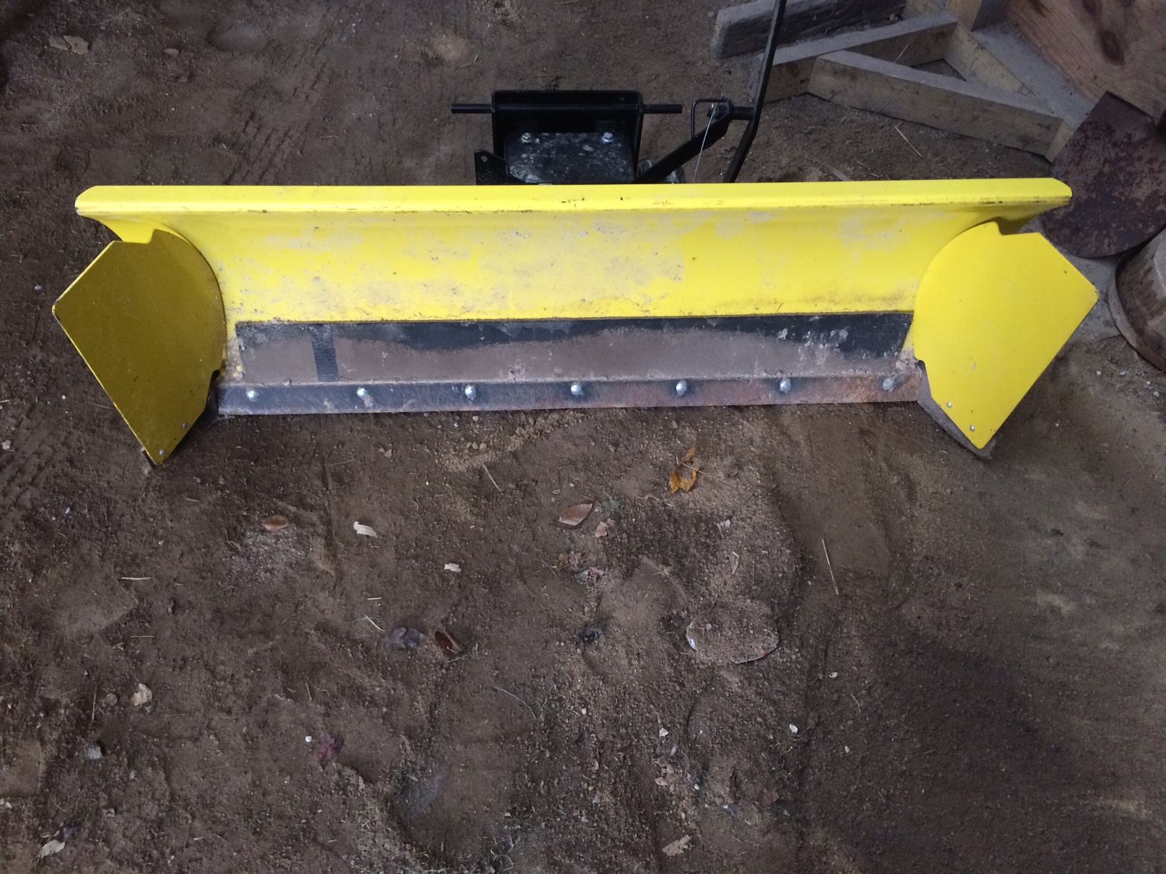

Took a couple of pictures of my 48" blade with the wings. Not sure were my son found these wings but they were made for these plows. I also have the manual tilt package installed so can tilt the blade without getting off the seat. I do not have any extra weight but do have chains. For real deep heavy snow I have a walk behind snow blower and or the Branson with a blade or the FEL.

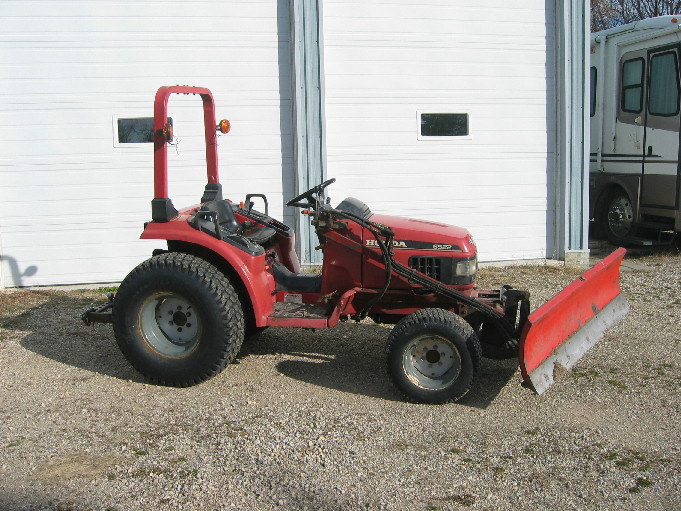

I'm new to the forum here, but my Dad has been on here forever and I've been a lurker. I just a picked up a 2014 x500. I got a 44" blade off a x300 that will work on it. I just have a couple questions:
With the amount of snow you probably get in NB, I suspect, when you need it most this will not be a satisfactory solution. I used to have a Honda 6522 4x4 that weighed a lot more than an X500. For light fluffy snow - no problem, but heavy / wet - not the greatest. If you have the blade, give it a try, but with only two wheel drive don't expect too much.
