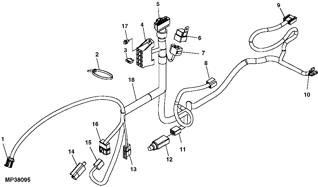

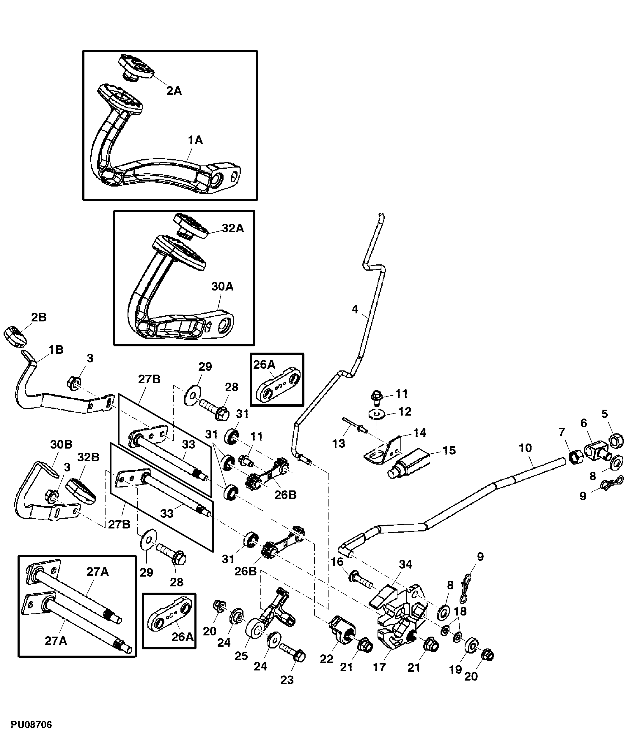

These two drawings are from jdparts key 12 in one and key 15 in the other are the reverse switch

If it is like the x7** tractors, the deck won't turn on if it thinks you are backing up. Once the deck is running, if you back up, the deck shuts off unless you pull up on the deck engagement handle. You can bypass this feature with a jumper behind the dash with one wire (to test of course).
"Once the deck is running".....That's the problem, I can't get the deck to run in the first place. I'm familiar with the RIO and did jumper the switch. Still no go! Too tired to think straight!!
