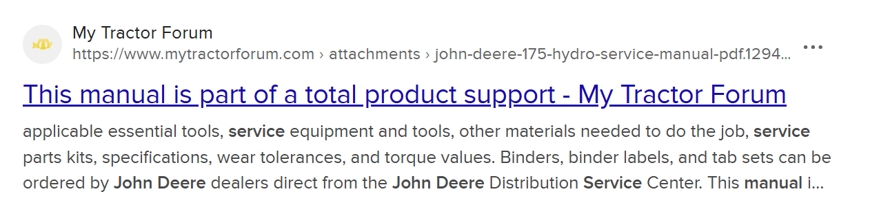

Here is a link to the service manual:
Richard
Richard
OK my faut, I didn't check it to make sure that it was complete. However after searching for hours, I did find the complete service manual, but it's to large to post here. Try this link:
When you get there, you may have to scroll down a bit, then click on this blue text.
Richard
