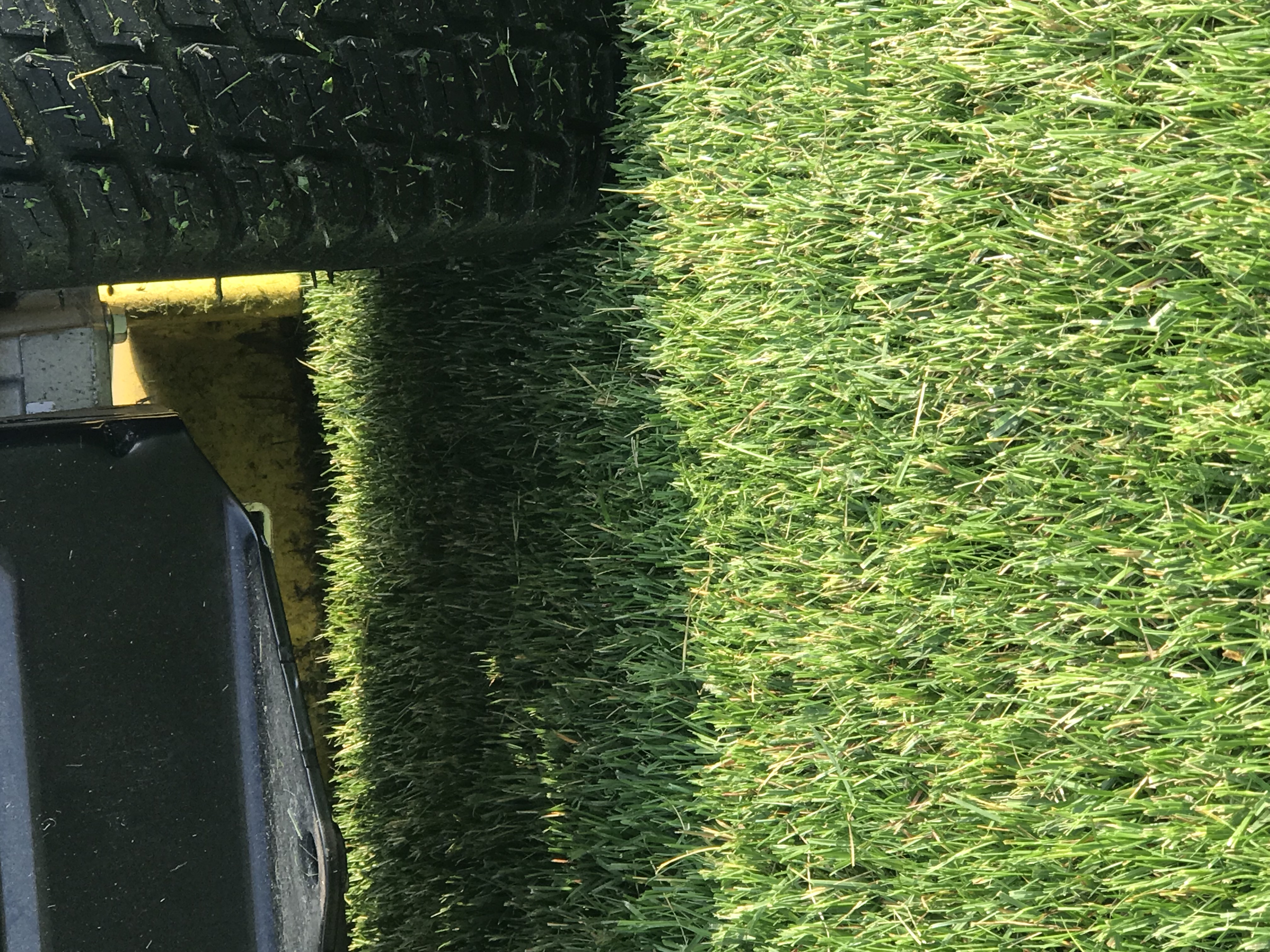

I'll stop back into the dealer and show them the pictures and see what they say. I mentioned this to them when I was in getting oil for the 8hr oil change and his response at the time was to just keep tweaking the settings a little. I wasn't thrilled about that answer but at the time I didn't have pictures to show him.
Good luck...let us know how it turns out. If you are still within the JD Promise time limit, you can always threaten to return the unit and that should get his attention. :D
Also, if he doesn't jump on this one then try another dealer if you have one close to you.

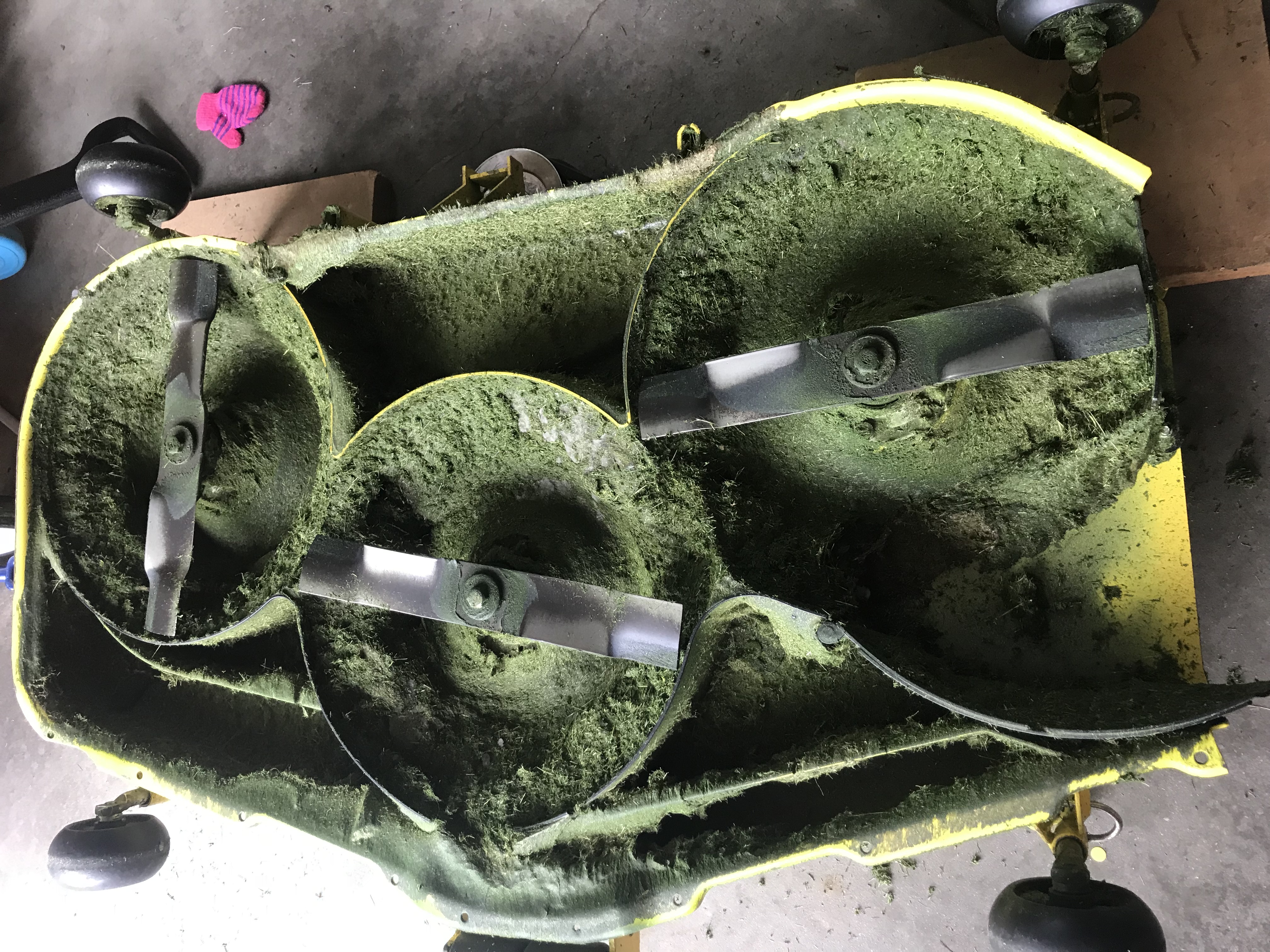

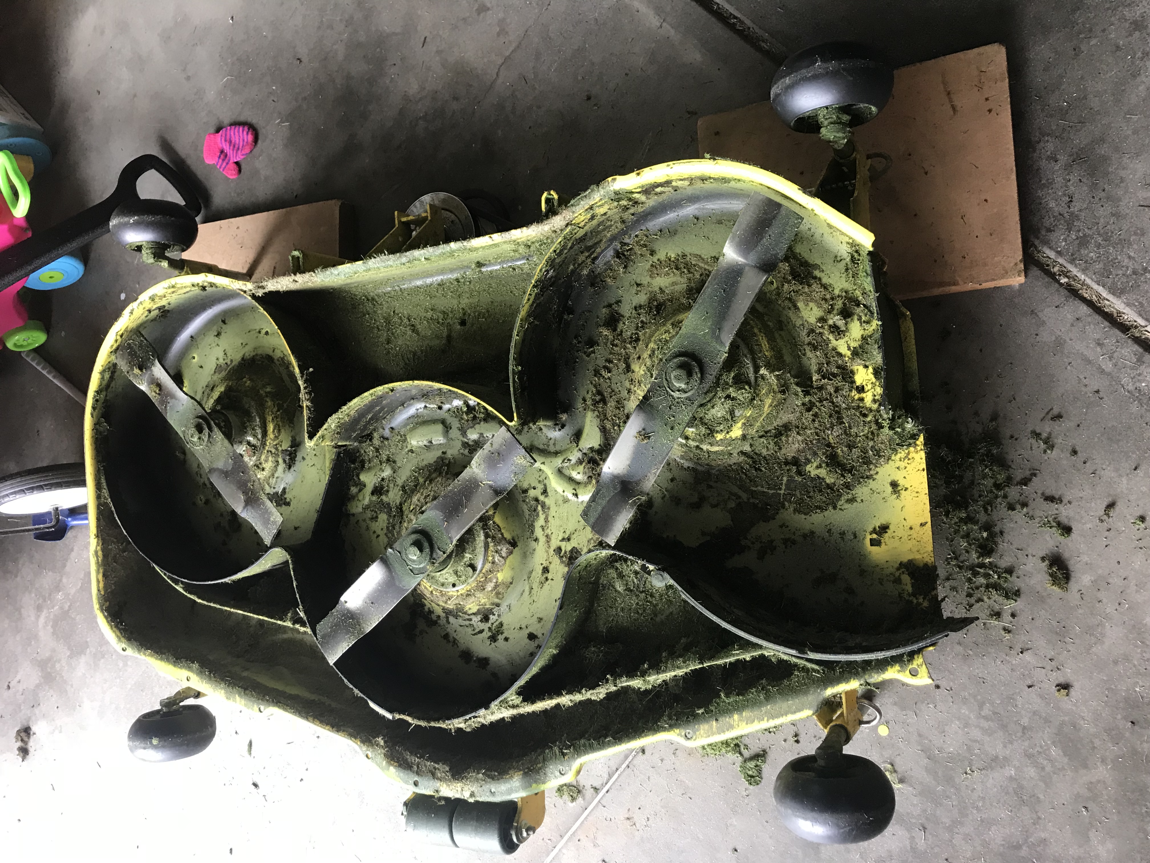

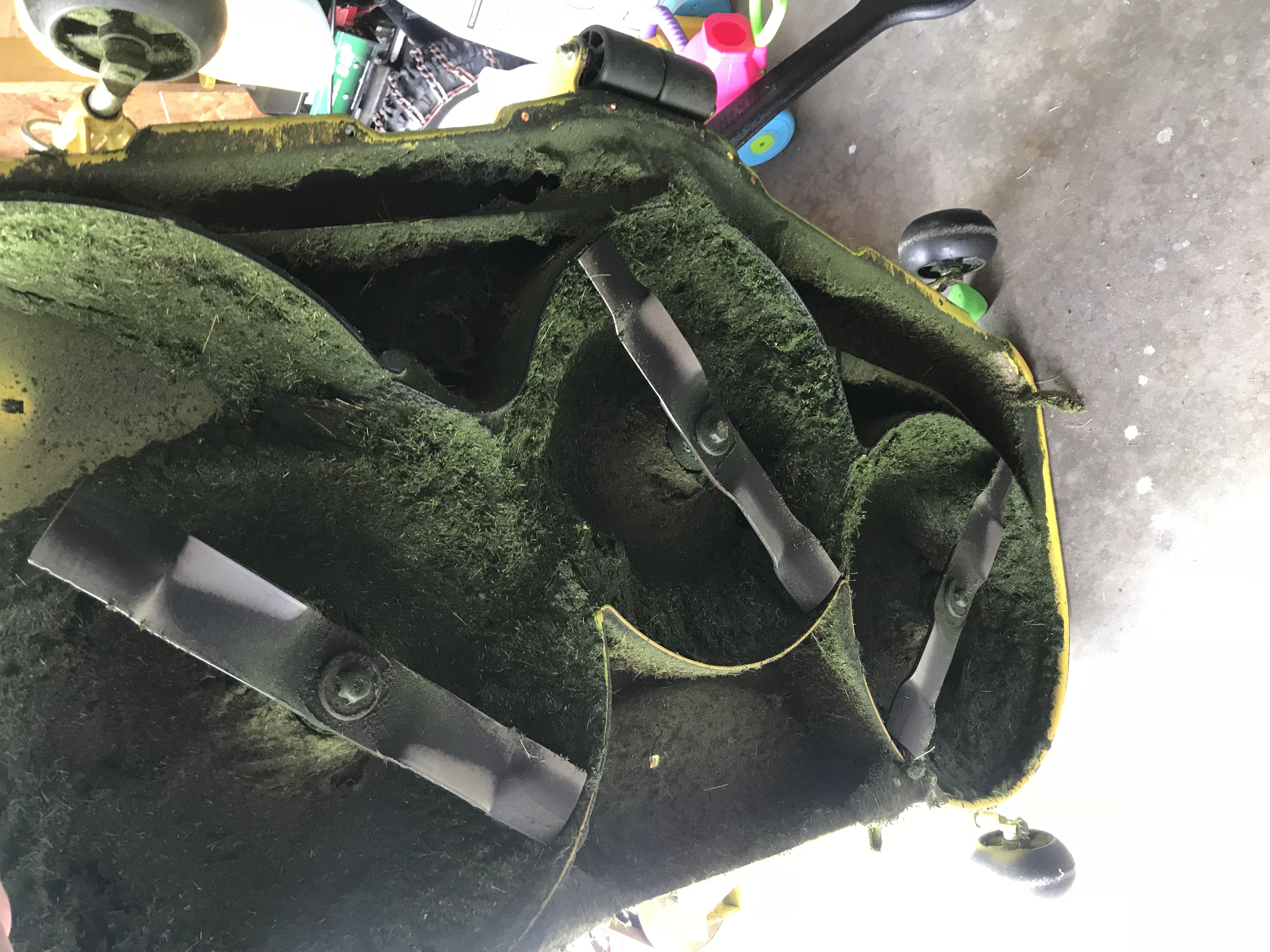

I haven't had time to get the to the dealer or get the gauge but I was able to pull the deck and I was amazed at what I found. The grass was caked up underneath. The mulching kit has only been on for 10 hours of run time! I don't think this is what is causing my issue, but i'm sure it isn't helping. I'm also outside of the John Deere Promise now as well.
   / X570 Cut Quality Issue #25
Yuck!
Choked it down to where the poor thing couldn't swallow any more wet grass.. but then early season grass is very juicy and sticky even when not wet.
Suggestion that works for me.. get a compressor with a good air blow gun (mine is about $3 at HF) with 2' wand and after EVERY mowing the tractor, deck and underside get blown off clean. It can then be dry when the next mowing takes place with very little clogging under the deck. Limits possibility of rusting the steel deck too.
I think it would do wonders for you too.

I've been using my leaf blower and trying to blow into/under the deck after every mow, but it's clearly not working. I have the air compressor but I'll have to get a wand and give this a try.

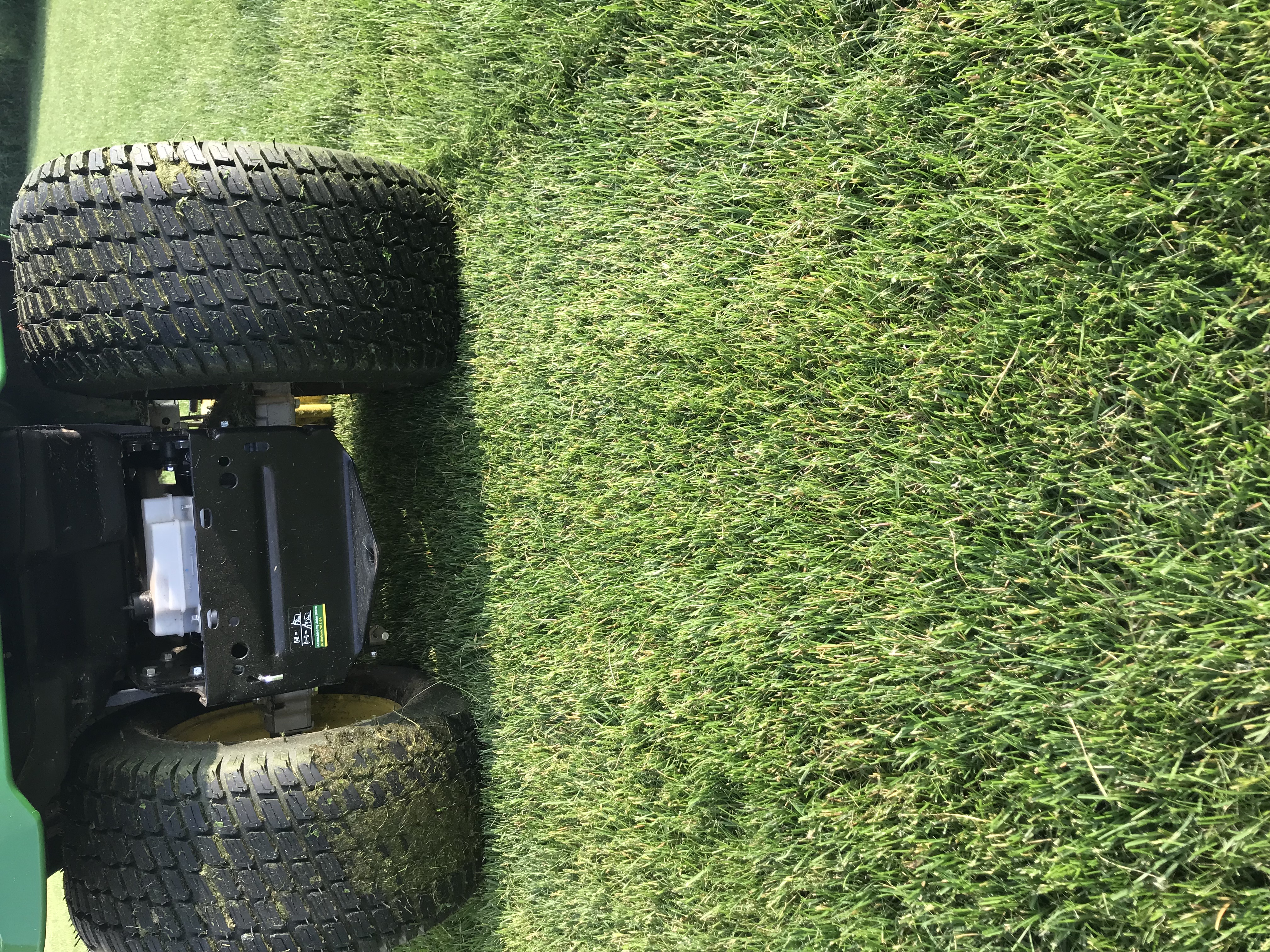

(I did not read 3 pages of responses, I looked at the original photos attached.)
My opinion is that the deck is leaning/sloped down in the front center creating the lower cut path from that center of the finish mower 3 blades.
Looking at your original post, I see the one narrow path that is cut low, and a double width boarder cut high, as if the outer blades are higher than the center, and you cut back and forth meaning that the outer blades make a double width high cut path compared to that low cut center strip.
Adjust the deck to raise the front and remove that mulch kit. Try mowing it again. It appears that your side to side deck adjustment is pretty much spot on. Just give it a try. I am thinking that this is the problem.

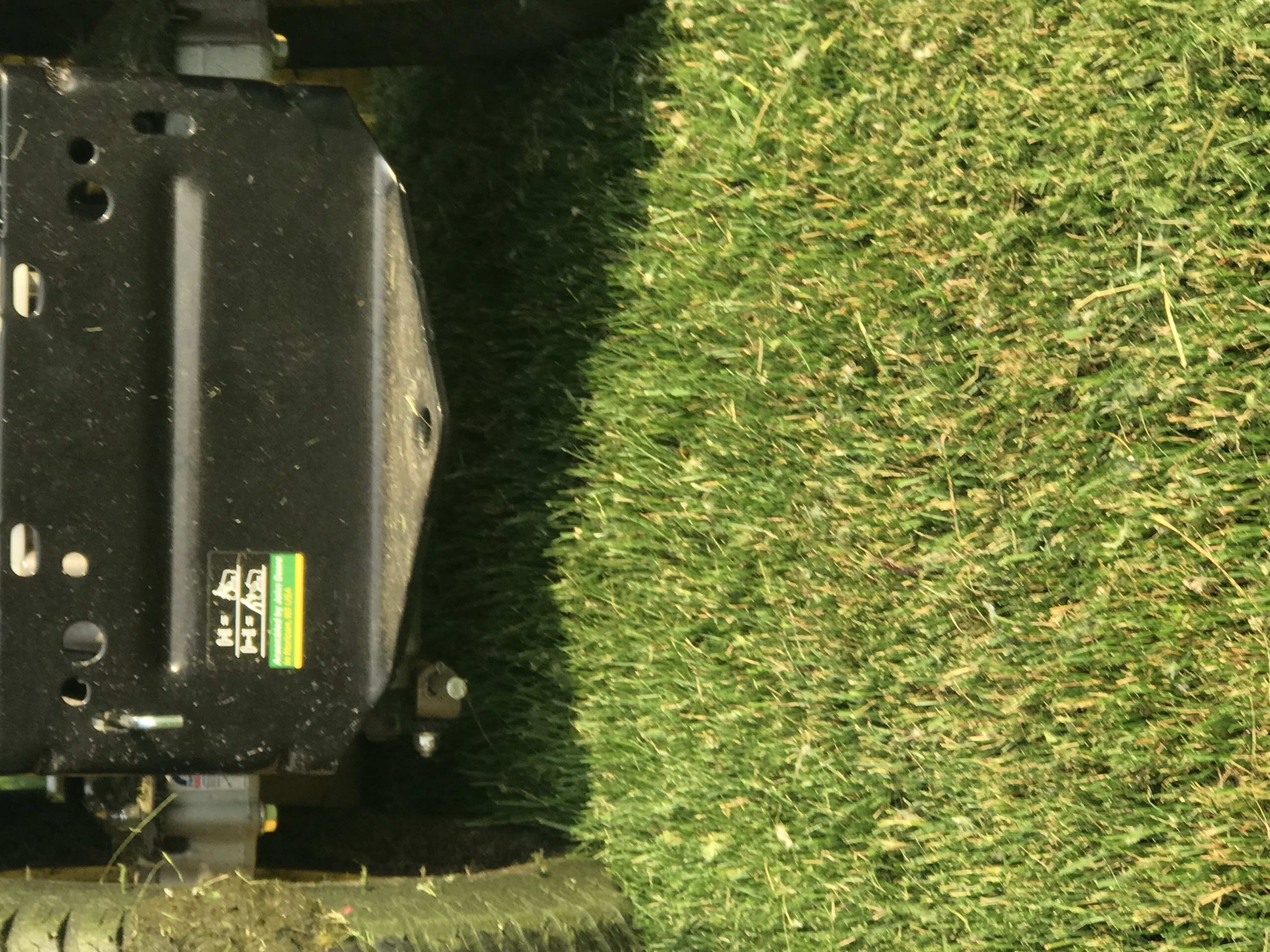

I worked on and off all summer with my dealer and the end result was pulling the mulching. even after that, I've still not been happy with the cut quality. some areas of the yard look fine and other areas i'm not thrilled about. pretty much any area where there is the slightest change in grade, or if I turn to any degree other than perfectly straight, I get a crappy cut. I brought this up several times with the dealer and they tell me the mower is perfectly level and the blades are good. They tried to blame the issue on the grass. that it's too wet and causes issues. I only cut in the late afternoon. We had some drought conditions in Michigan in August and even then I wasn't happy with the cut quality. Talked to the dealer and again its the grass condition. I guess JD mowers can only cut specific grass and it has to be dried out?
I contacted JD directly but their only responses was to keep working with the dealer... Can't say I'm overly happy about the whole situation.
