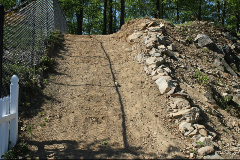

Yup, lot size is only 1 acre, and my house covers a good amount of that. I wanted the 4WD because to get to my back property I have to go up a steep incline and my GX345 couldn't do it. As far as upgrading to a diesel, well the X595 is a diesel, so that's not the reason.
Do I NEED this tractor, absolutely not, it's a total luxury. I could get away with a walk behind if I had to. I just love and enjoy tractors and probably always will.
But this is not the point. Let's just say I had 3 acres to mow. The question is, what is the smart move, and more so, what is the better tractor?
As I said before, I will go and test drive the X748 and 749, maybe that will help me make up my mind.
Here are some picks of the incline. Just steep enough to stop the GX345.
