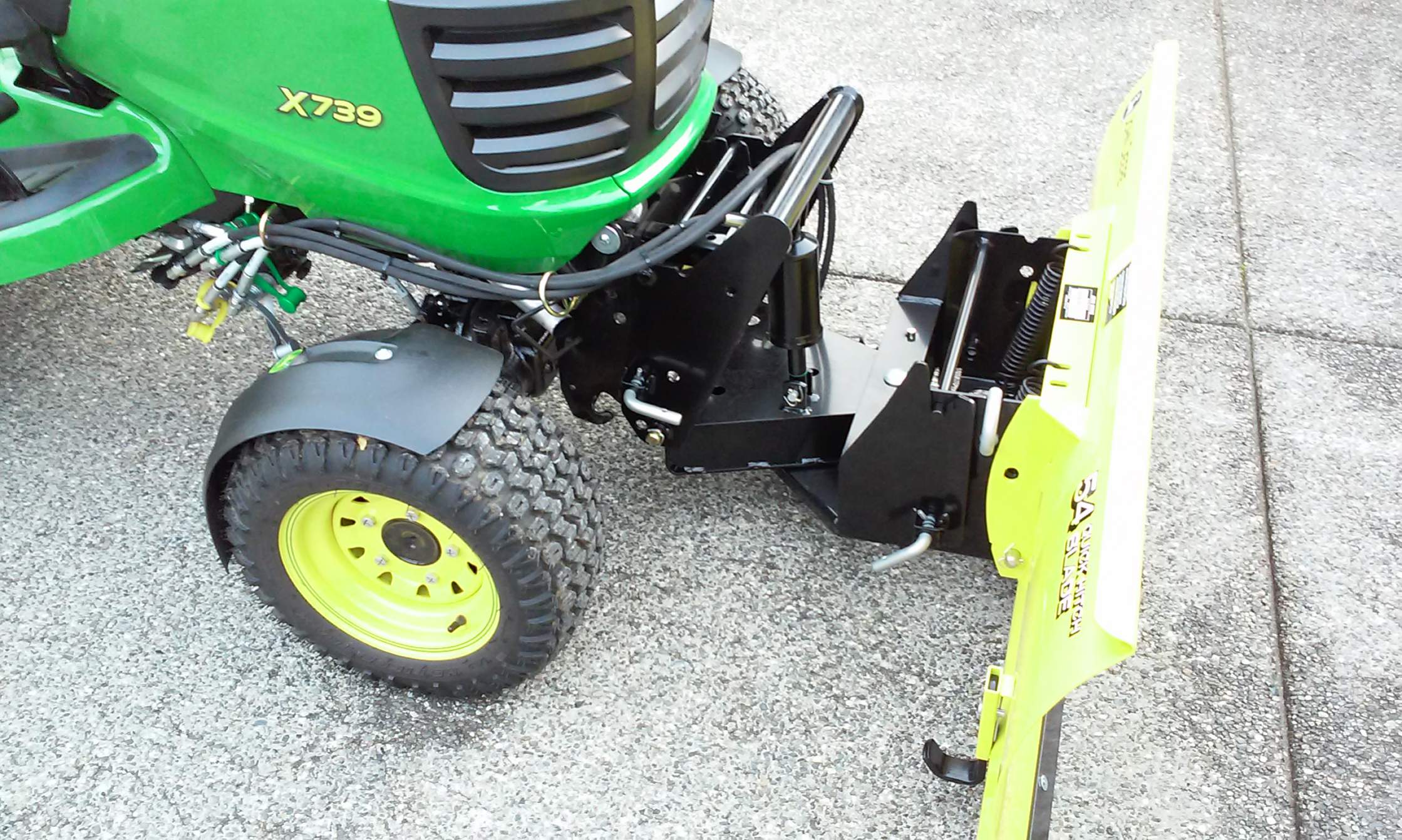

Has anyone made the JD front fender kit fit on a X734 AWS? I see JD says it only fits the 2 wheel steer models. I'm wondering how or what might be needed to make them fit as I HATE seeing the salty water spray up on my $15,000 machine when I sweep snow and snow blow at my business.
I have front fenders on my dads X475 and LOVE them because they keep the salt spray down from the tires in the winter.
Anyone know the front end differences between a AWS and a regular 2 wheel steering unit?
I'm going to pick up my new X734 tomorrow hopefully (assuming they get the power flow assembled). I might rip the fenders off my dads X475 and see how close they get.
Anyone have ideas?
Thanks in advance! :thumbsup:

They fit fine on my X739 AWS but the steering and axles are totally different than your X734 so mine would use a different kit.

I just removed them from the 475 today and I looked at them and I think they will work with a little effort. The right one bolted right on.
The left one the upper mount arm needs to be cut off and the rear mount arm should work. I'll just need to add a brace to keep the fender somewhat in the curved shape of the tire. I'm thinking of having a local welding shop just cut it up for me. I don' t have a welder.
