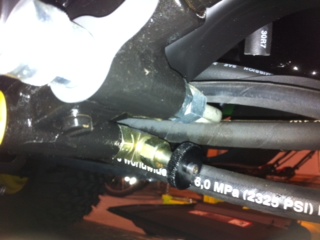

Jim - You are correct this is a great forum for sharing experience. Thanks for taking the time to share the pictures. was able to get the valve installed this evening in about 25 mins and that included the time to remove the deck. Happy Holidays all!

Heres a picture of the lockout valve on my x728 that came with the tractor when I ordered it new on Jan. 5 2010.
Rob

I have to do mine this weekend too. Did you guy's use any thread sealer(teflon tape) when you did it? Thanks

Thanks Rob! Your pic is a big help to see what and where it's going.:)

No need for teflon tape.

They say that teflon tape risks getting some in the hyd. oil and messing up things. So they say. I've used it in the past, but don't anymore.

I totally agree and the elbow you take off does not have it applied. The O Rings take care of sealing things.
