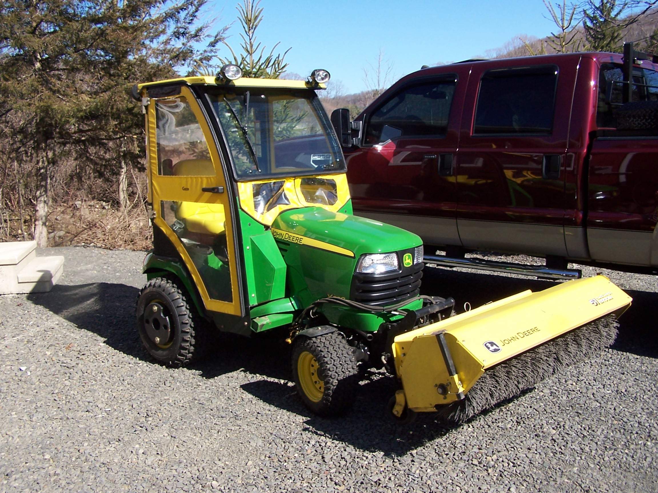

It was very simple installing broom attachment and front PTO.
Here is a photo of the broom & X728.

Snowblower... It is work to get the drive shaft in place from the mid pto to the front axle. Once that's done, the quick attach is heavy, but not too unwieldly. The blower goes on easy. I have mine on a dolly and move it in front of the tractor, hook up the hyro lines, and it's a 10 second job after that, with no labour. Drift shaft from blower to the front axle is very easy. Unhooking the blower is easy too. Put the dolly under the blower, lower the blower, unhook the hydro lines and driveshart....and done. I can take off my blade and hook up my blower or visa versa in 3 minutes, with no effort.
The mower is quite easy and no sub frame. The quick hitch does have to come off, then there is a bracket that "hangs' the front of the mover deck off the ground. Next is to line up the rear arms that lift the deck for the mowing height. The pto hook up is a pain, especially if you don't do it regularly. On the ground for sure. It is a 5 minute job when I remember to do everything in the right order. No real muscles needed, more finese than anything else.
Hope this helps.
