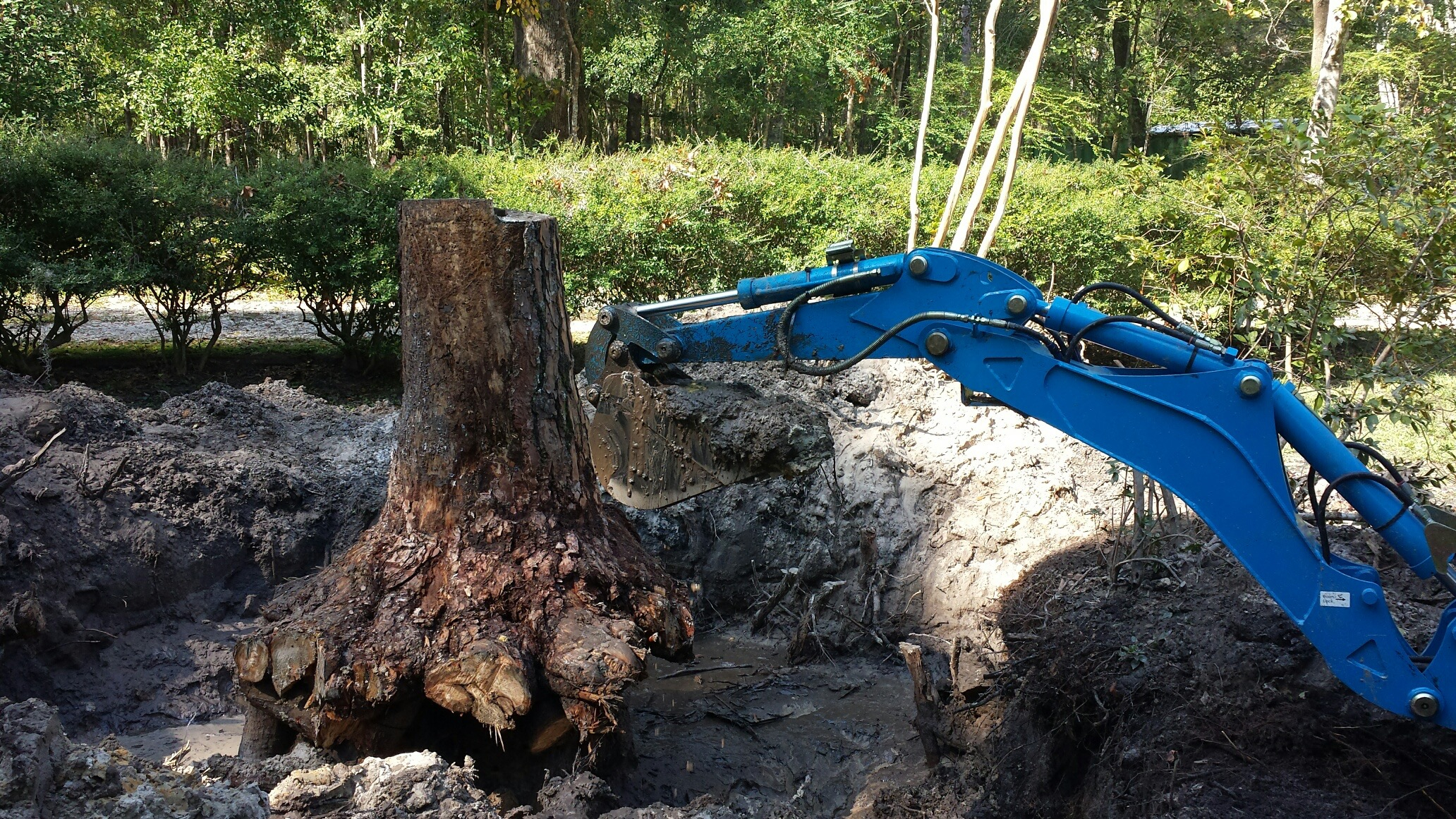

HEY ''fgsiii''
Check out page 17 & 18
Keep in mind, our LS is a 2016. This may or may not mean anything.
Our biggest or tallest trees were 100+ ft
These pines had stumps up to 42 inches diameter w/ tap roots beyond 6 feet deep.
We dug around the stumps & pressured washer the side running roots then chained sawed them .
Had to digg down under the stumps & wash out that area so I could get under that to cut the tap root.
Most of the time we just dug out some of the root & pulled that up.
It was our BH model # 1100 W/ small bucket on the business end that did most of the work.
Each stump offered up a different root configuration
No way our XG3025H could operate a front end ripper large enough to extract these stumps or even some of the side running roots as they too had their own tap roots.
Hope this helps

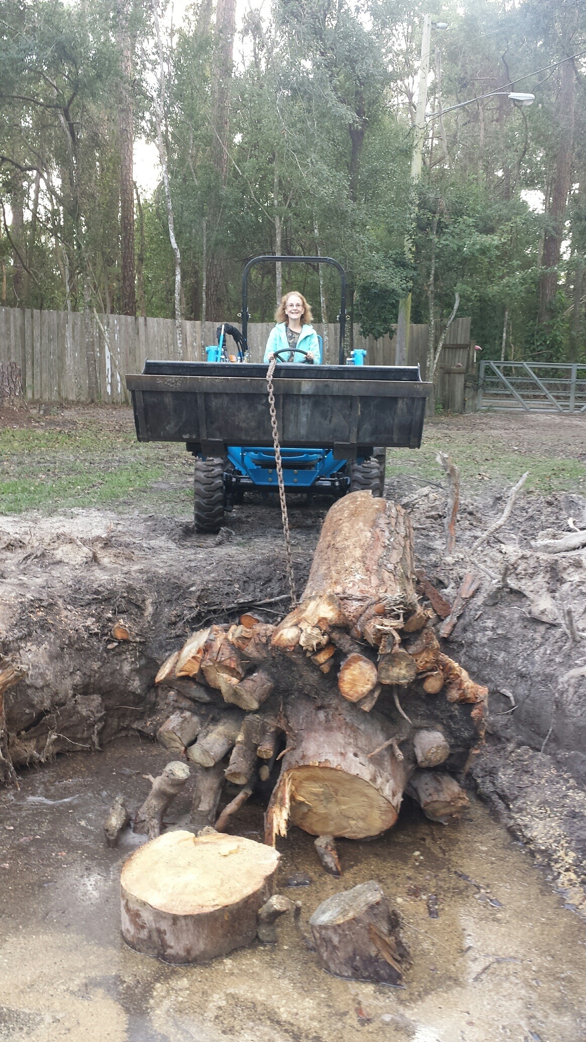

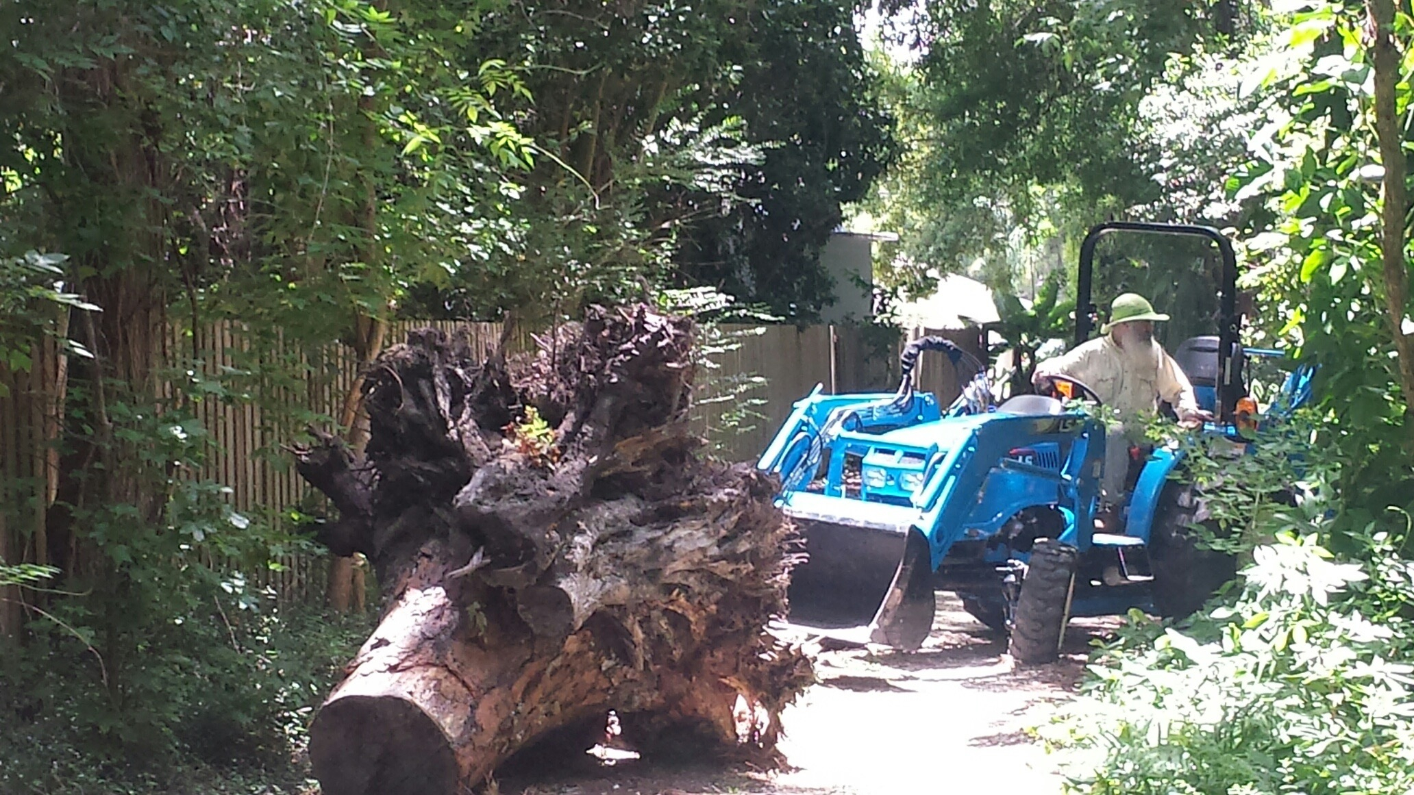

Here are a few pix of our LS earning its keep .
These were taken just before the recall which we are talking about now, on the XG3025 for my 2016 model.
Since the complete work was done on our tractor we have continued to remove the same size stumps w/ no issues.

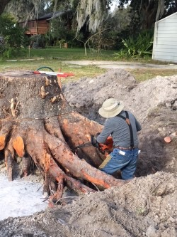

Here is one more pix of the lower root cutting in order to remove the stump.
This tree is not a pine but an old sweet gum.
Perhaps on smaller stumps & lesser root systems a ripper on this size LS tractor might do the trick.
