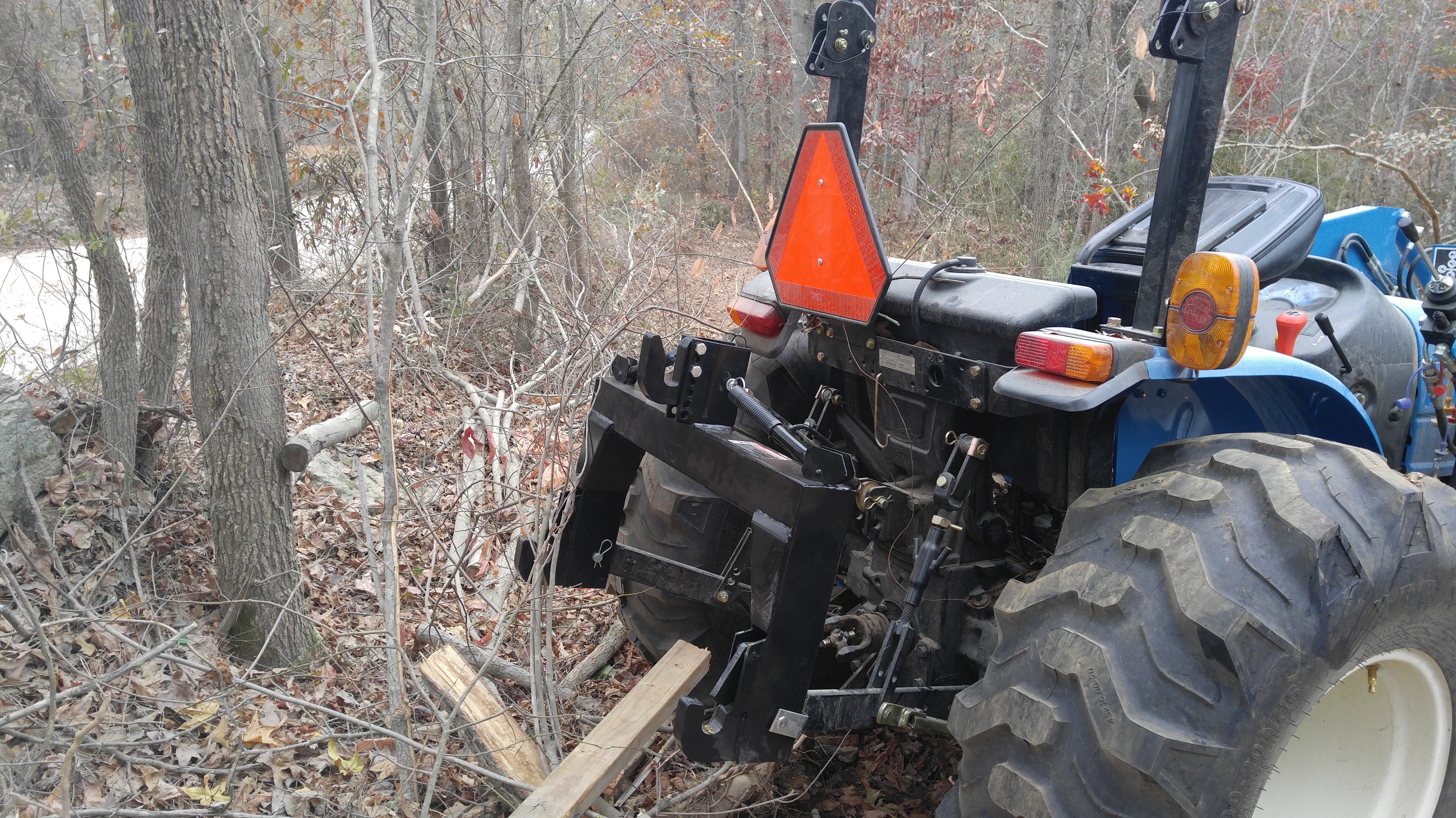

Update to steering and using ratchet rake
Got the steering fixed . Could not use the 1 in pipe over the tube, would not fit behind the axle mount
Here are some pic before and after using the ratchet rake

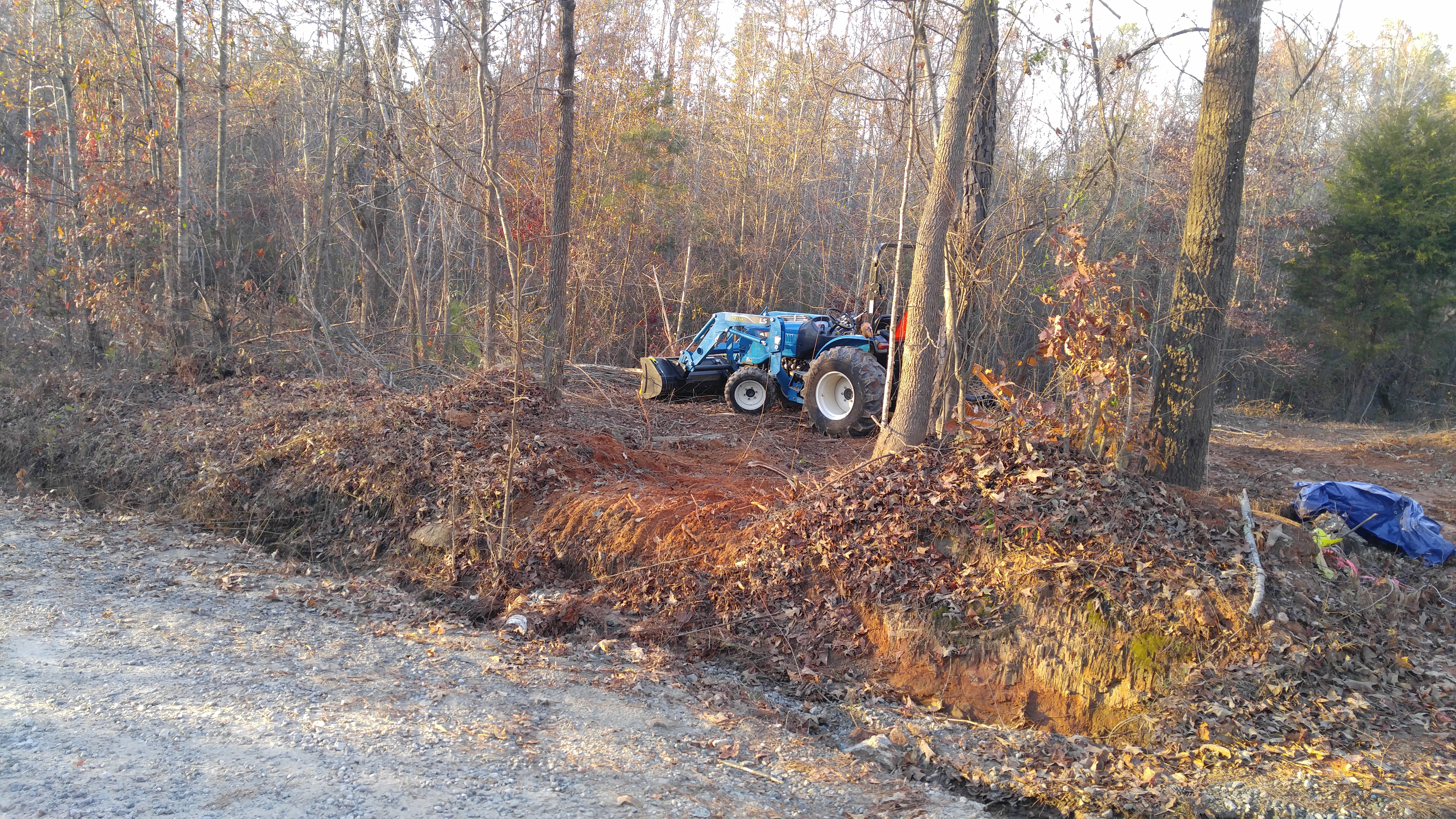

   / XG3025H ant other owners out there? #25
Got a long way to go. The Jeep is about middle of the property line. It about 1500 ft deep

   / XG3025H ant other owners out there? #28
No on the bigger tractor, because once this is done it will be for cutting , maybe digging post holes etc. If wife wants a garden then use it for that. This first acre has been the hardest. Once I get on top of the hill does not look that bad. I could have rented a dozer for a week but then would have nothing to do.
