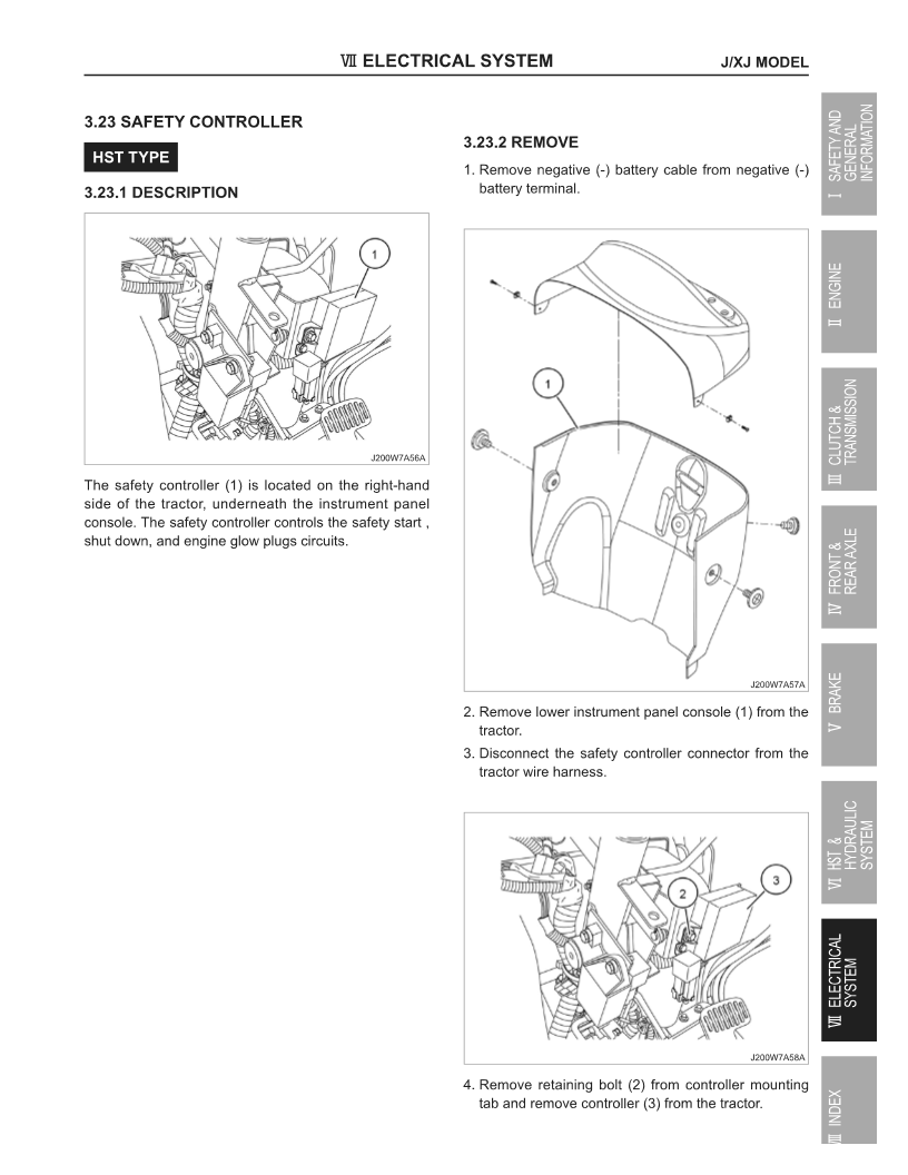

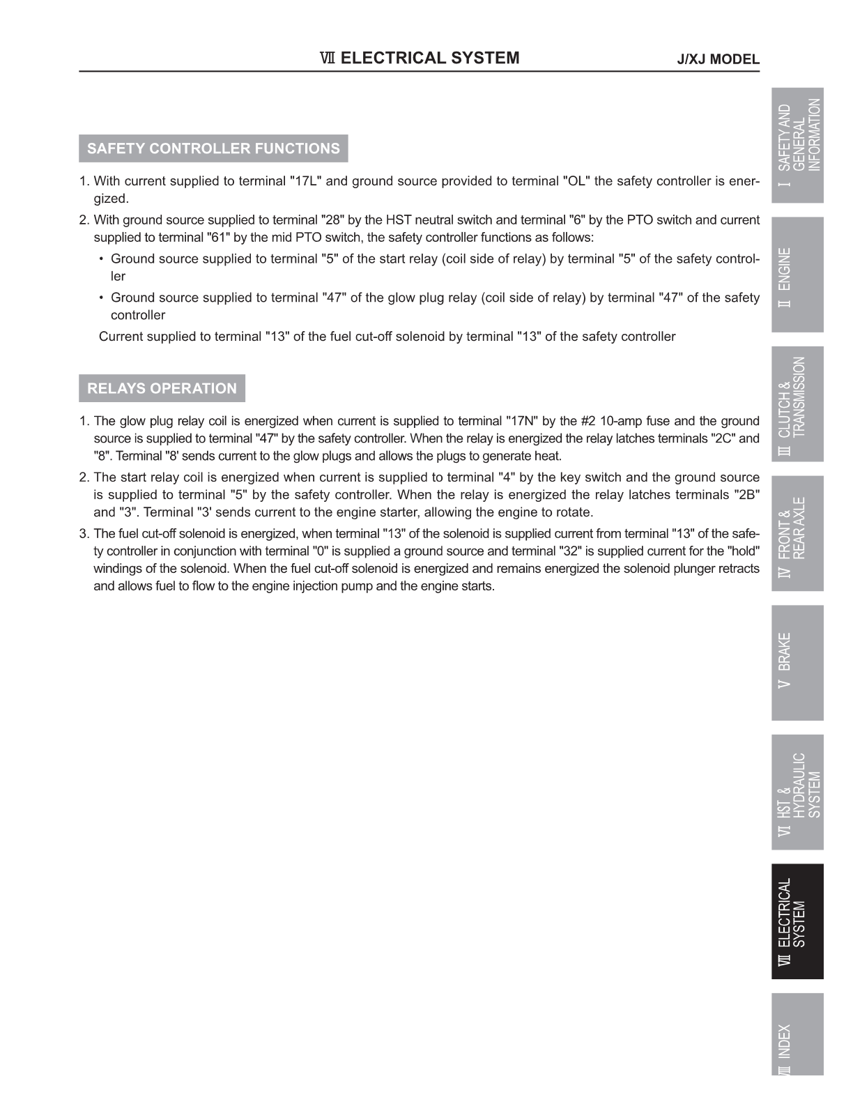

Well, it died again, this time I insert the key turned to the left light up the glow plugs then rotate the key to the right to start and hear a click or pop and the main instruments does not show a blank or dead wonderful start to the day. I pull the cover check the fuses and the 40 amp at the starter is good instrument panel still blank. is the safety controller part of the instrument panel or just another relay sized relay with the start relay
   / XJ 2025H lock out switches #18
The parts list shows 1 each or 3 different relays. Nothing specifically designated as a controller. 40007175 RELAY-START-TRG750, 40007122 RELAY-ENGINE STOP-TRG750, 40198043 RELAY-TWIN-TRG750 . There is an engine control G100S01-04 .
Below from the service manual.

So here we go I replaced the OEM start relay with an aftermarket relay and just ordered a new OEM relay. The aftermarket only worked a few times after. The next day then goes to start twisting it to the right then pops and nothing. It might be that the aftermarket relay was not strong to control the current anyway a new OEM relay is on the way. All the fuses are good again. ?????
