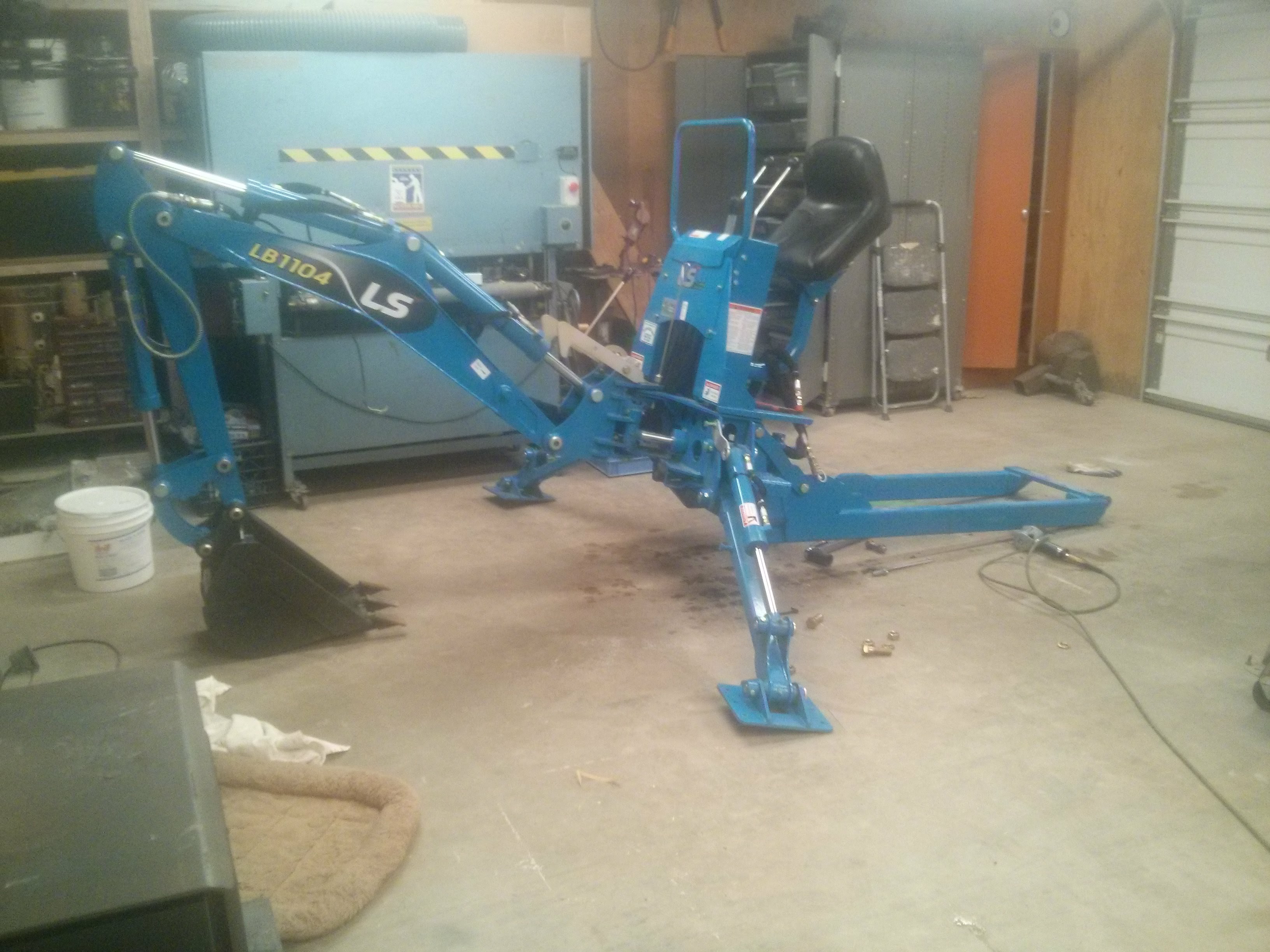

I saw one thread on it but not really any pictures, anyone able to make a backhoe dolly for the xj2025, i tried buying some heavy duty snowmobile dollies, but didnt have much luck getting them to work, may have to revisit it, but might just be better off building something, kinda hoping for some pics for ideas, thanks

Storing the backhoe has been on my mind from day 1 of my purchase. I don't have much room in my garage (30x20) to store the backhoe and I don't want to leave it in the field. Also its not very small so you cant tuck it away in a corner somewhere... I will be building a new 40x60 workshop soon and a dolly might work then, but that might not be for a while. So i guess ill have to figure out a way to store this thing so the elements don't destroy it.
/ Xj2025 backhoe dolly #4

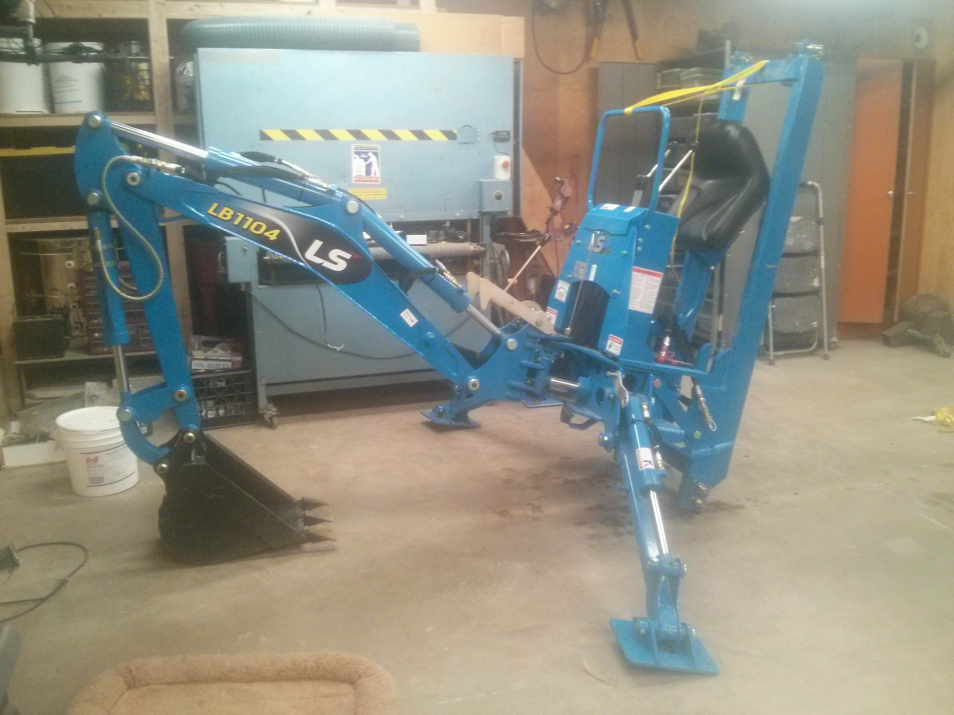

now that you got me thinking about it again... Went out in the garage and took the backhoe off. I think if you take the 4 bolts on the sub-frame out you could fold it up and cart it way but it is still 7 feet long and 4 foot 5 inches wide...
to make a dolly to fit this I think it would be a simple Tee design. In this configurations all you would need is some hefty 2" x 2" square tube. 1 piece about 7 feet long and the other 53" long. Seeing how the stabilizers are already that wide there is no reason to go smaller. Weld them into a Tee and mount 3 heavy duty casters to the ends. then you'll need to fabricate up some mounts to connect where the 4 bolts came out of the sub-frame so you can firmly mount the backhoe to to the dolly.
Dont think this is a quick attach method by no means... but it would get the job done. Instead of using the 4 bolts you could replace them with 4 pins of the same diameter to make it faster.

Like others on this forum have done, you could re-purpose a engine stand... HF has the 1000lbs version on sale for $47 with coupon. 1 lb. Capacity Engine Stand
looks like it would work... dont know the tube wall thickness, but it would be hard to find metal casters and that much steel for the same price.
/ Xj2025 backhoe dolly #9
Yep, that's how I'd do it. Rigid casters at the frame end. Swivel caster at the bucket end. Bolt/pin the frame end before setting the weight down. A saddle bracket for the bucket to sit in.
Buy high quality casters so it can be relatively easily moved.
Wouldn't take more than a couple minutes to attach the cart once the hoe is free from the tractor. Last thing would be raising the stabilizers, then uncouple the hydraulics. :thumbsup:

I built a welding table that weighs around 800lbs fully stocked. It's on very high quality 6" steel casters. It requires the floor to be swept clean before moving. It also requires a pretty hefty shove to get it started rolling.

I had some time this weekend to weld up the HF dolly. here is the end results, well kinda - part 2 coming later this week. Was a fun build. I might even paint it... maybe...
Harbor Freight Engine stand. Can it hold a Backhoe? - YouTube
Thanks rider7767 (Tony) for the idea!
I need a better camera, the batteries died halfway through and my wife didn't like the idea of her picture camera in the garage with sparks
