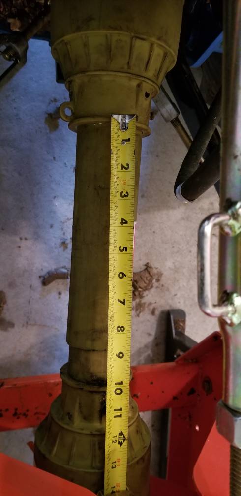

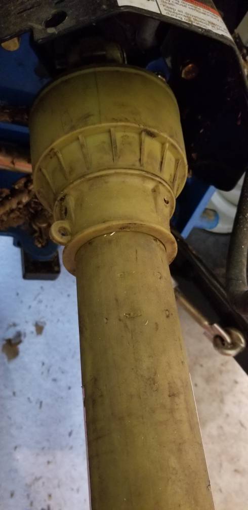

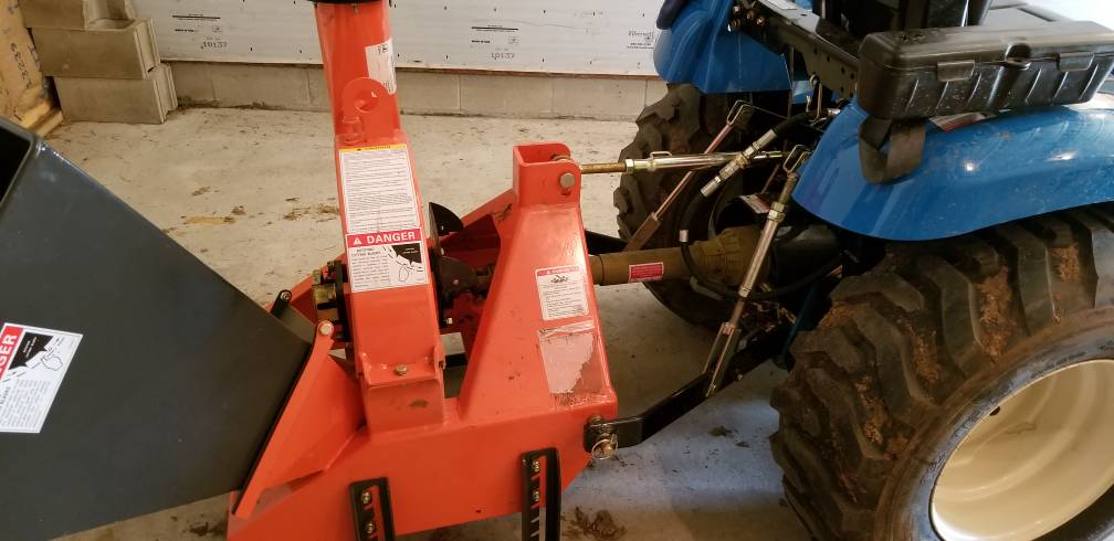

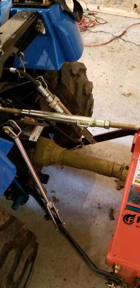

I measured the pto shaft length and it is 10". End to end it is 21". If I put on a slip clutch I figure I would have to shorten the shaft length by 3"+- ending up with a shaft of 7"+-. Is this ok?
   / Xj2025h slip clutch #9
Got a pic or 2, seems a bit short to me. Now I’m curious to measure mine. I do know the slip clutch was integral part of the pto shaft on mine, not between shaft and implement.
Here some pics 20200510_095720.jpeg20200510_095542.jpeg20200510_095500.jpeg20200510_095655.jpeg20200510_095701.jpeg
