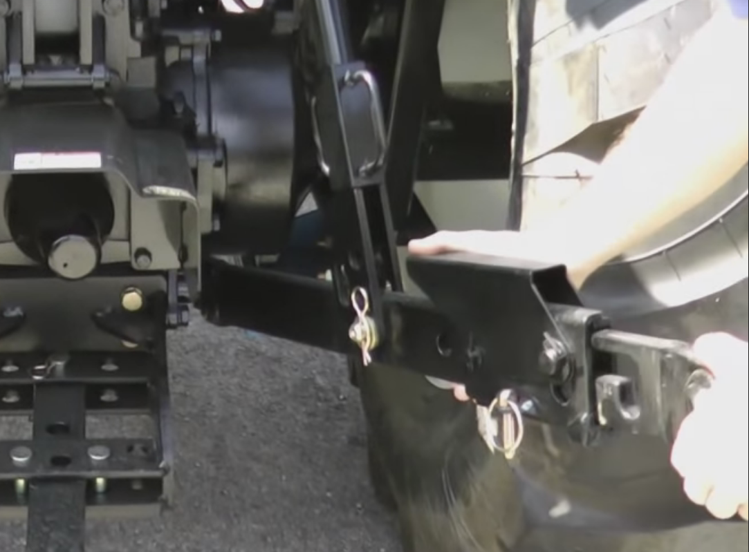

Just to add to potential quality control issues...
I received by XR4145HC about 4 weeks ago. I have enjoyed the tractor very much but have had trouble back blading and brush hogging with them moving side to side. The stablizers were locked... The telescoping lift arms however would keep coming unlocked. I was getting very frustrated with them as they never stayed locked for more than 5 minutes of use. I never had them before so I thought I was using them wrong and I went looking in the manual for how to use them... Nothing in the manual. Then I looked online for LS examples of hooking up with them, and found very little. Finally I found a RCO tractor review of a LS 5000 series and they were just showing the telescoping lift arms and immediately it became clear what my problem was....
Mine came from the factory upside down and flipped left to right too.
This is how they came (note the L slot pointing up):
2016-05-20 16_51_51-upside down 2 - bthompson@pivcon.com - Pivcon Inc. Mail.png
This is how they should look (note the L slot pointing down):
2016-05-20 16_53_38-Lift Arms Backwards_ - bthompson@pivcon.com - Pivcon Inc. Mail.png
So I am looking forward to flipping and switching sides (so they angle the right way). I bet things work better. The whole time I was using them I kept thinking "this seems backwards" but just didn't trust my gut to go look it up and figured I just didn't know how to use them.
