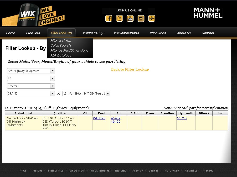

If you go to the Wix website, your tractor is listed in the lookup guide. For a long time, there was no info for LS tractors, but it is there now.
Thats good to know! Last time I used any search tool like this, LS was never an option, but New Holland was.
   / xr 4046 oil filter offense ! #12
But they dont list engine oil filter. :thumbdown:
   / xr 4046 oil filter offense ! #13
Still more than is listed for mine!
Sorry, but there are no filters for this vehicle in our records.
   / xr 4046 oil filter offense ! #14
But the Wix site still does not list the oil filter for the current Boomers that are made by LS.
A New Holland filter could be an option. Messicks sells the oil filter for the current XR series for $13.52

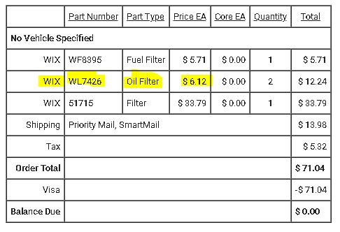

I use Rock Auto for my filters. For my tractor, the WIX WL7426 works perfectly. Its a bit longer, maybe 1/4in if memory serves, over the stock LS brand, but it works just fine. $6.12
