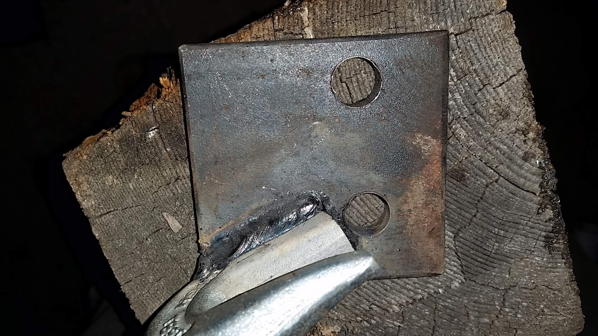

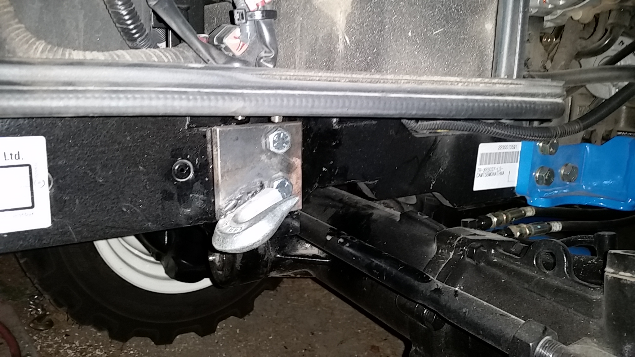

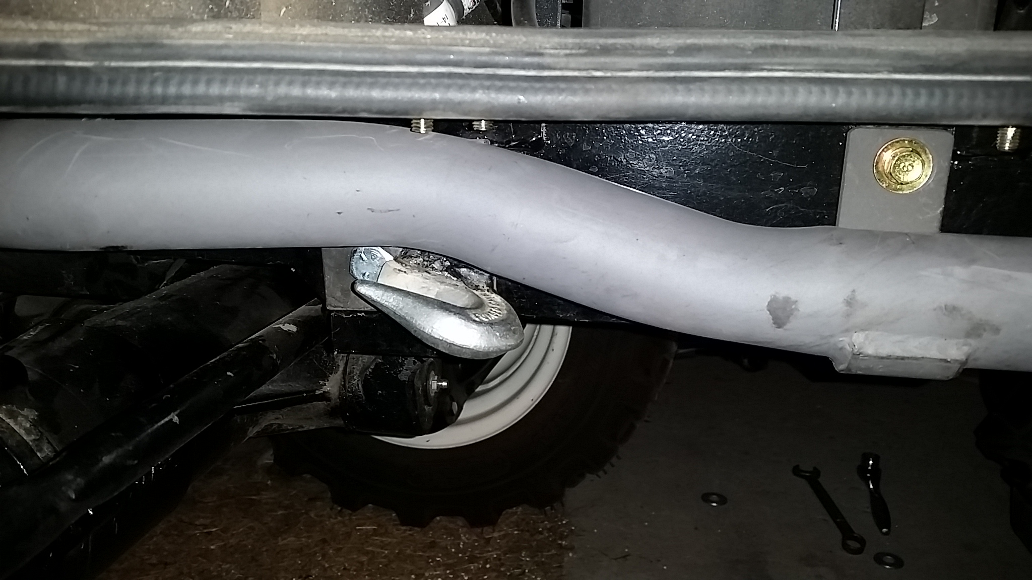

I didn't like using the front frame to tie down my tractor on my trailer as every time i torqued the binders, the frame tweaked. Being i am commercial i can't get away with JUST tying the front down by the loader. (DOT REGS) I have to tie the front, back, loader AND implement down. Made a couple of plates and welded chain hooks on them, then bolted them to the frame right over the axle where it is double thick. The one by the exhaust will be tight but the chain does fit......

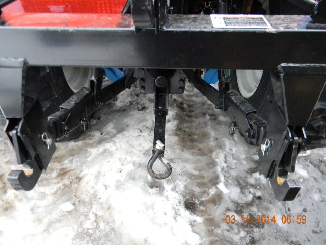

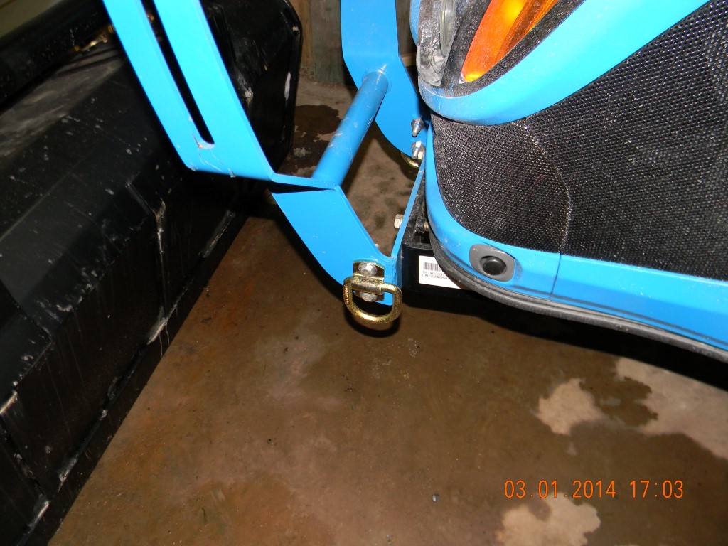

I used bolt on D-rings up front and a twisted clevis on the back of my 3037.

/ XR3037C front tie downs....
George, When you torque down on them watch the frame tweak. I transport mine every day and i didn't like that idea.......

My biggest concern was the rough roads i travel and the stress caused when the trailer twists and flexes. The tiedowns i installed are directly over the axle in the double frame area. I was able to flex mine with a 3/8 chain binder and no cheater pipe.....

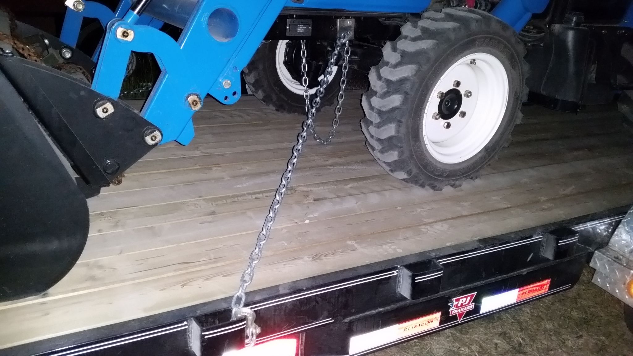

Got to use them tonight and they work great............
