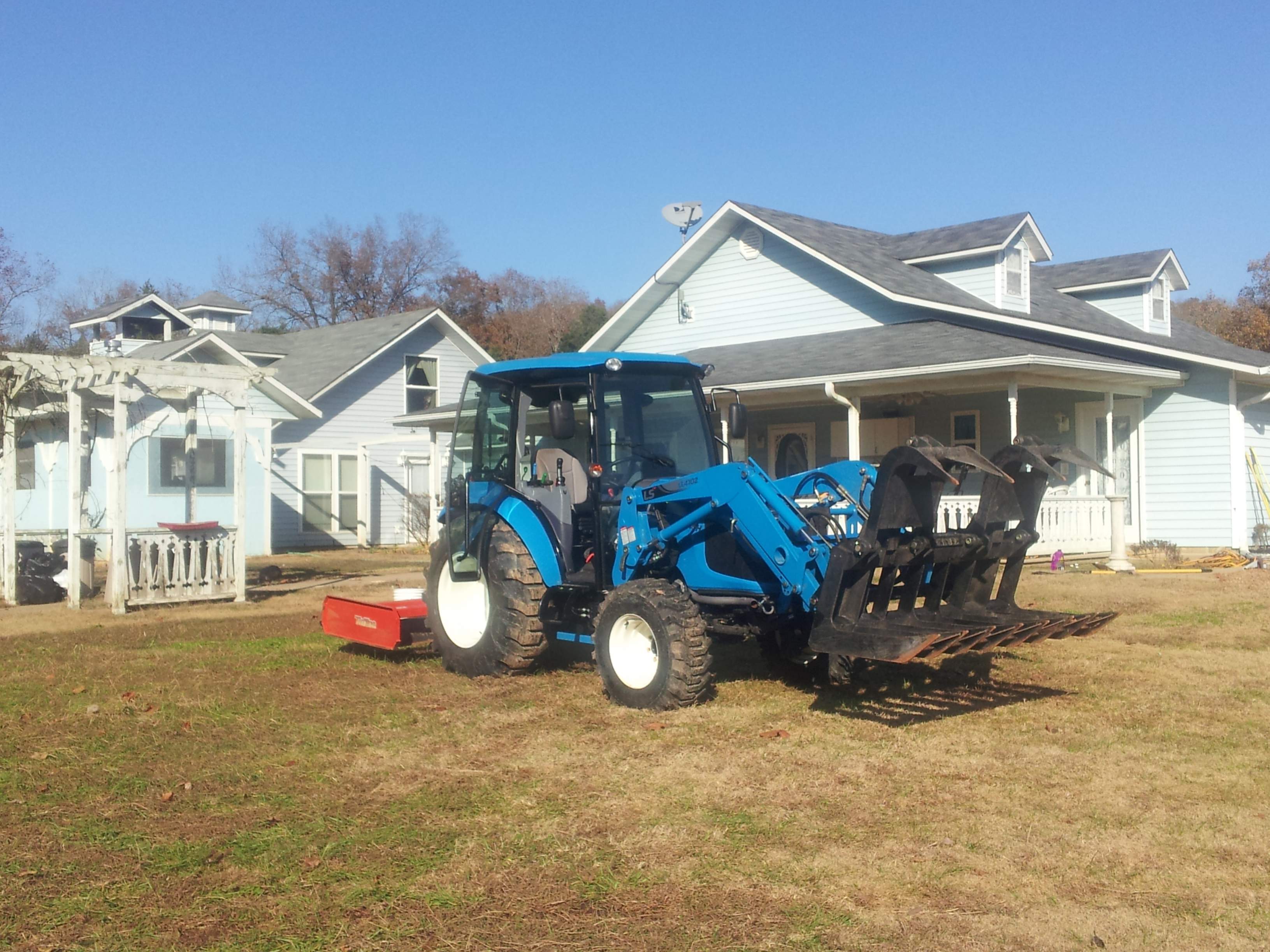

20131117_140029.jpgmy tractor with grapple, it just makes clearing brush a breeze.

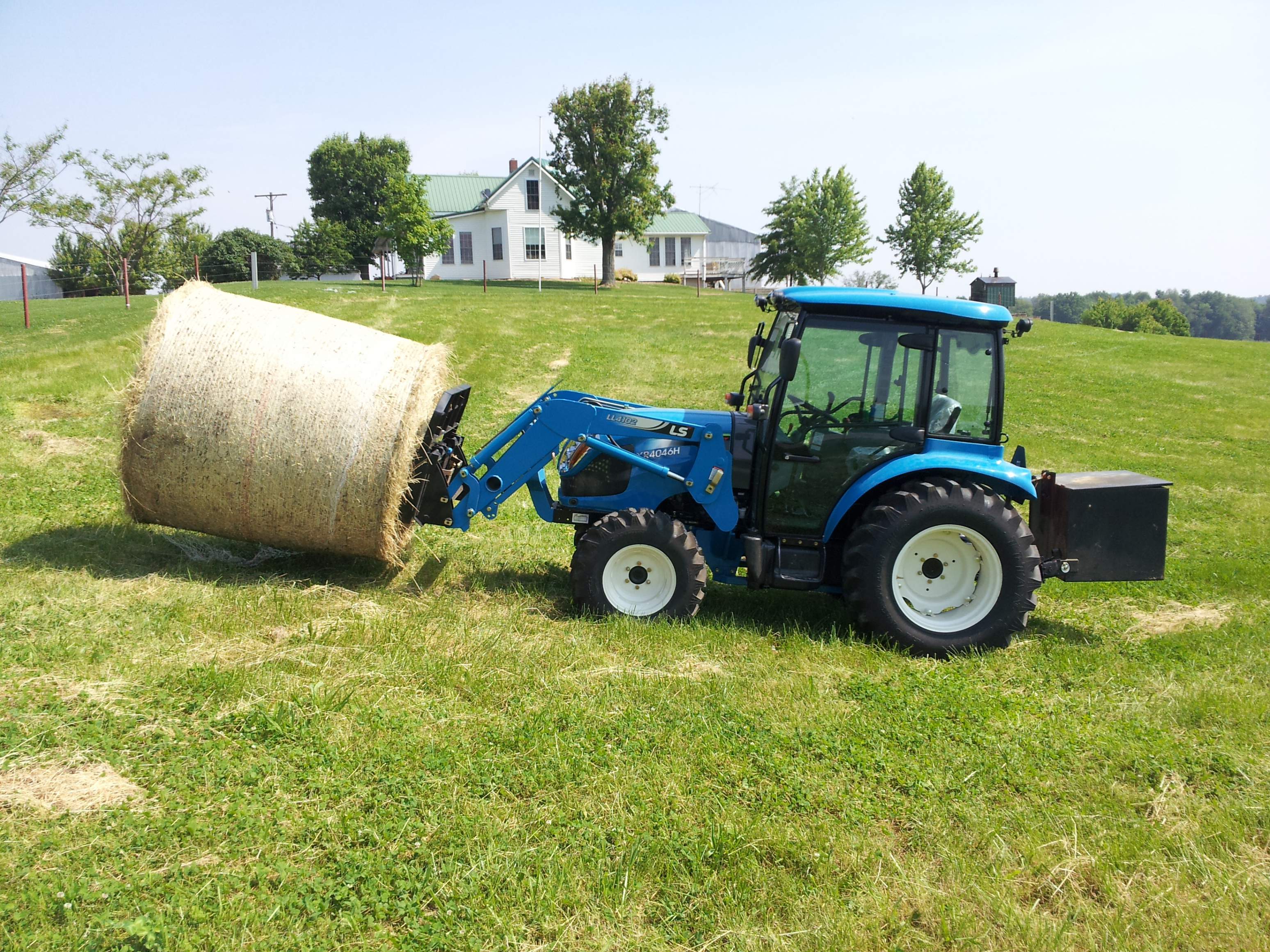

Yes it will handle big round bales easily. It's a good idea to have counterweight on the back when moving them. I think hydro is about $1500 more than the gear model.

I also bought my grapple from palletforks.com and it has been a really versatile attachment. I also added a third remote kit and switch to my joystick so that it has the trigger right on it. I bought that from fit rite hydraulics and it is a first class setup. it took a while getting it all dialed in and setup and it wasn't cheap but it is so easy to switch attachments on the front and use the grapple to it's ability. I really use it all the time for stuff you wouldn't even think of. I drive around and pick up stuff so easy. Big Heavy Stuff! makes rearranging the yard a simple task.

Whispering Oak, does your tractor have the tier 3 or 4 exhaust? Was told by a case dealer that LS tractors run their exhaust back through the engine and it would cut the life in half. Case on the other hand doesn't do that ????????????
I talked to your favorite dealer this morning and a grapple from him is about 1950.00 plumbed in.
