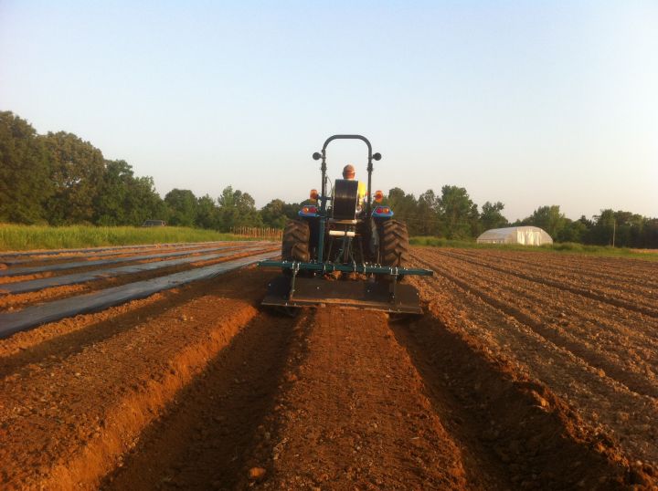

So I got the tractor back from the dealer Tuesday. The guys from Murphy Brothers Trading company in Boonville, MS did a great job getting this sorted and back quickly. I was able to get out prep some soil and make some beds before the rain.
