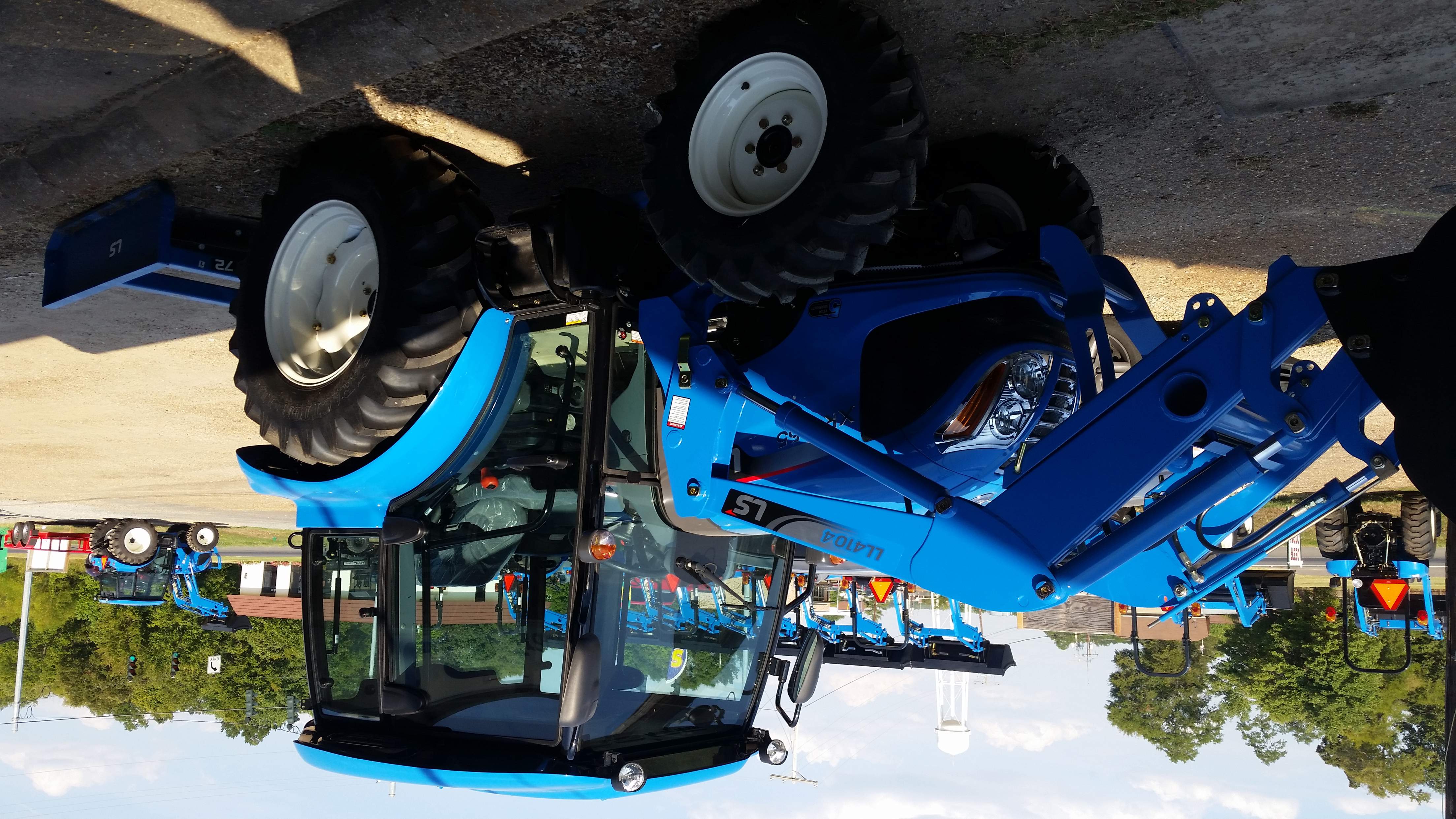

It's official I'm in the LS club haha! I got my new tractor home this evening and snapped a few pics before I got it dusty. I got to operate it about two hours, and it sure is nice in the AC and not huffing dirt! I went with the R1 tires and I plan to adjust the rears to the wider offset asap, and probably load them. I haven't found any info on break-in listed in the owners manual, is there a concensus on a procedure for a new tractor? Or just work it hard??

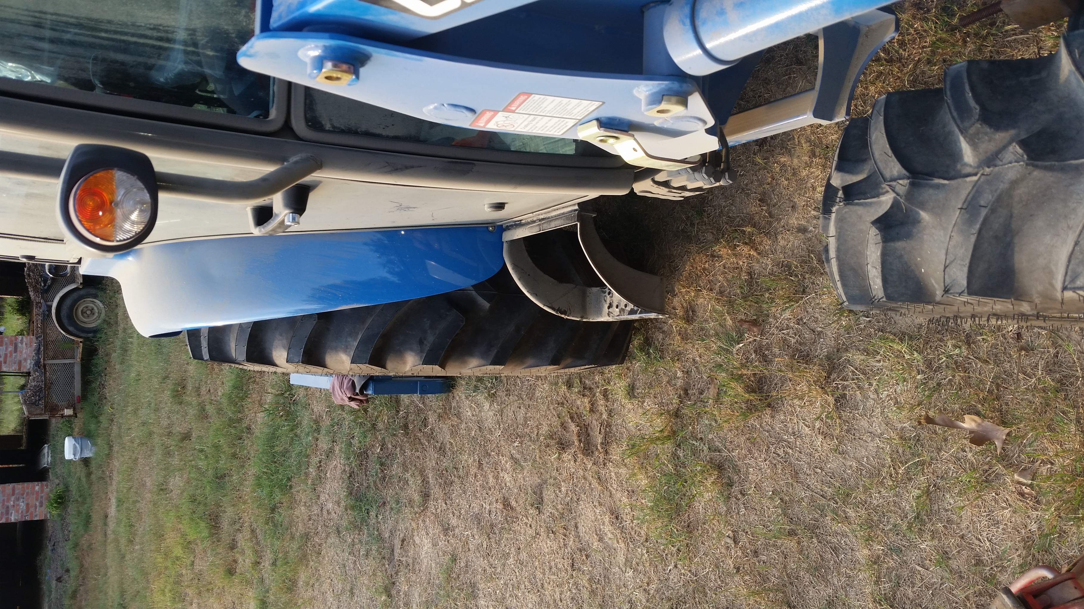

I just finished setting my rear wheels on the widest position and am in the process of filling them. Here's before and after tread width pics. 20150926_171829.jpg20150926_175906.jpg

Njksc, I believe only the Ag wheels are adjustable for wider track. They are a 2 piece wheel whereas the r4 wheels are one piece. In my first post above, the second picture shows the rear wheel with the outer rim and a separate inner wheel section with bolts holding the two together. By removing the wheel and unbolting the inner portion from the outer rim you can reposition the inner part about 3-4 inches inboard on the rim and gain the extra width. Not sure if that makes sense? Sorry I don't know the torque specs, I just beared down with a breaker bar.
